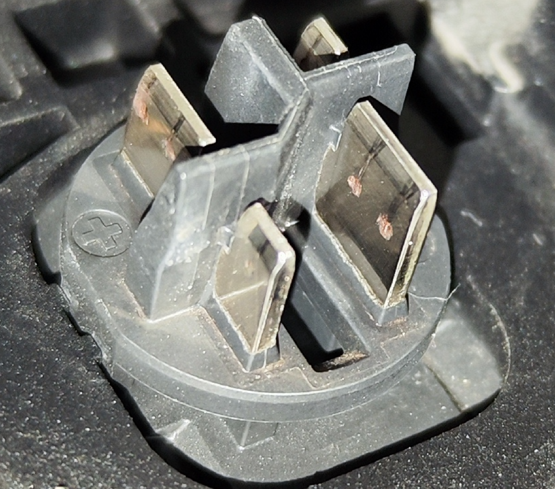

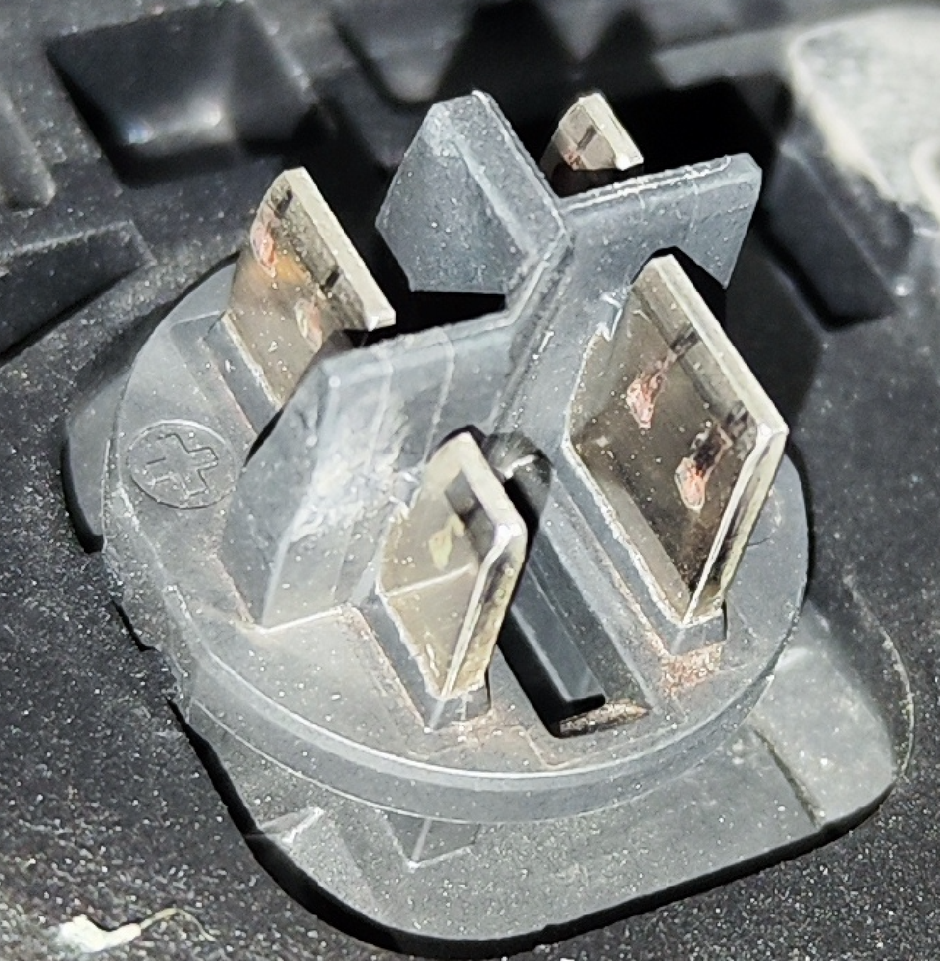

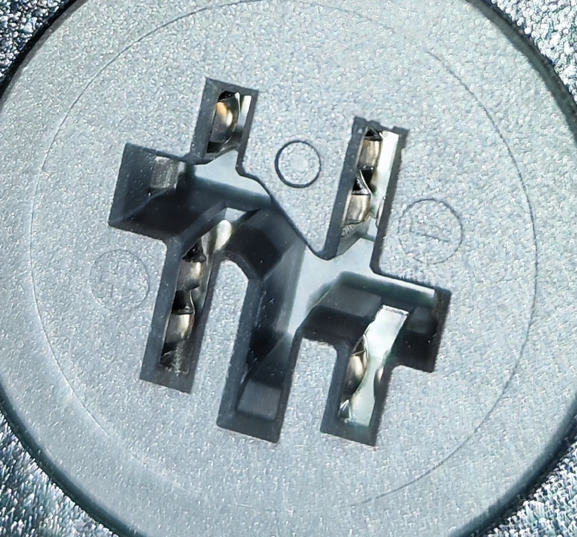

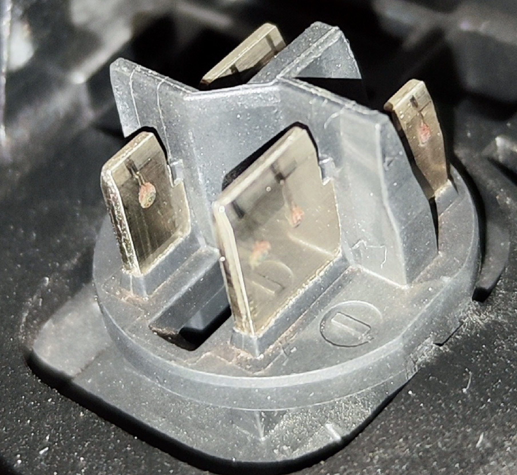

The bike is the Stereo Hybrid 140SLX. I bought this bike less than 4 weeks ago and I have experienced random shutoffs during riding, mostly when going uphill. When it shuts down the solution is just to remove the battery and put it back in and it works fine till the end of the ride. When it happens and come home I clean the contacts with a qtip and isopropyl alcohol. It then seems to work for about 70-100km and the cyle repeats. I also see the connector has some slight play in the battery tray, but I guess this is normal, not sure. The connectors seem pretty worn out for such a new bike.
Did anybody have the same issues and how you solved it? Or do you have any ideas how to clean the contacts properly for good?
Thanks for all suggestions.

Funnel, those connectors do look a little suspicious, could it be an over heating issue?
Though I thought the kiox would display an error code if this was the case?

No. There were no errors. Just intermittent twitching for a few seconds and then the motor and Kiox shut off. Also removing the Kiox and cleaning the contacts didn't help in any way.

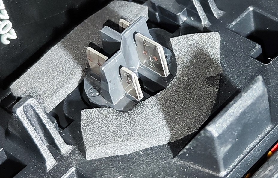

I cleaned the connector as good as possible with true contact cleaner and gently scraped of a little bit of black residue with tweezers on one side that wouldn't come off with just contact cleaner.
Then I put some neoprene self adhesive tape around the connector to prevent it from rattling mid driving and cause arcing. I didn't fully fix it and It still can move when removing the battery if needed.
I managed to do about 170km on various dusty and wet terrain and all seems good for now. Hopefully this was the solution.

I verified all the connections from the remote/kiox to the motor. All where plugged securely on both sides. My issue was definetly at the connector of the motor to the battery. I made about 300km now and all works without any issues. I won't remove the battery or touch anything as long as it works to see how long it lasts.

Just an update. After 2300km of rides the shut off happened once again. I recleaned the battery contacts and hopefully I manage to get another 2000+km without needing to do anything.
