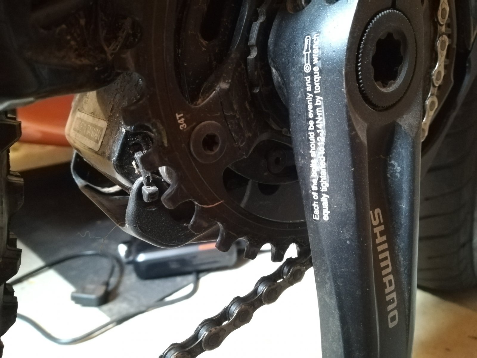

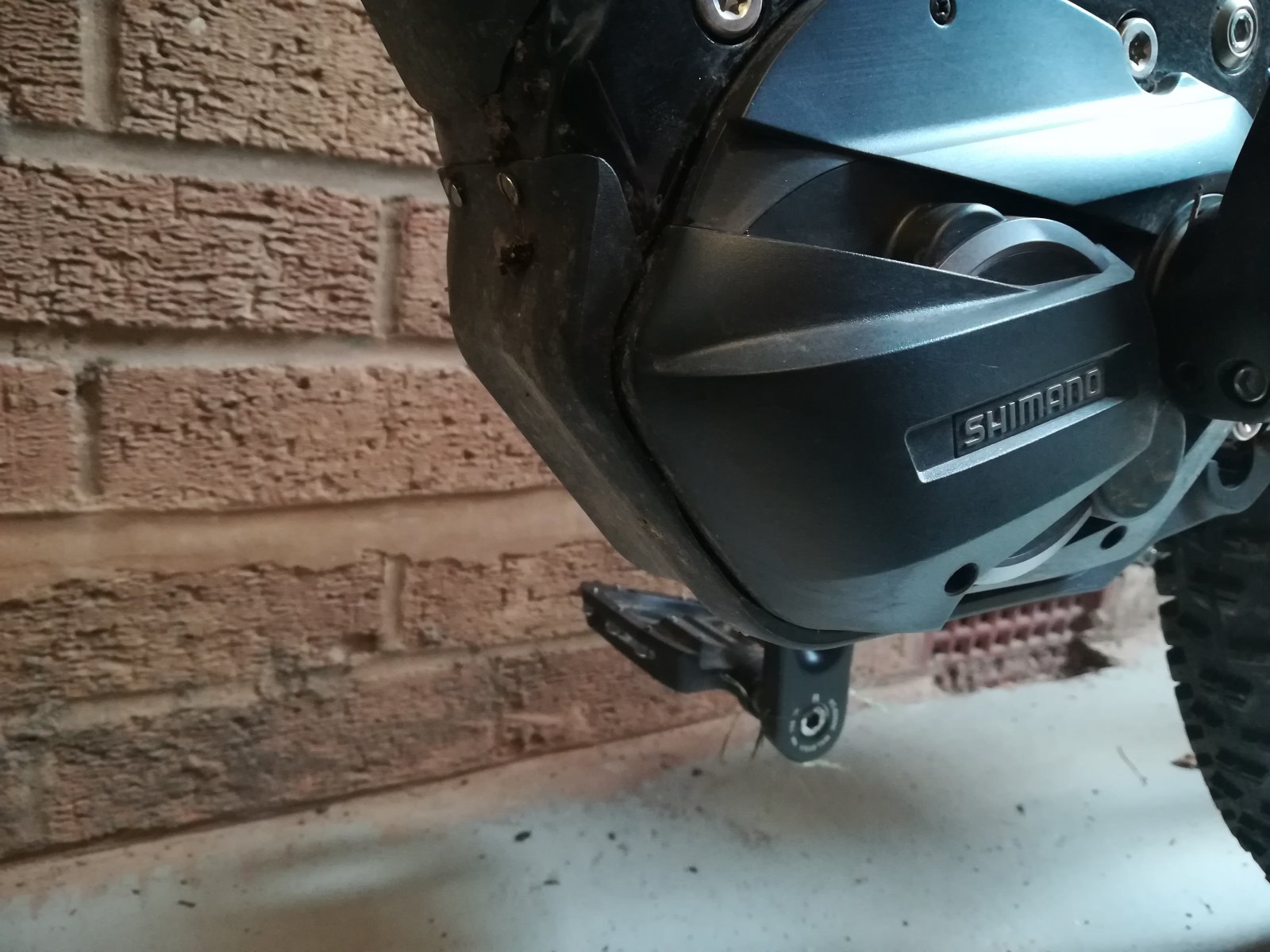

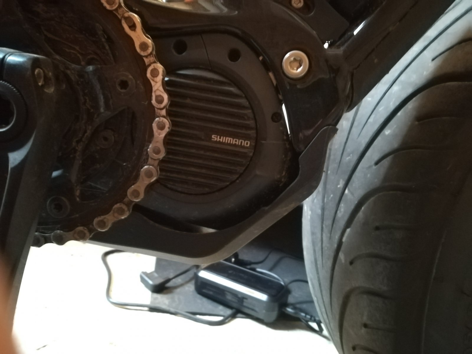

Hi, I went with the e8000 for mine. CRC say it doesn't fit and it really doesn't, but it's pretty close! I think with a bit of heat and stretching it could make it but would be a touching fit, more skid plate than bash guard. I decided to add some sticky foam for a little impact protection, the front bolted to the frame as normal, the rear I tie wrapped through the guard holes and up through the frame mounts. Reasonably neat when cinched up.

Hi,
Can you please post a picture of the result?
