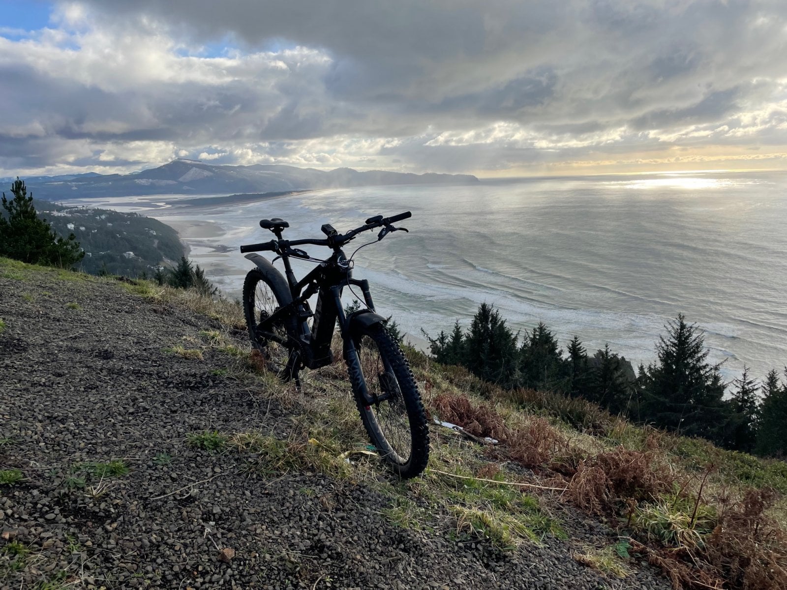

"If someone does not care much about legality - its still a grey area in some countries - then m620 is sweet option if used reasonably."
I live in an area of the US that is grey. The M620 is a next level of fun if speed thrills and the over 100nm torque on tap is league leading . You still need to apply force on the pedals but the fact that you can with a decent torque assist when programmed correctly keeps it real. I am able to ride on private land with miles of gated off gravel logging roads and at speed it's pretty much fun. But while on shared use single track I can keep the pace mellow easily depending on sight lines and traffic. Not my first eBike so I know how the other half (99%?) live.
The dual battery option listed above is kind of real if you plan on being in higher assist modes though. I ride with a friend that has a 2021 Giant with the 720wh battery and riding pretty much side by side we use close to the same wh/mi. However if he's not on the ride consumption is much higher as well as the speed. Overall weight plays a factor for sure also but I really only feel it at under 1 mph. At speed it is a very planted ride.
Along with the ability to run a throttle and how draconian the EU laws are and how the other manufacturers are playing the 250w game it is anybodies guess how this is all going to turn out. Especially now that VanMoof and BMW are promoting a high speed/geo fencing system bicycle that currently has no legal rights to public land but seem like they are going to push for it?
But if any legislation ever passes the M620 would make a good candidate for the motor with a BA battery system as it can be capable of such an average speed, at least on flat ground.

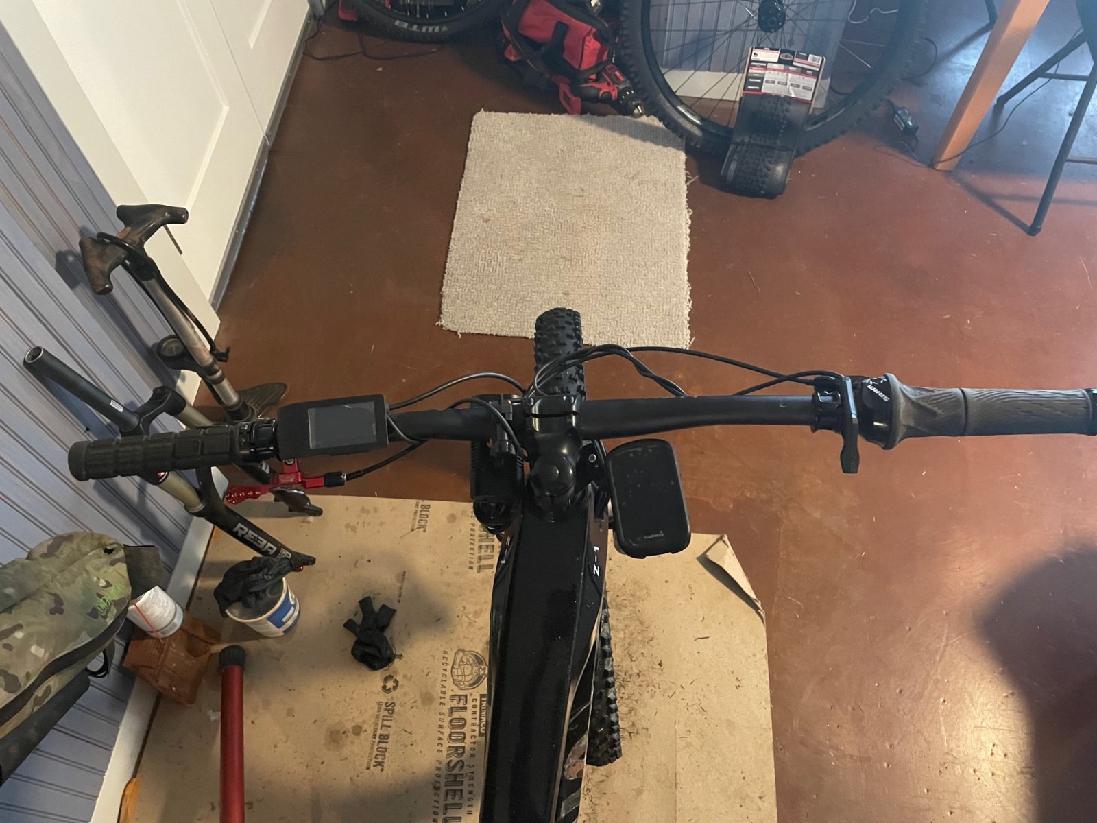

I do have a throttle and in fact wouldn't own an eBike without one and why I use the Bafang motor. I only use it for starting out and as a walk assist however. If someone chooses an eBike with a throttle and then doesn't pedal at all it bothers me but they are the ones that are missing out on the best part of the trip.
