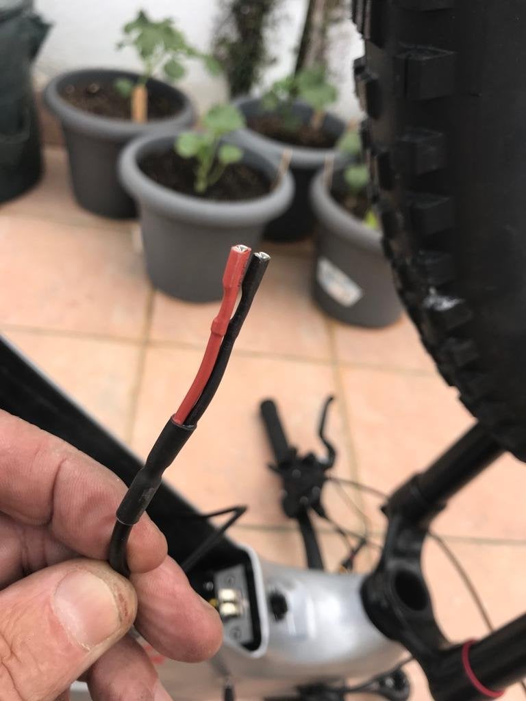

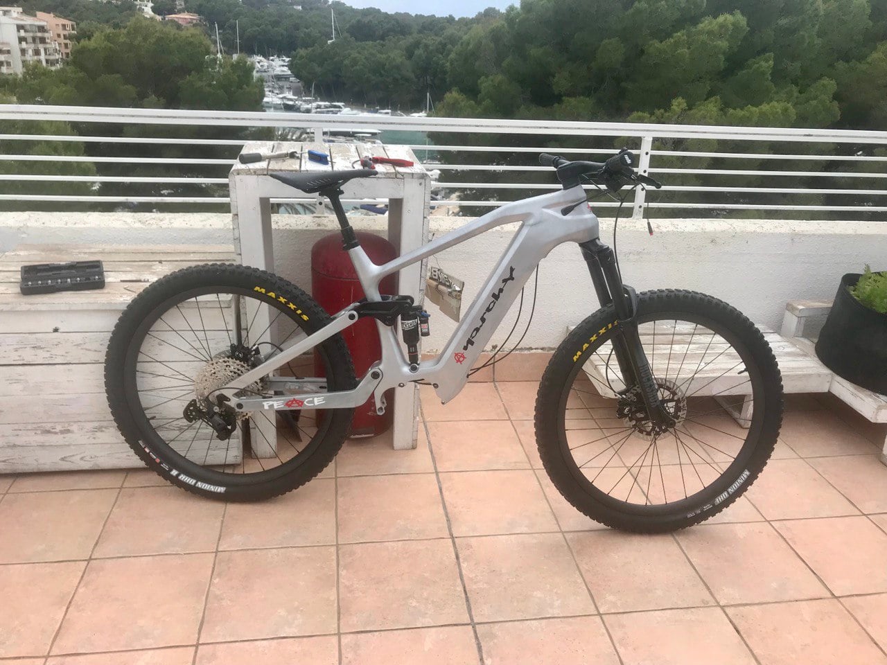

I am looking for some advice on my new DIY eMTB build. I completed the build yesterday on a Chinese carbon frame (from Joybikes) - They did have to re-send me a new frame as the first one was damaged slightly on the headset, It had gotten squashed in transit, I managed to fix it with my Dremel, but I wasn't prepared to accept it.. and they immediately sent me another with no hassles! So, I have ran into a problem that the pedal assist does not go atall, I think I got all the wiring correct, the controller lights up and all works fine.. but there is just no juice to the pedals! I have stripped it and re-checked the wiring.. but it all seems fine (and why would the controller all light up and work if it wasn't?) The only thing was the cable from the controller had a red&black spur off it that had 2 metal female ends on them.. I have no idea if they were to be inserted somewhere? so, this is what it could be? but I couldn't see anywhere these could be inserted.. not on the motor..I have the yellow battery one inserted and like I say, the controller comes on and is totally fine... I am putting up some photos... and hopefully someone can tell me what I'm doing wrong? This is my first eMTB build.... so any help is appreciated.

Those red/black connectors coming off the control/display cable are to supply a 6V front-light that can be controlled by the C240/241 display (long press the ‘plus’ button on the C241’s attached keypad). You can also get a triple-ended cable that attaches to an optional throttle.

UPDATE - So, the Torque sensor is broken!!! I cannot believe this.. first after months waiting on my frame, it arrived damaged! So then I had to wait another 7 weeks for a replacement!! and that one had slight damage I was able to fix! and now I find out the brand new motor is broken also!! I told supplier I was not accepting them sending me only a new torque sensor, as I don't think I should be opening up and brand new product I paid for!! They told me to send this motor back to them in China and they will send a replacement, But I said only at their postage cost!! This company makes it out as if it's my fault! haha...to be fair, so far they have replaced, but it's the cheek of them saying they have never had this and making out as if it's me!! I sprayed and assembled this whole bike in 2 days!! Everything is perfect except the Bafang M510 motor!! I first ordered this in December.. it is almost June!! NEVER AGAIN!! to me, it's not worth the hassles... I wish we had just purchased an off the shelf eMTB...or better still.. never even bothered with eMTB's!!! haha.. I am mainly a road cyclist.. and a good one at that! I am road and mtb guide on Mallorca.. I just thought that me having an eMTB would help me as I am getting old and when I mainly guide on road bike.. I do a fair bit of MTB guiding.. and it was knackering me up.. no matter how fit I am! So... I wish I'd just stayed knackered!! ha! I shall do a full post on this company once it's all over... as I reckon there is more problems coming.. for me to even remove the existing motor was difficult.. the left hand pedal locknut had rounded off!! I tried to drill it out.. but nope.. and I didn't want to cause any more damage to this motor...so I left the left hand pedal on! and told them to re-send me that also! It's not just this.. it's all the hassle of boxing it up... then having to organise postage... Nah!! NEVER AGAIN!! I must say, I have ordered many road bike frames from factories in China without a single hitch!! all been great!! and fantastic bikes!! I wasn't sure about this company at start.... but hey, I cannot say too much as so far they have replaced damaged frame.. and say they will replace this... but it;s the hassles of going back n forth.. making video evidence etc etc... JUST GIVE ME A FLECKN FRAME AND MOTOR THAT IS BRAND NEW AND WORKING... Like I paid for... It really is that simple.. eh?
