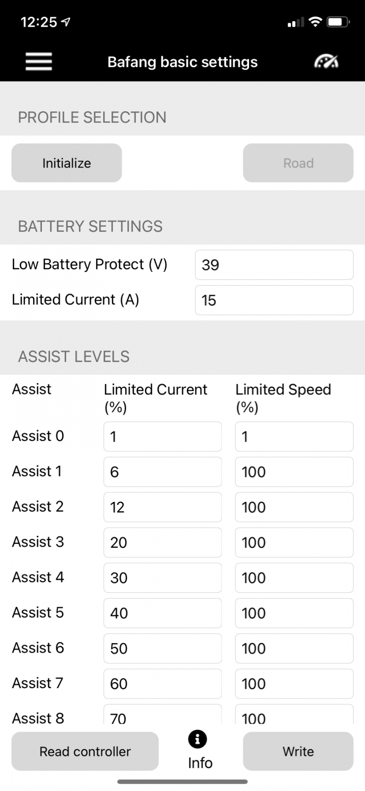

And lastly - I have my set my controller to cut off at 39V.

Whilst I appreciate that you've been descriptive in your post, could you kindly post a screenshot of your parameters of your levels of assist for consideration?
Running the maximum current at 18amps is quite safe for that motor (hell, I've riders amend the maximum current to which they eventually run into problems).

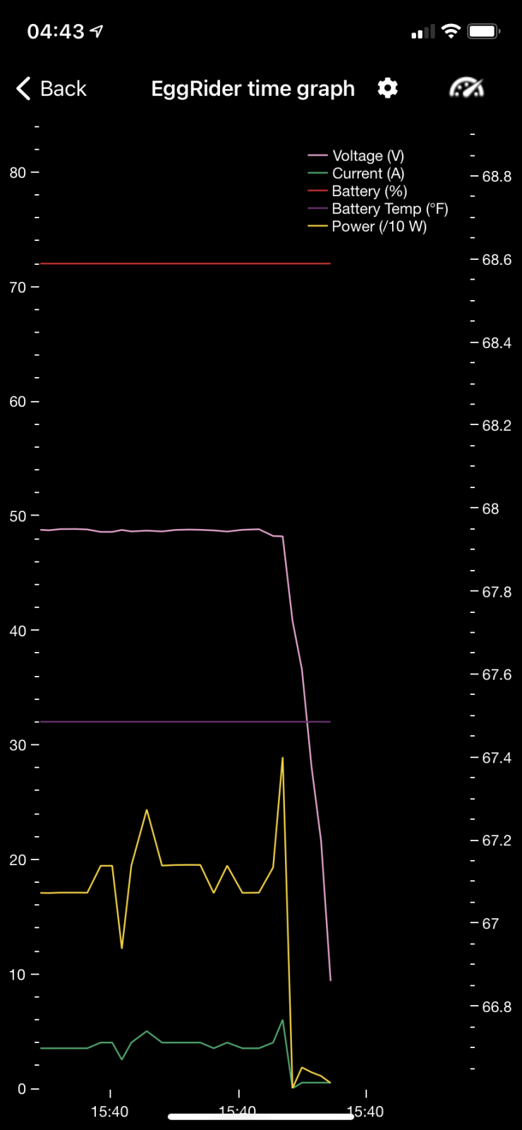

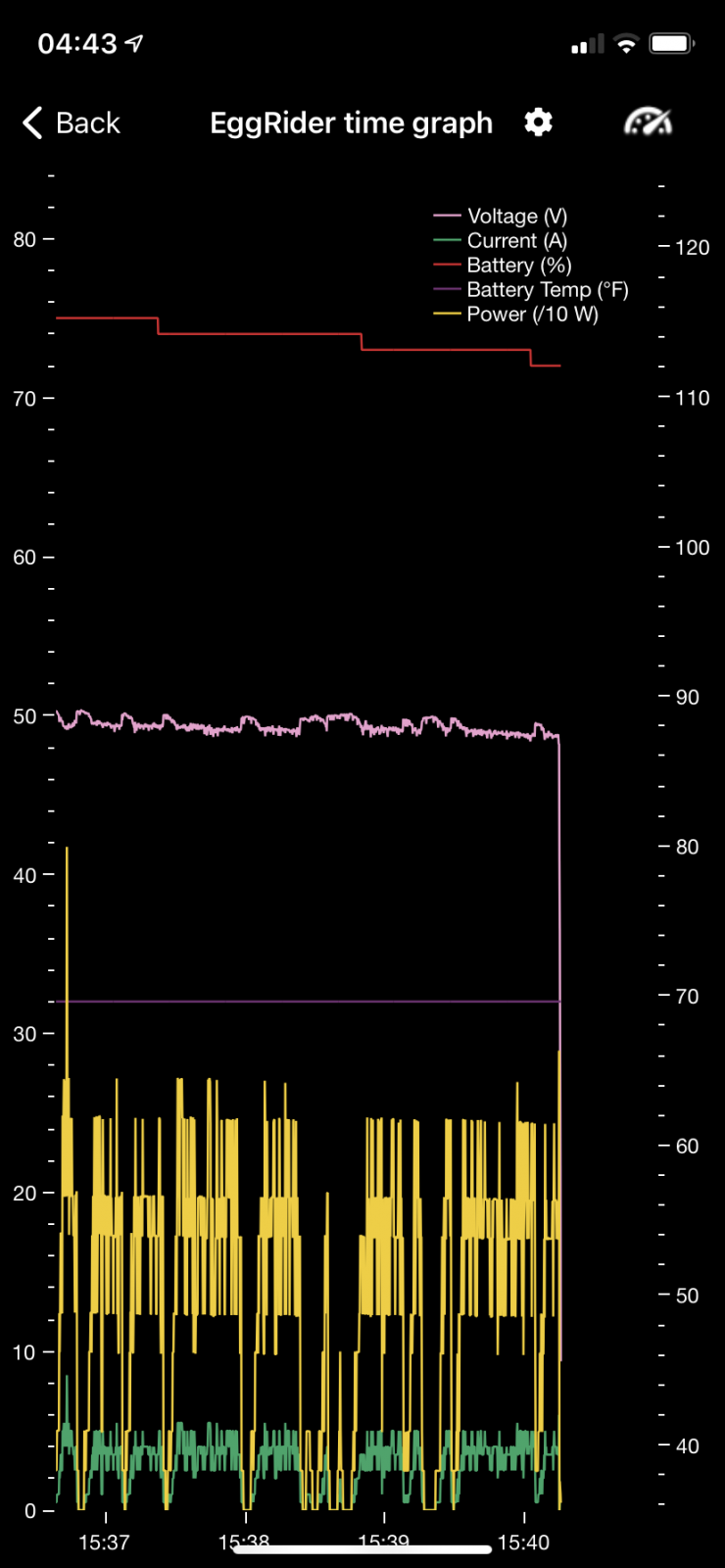

Here’s those screen shots. And yes, I may have to resign myself to purchasing new batteries, but it is baffling that it is happening to both of my batteries. At the time of this shut down I had the controller limited to 15.

That battery is failing at approximately 5.7 amps. The other battery is doing the same. One could almost eliminate the batteries.
My guess is you may want to check your electrical connections between motor and battery, even though they may look good, if they are of poor contact they will heat up until failing from the poor contact. You unplug the battery and reset the system, the contact is now working again and voila you have a working motor until you pull 300w’s again.

Let's look at the (great) data you collected:
1 - In the first dataset, your pack voltage drops out completely after a relatively short, mild rise in load current (from 4 to 6 amps). The pack voltage droops about 250mV as the load increases and then the voltage crashes.
To me, if this data is correct, the data shows that the pack (really the BMS) is the culprit. The BMS has shut down (for whatever reason). If the motor controller was the one that cut out, the supply voltage would have spiked up as the controller FETs all turned off (because no more load).
2 - The state of charge algorithm of your motor controller (Battery %) is a bit off for the Samsung 30Q cell. Your data shows that the SOC is ~72% when the pack voltage is about 49 volts. 49 / 13 = 3.77 volts per cell. At that voltage, the 30Q has about 57% capacity. So your "Battery %" display is optimistic.

Seraye
Sep 8, 2020
64
43
Portland
Hello, The mini-cube was purchased from a reputable U.S retailer that guaranteed the quality of the battery cells. I won't name the retailer, because I do believe they are honest people to work with, and I noticed that they no are no longer selling these mini-cubes. I bought two, and both had the same problem. I was new to DIY ebike kits at the time and had no idea what to look for. I would not know if these mini-cubes sold by reputable local dealers are the same as the mini-cubes sold by Alibaba, but I personally would never ever purchase any battery from Alibaba (or Amazon). I have since purchased two batteries from em3ev with smart BMS that balance the cells, and have had absolutely no problems with these batteries at about 2000 miles of use. As for your question regarding whether something came lose in your battery, I would have no idea if that would make a battery become unbalanced as I have very limited technical understanding of batteries.
