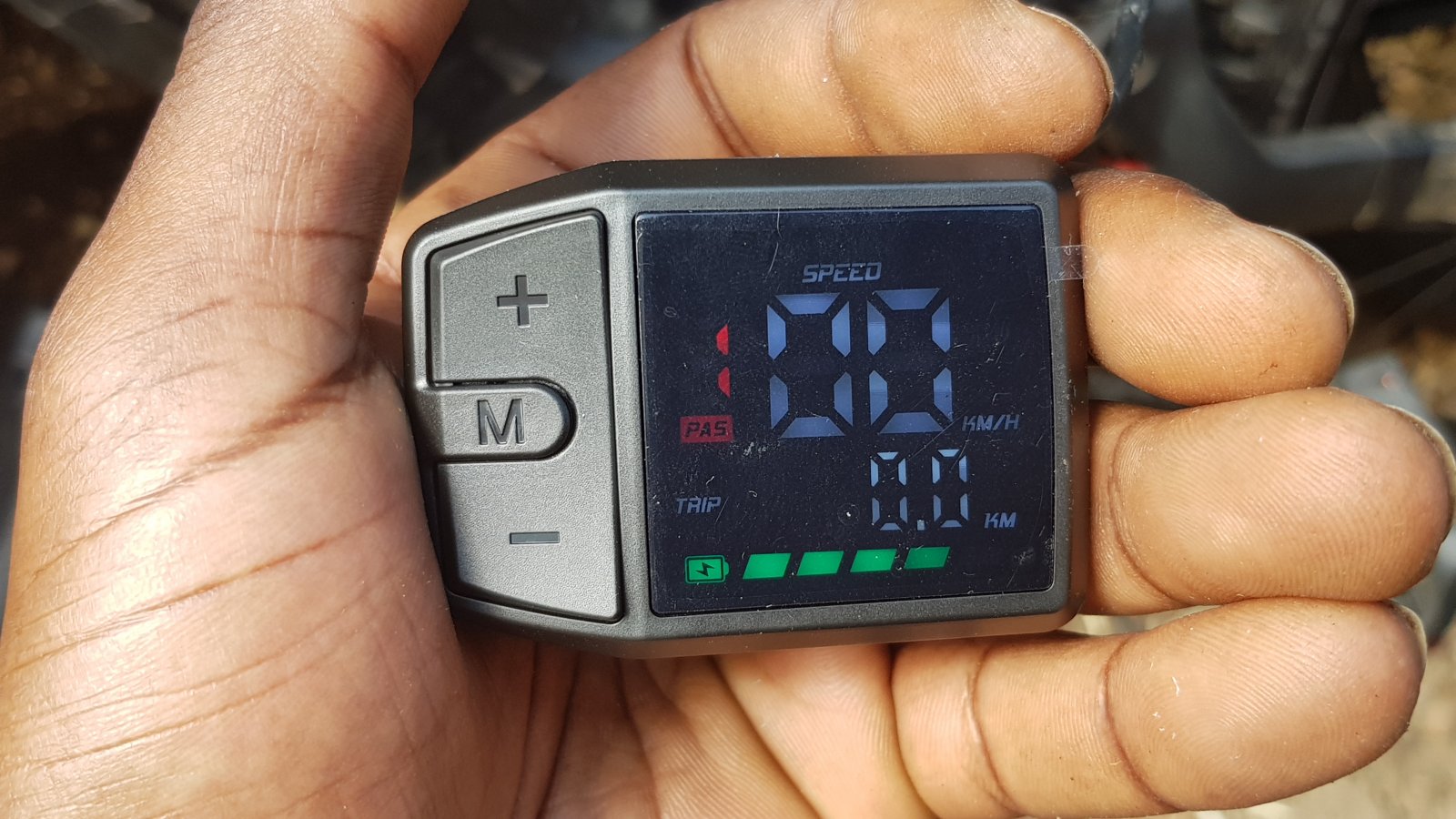

Hi everyone, I have for 5 years now an electrified stereo cube 120 HPA race 2017 with TSDZ engine, attending your forum I discovered the e10 Dengfu frame which I then ordered together with the bafang 510 engine to replace the cube. The frame should be shipped next week, in the meantime I am organizing to purchase the parts needed to complete the bike. So I need your help with some pointers. The first is the choice of display, I heard Victory Tech. and they told me that I can choose between the two displays DPC230 and DZ41, which one you recommend. The DZ41 certainly looks more aesthetically pleasing to me, but does it have the same functionality as the DPC?
thanks in advance for your answers.

I have the DPC230, which is easier to read than the previous DPC241. If I could choose, I’d get the DPC231 which has Bluetooth just in case Bafang update their Bafang Go app. to enable setting motor parameters. Hopefully that makes sense.

These displays shows exactly how out of touch Bafang are in the screen designs.
Either too big, too small, tiny information icons, or not accounting for different bar sizes. No tune ability in icon location.

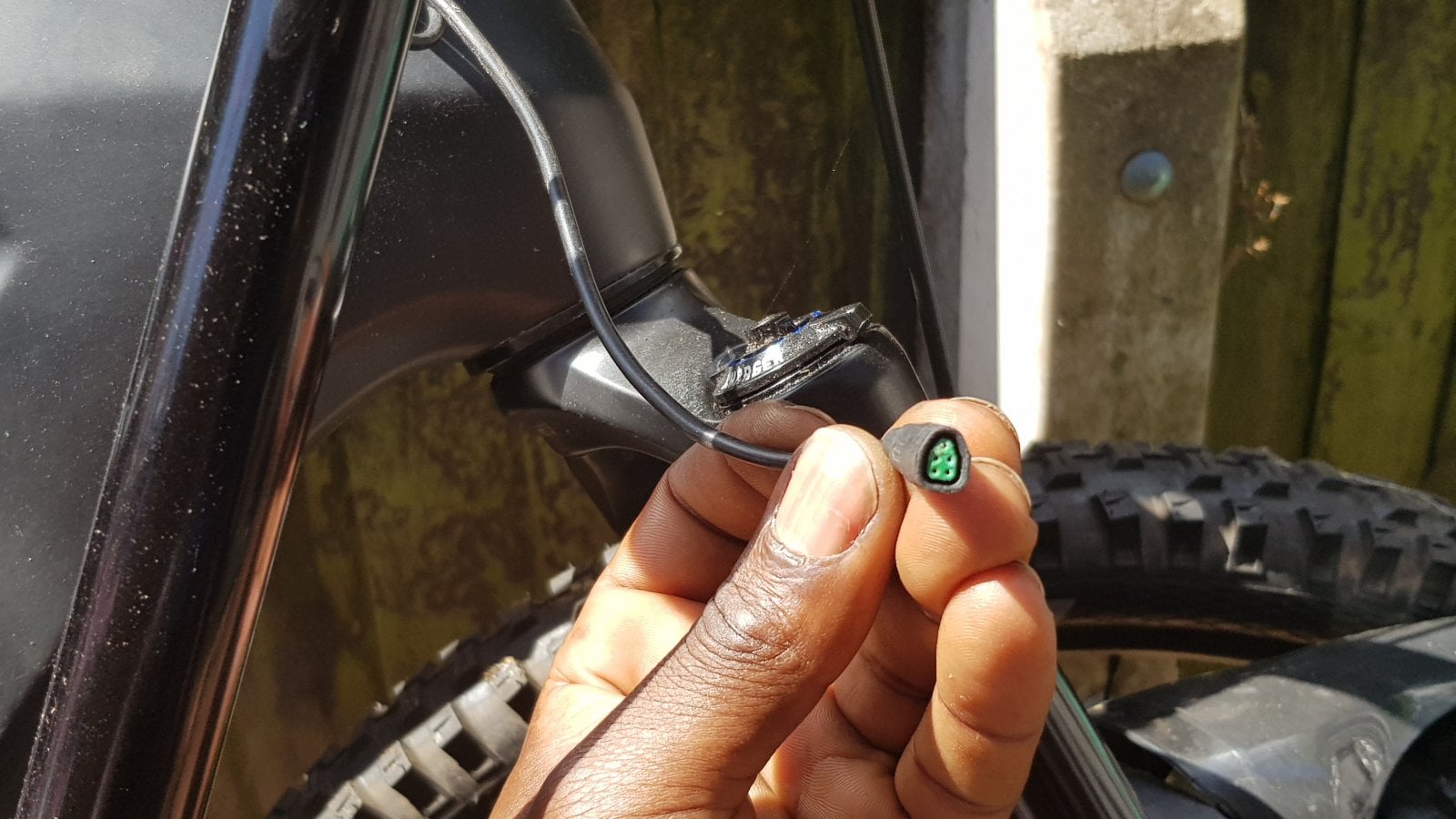

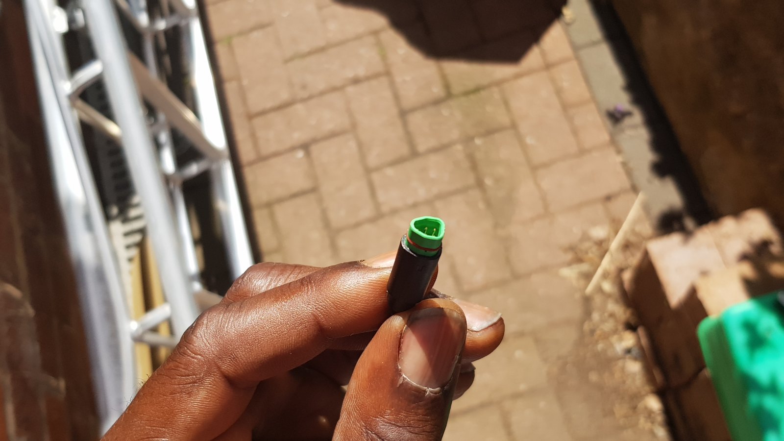

This may be of use to those who are looking for an alternative display CANBus protocol display.
Neeko DeVinchi
Dec 31, 2020
1,043
1,387
What cable did you use when you changed from the dcp241 to the dz41 Neeko
CANBus👍🏿
