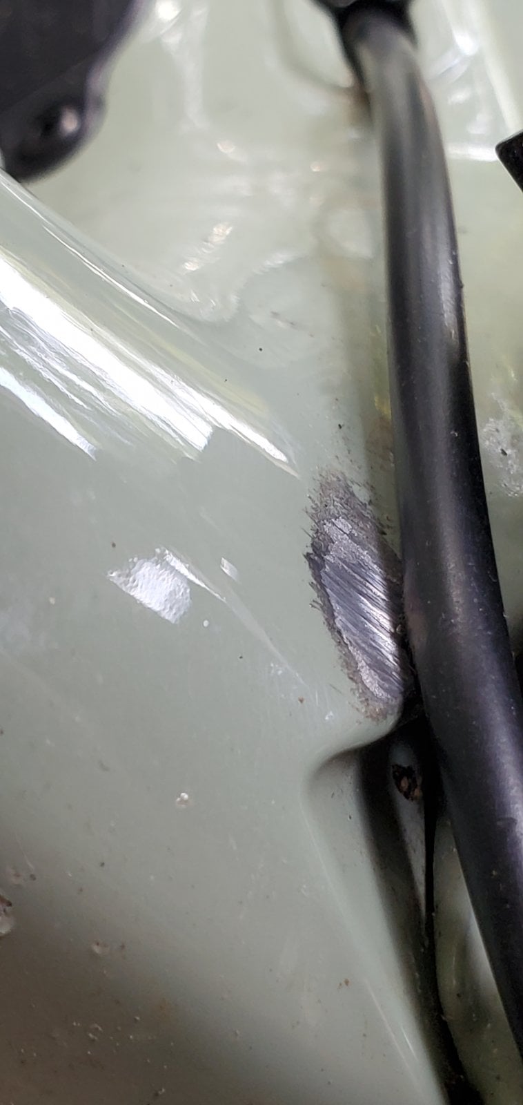

With 300ish miles on my Meta Power 29, my derallier cable is rubbing, pretty badly right above my BB, through the clear, the paint, and now into the actual aluminum.
I contacted Commencal USA, who replied very quickly but they (Romain) basically said out some clear protective film over it. Which will most likely need to be replaced every so often. Love the bike but this is pretty annoying.
Anyone else having this issue? Anything else besides clear protective film to help remedy this? TIA!

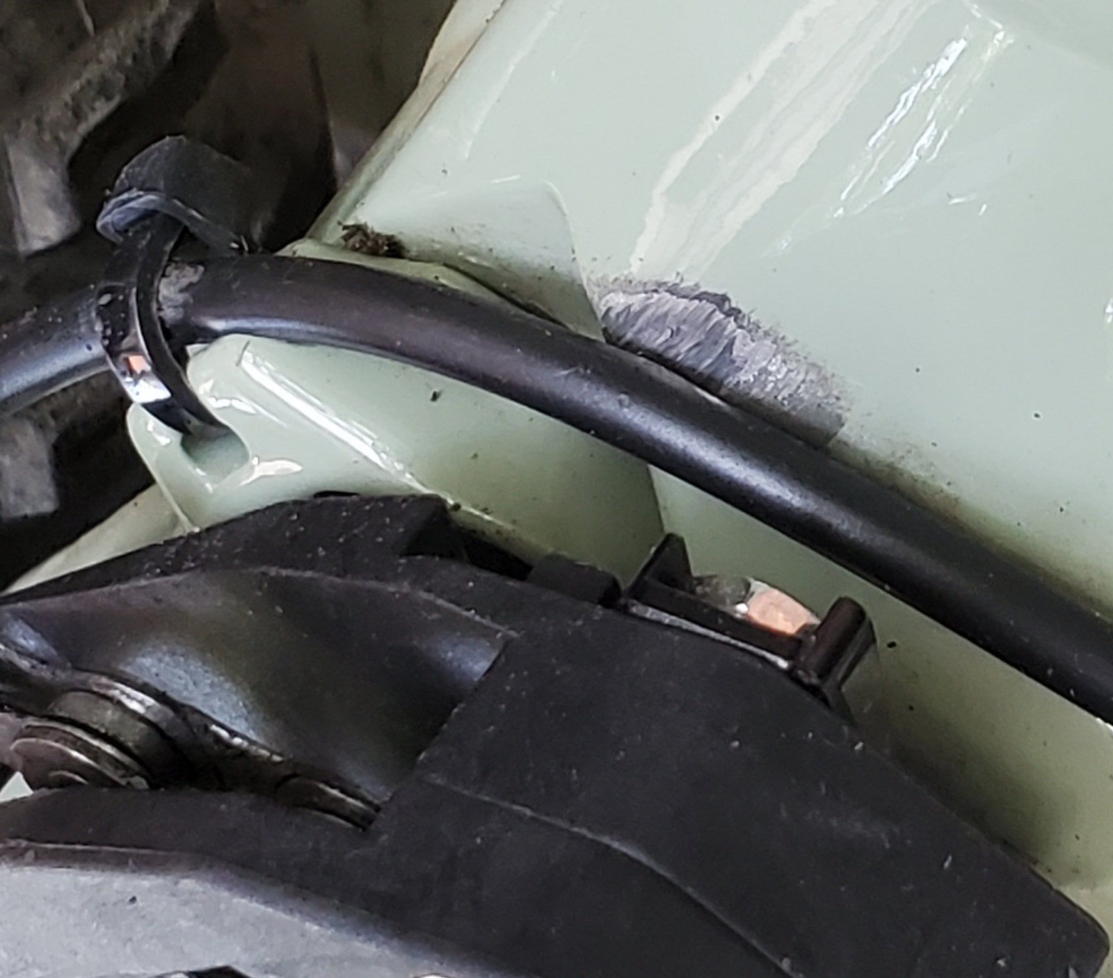

That is bad design, but what were you doing letting it get that bad!
You have options:
Reroute that cable
Use several layers of helicopter tape
Wrap some tape around the cable
Thread on a spirally wound cable protector (the sort used to gather bunches of cables)
Use combinations (advised as your problem is a bad one.
Paint the damaged area before taping it.

Thanks yeah I saw the rubbing happening a little while ago but also did 2 downhill days since then, totally my fault for not addressing it sooner, you're right.
I ordered some Foundation frame protection from Jenson USA, some rubber hose protector/grommets from Amazon, and got lucky and found a place to match touch up paint pretty close to me.
A friend of mine suggested it's a good reason to get wireless shifting, haha

I think like Steve says, I'd paint it, tape it, then I'd loosen the cable at the derailleur and possibly cut the zip tie (if it won't twist) and turn the sheath clockwise slightly so it turns away from the frame. At the moment the natural twist is pulling it towards the triangle. Then new zip tie and re-tighten (or pull back and re-seat). You should be able to set it up so even with compression movements it's not rubbing.

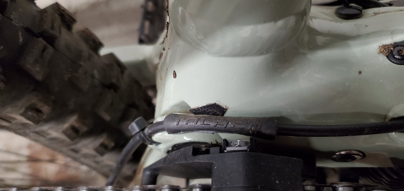

I found a local paint shop to match the paint code Commencal gave me, which ended up being too light a shade anyway. I touched up the spot with primer, then paint. I bought and cut some AMS frame protection kit, and also installed a rubber cable protector. I've been on one 10 mile ride, used most of the travel and it looks like the AMS patch I made shifted a but but it doesn't look like the severe rubbing is happening anymore. I'll probably re-do the patch, make it slightly larger, you can see a bit of dirt where I think it shifted.
