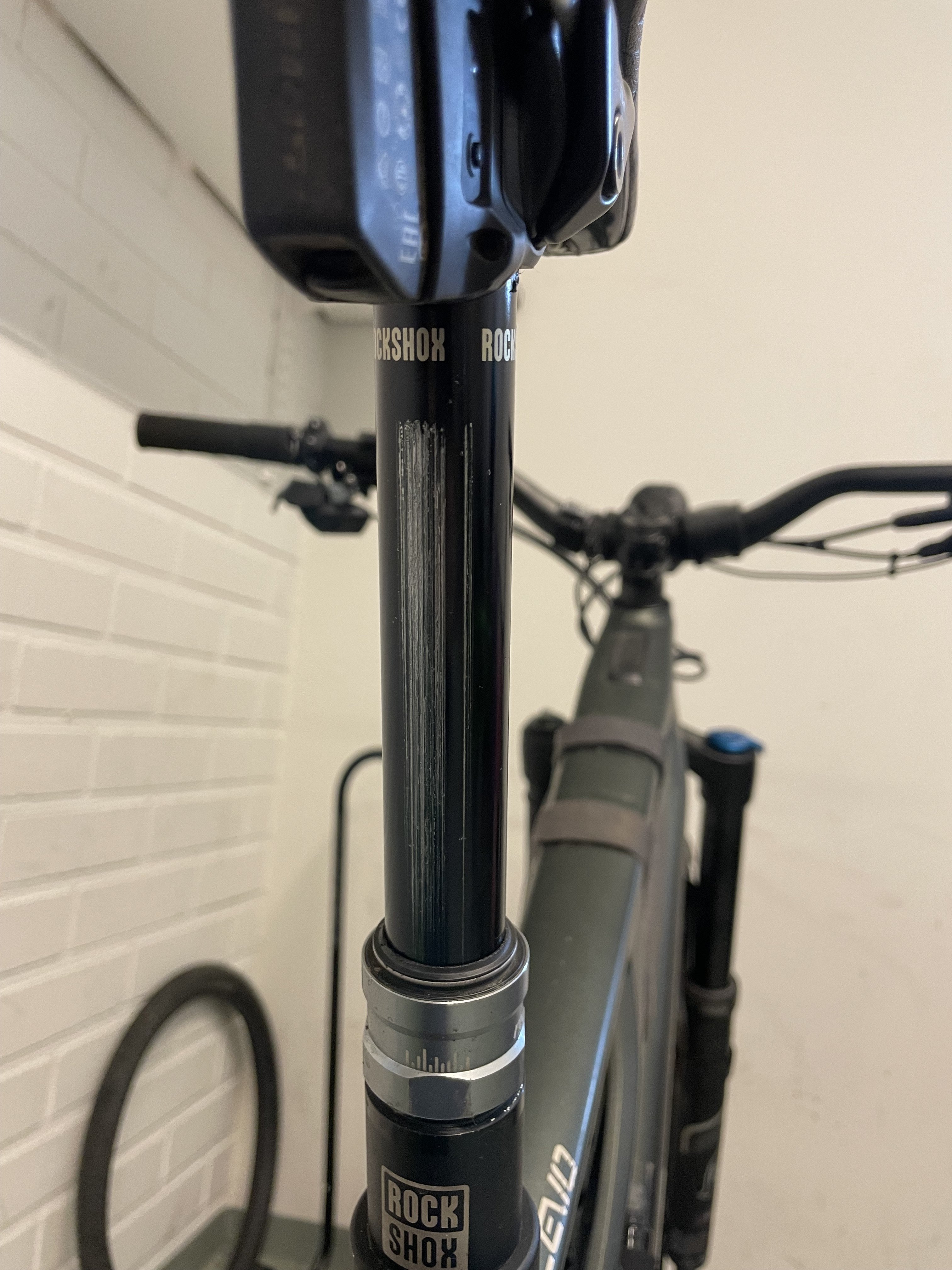

Yes. And those service kits are sometimes hard to find.
My AXS lasted about year. Now i have BrandX Ascend II, no problems and service free. It’s so cheap that you can buy new one if it fails. But these don’t fail what i have heard.
600€ AXS fails.
Edit: but AXS is very nice post when it works; fast operation, no play(Ascend II has fair amount of play).
And AXS works at -25 celsius same way as it works in summer. So works Ascend II also though.
But with 600euros you should get more quality.
