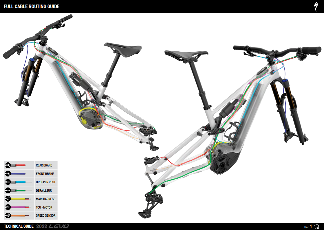

Has anyone rerouted the rear brake hose at the head tube so it enters on the right side,moto/UK style - front brake lever on the right and rear on the left. Sams Bikes on YT has, but no pics or vid of that part.

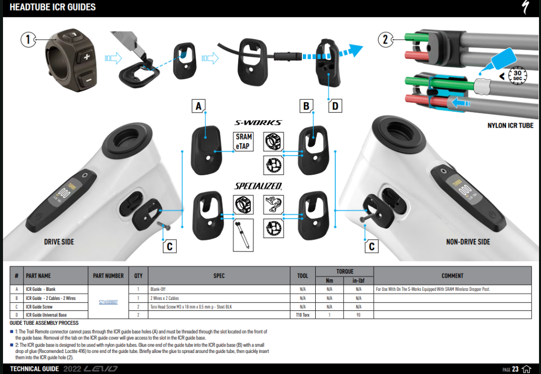

Regarding this, how easy is it to disconnect the nylon guides from the port covers? And should I remove the dropper cable guide?

You should be able to disconnect the hose at the lever and back it back into the frame. If you remove the TCU you can then redirect it to the other side.

The cable guide tubes are glued to the guide bases - might be diffuclt to switch
See more HERE

just remove the guide tubes, its what I did. cut them at the entry/exit point. It was a faff, but it is doable.

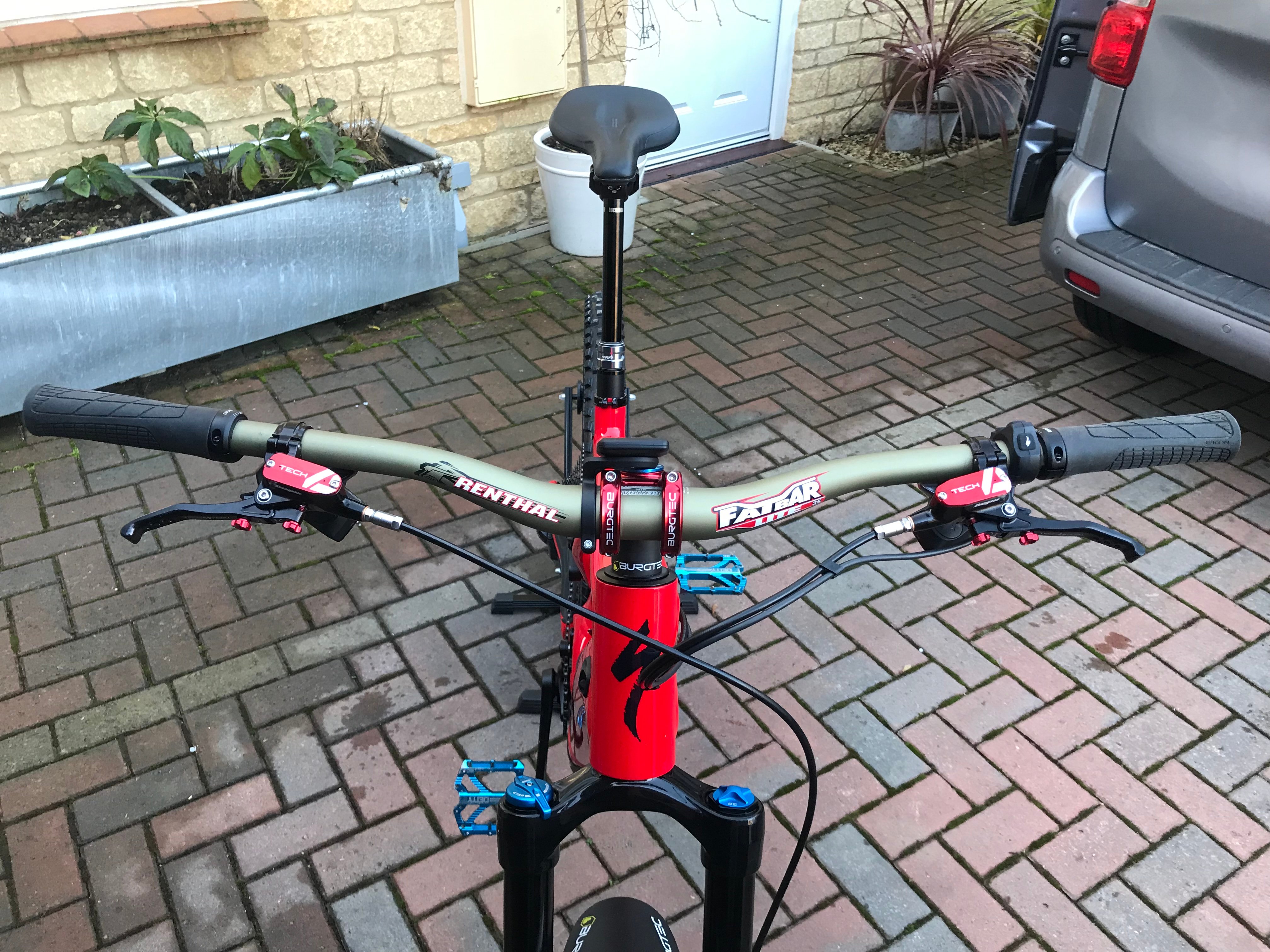

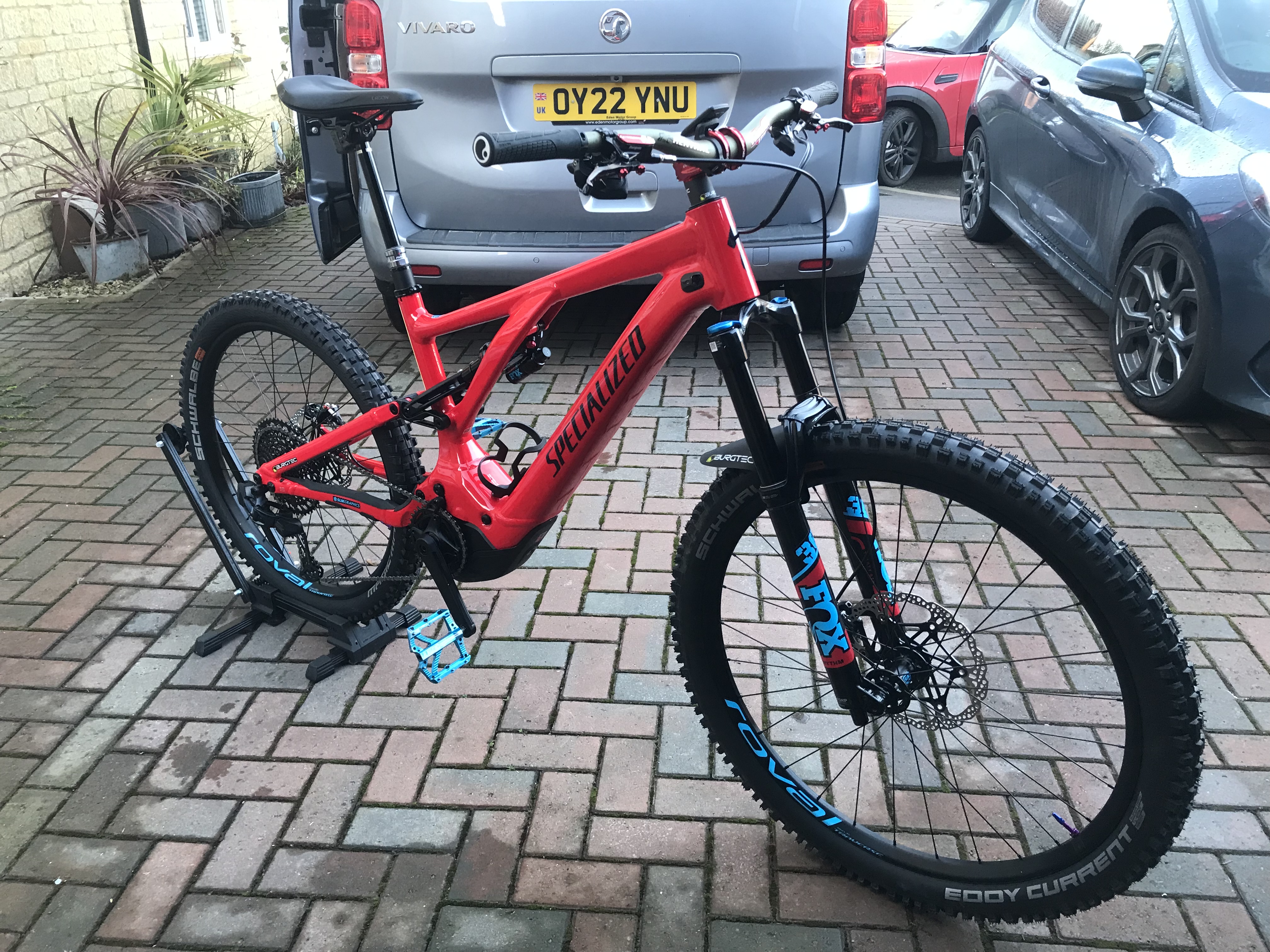

Hi , I’m 6ft 1 with an s5 frame and a 170 axs dropper, there will be plenty of adjust meant for your height , and yes the hose can be moved to the other side , think there is only about 2 inches of post stuck out the frame
