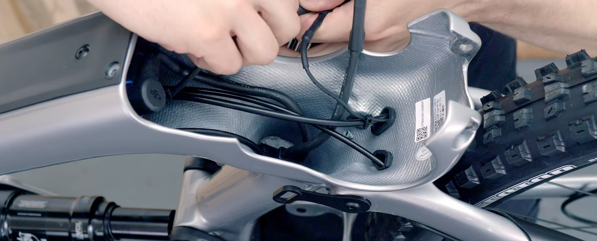

Cool. Looks like the display port is the way forward for my needs. My new bike (when it turns up) has the rear brake hose running down the top tube so there should be an opening I can use to get the cable in there.

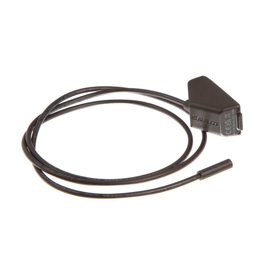

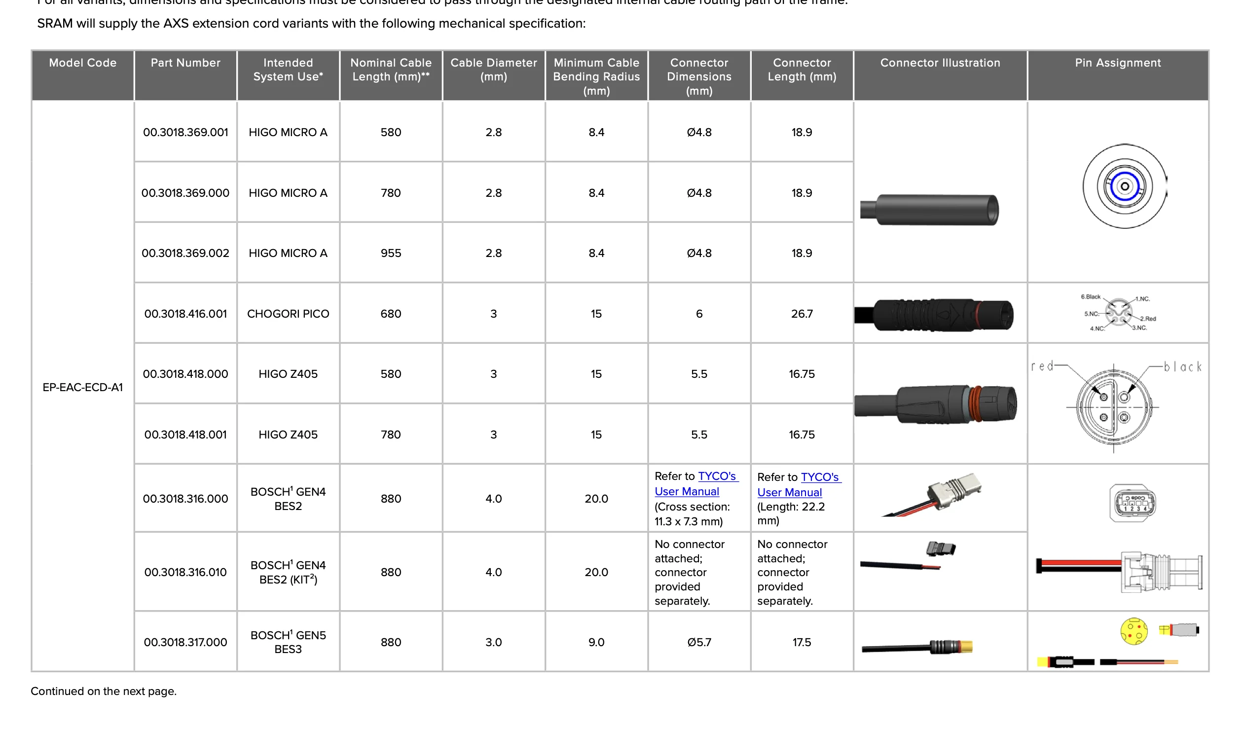

Does anyone know where I could get a replacement SRAM AXS Power cord for the Avinox M2S? (00.3018.418.001)(Higo Z405 connector).
I managed to botch my supplied one by not using the right tools 😒 I can't seem to find one online and I'd prefer to get it installed and out the way before resorting to batteries. I have since bought the "Parktool" .IR3 knockoff on Ali Express and it works really well - I managed to do it correctly with a dummy cable in 10 mins vs struggling and messing it up after 6 hours beforehand 🤦
I've reached outto Troyden at Crestline to see if he can assist as well.
Thanks in advance!
