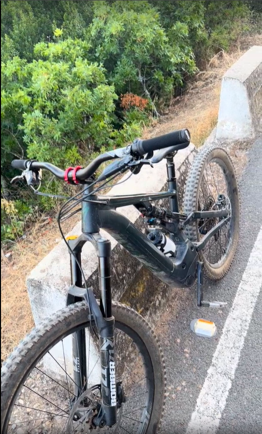

By the way, I also don't know how to style the bike, I feel like it currently looks very ugly and I'd like advice on that too. Maybe I should start with putting on invisiframe in matte rather than the cheap glossy film it currently has on. But I don't know how to proceed after that.
Current state:

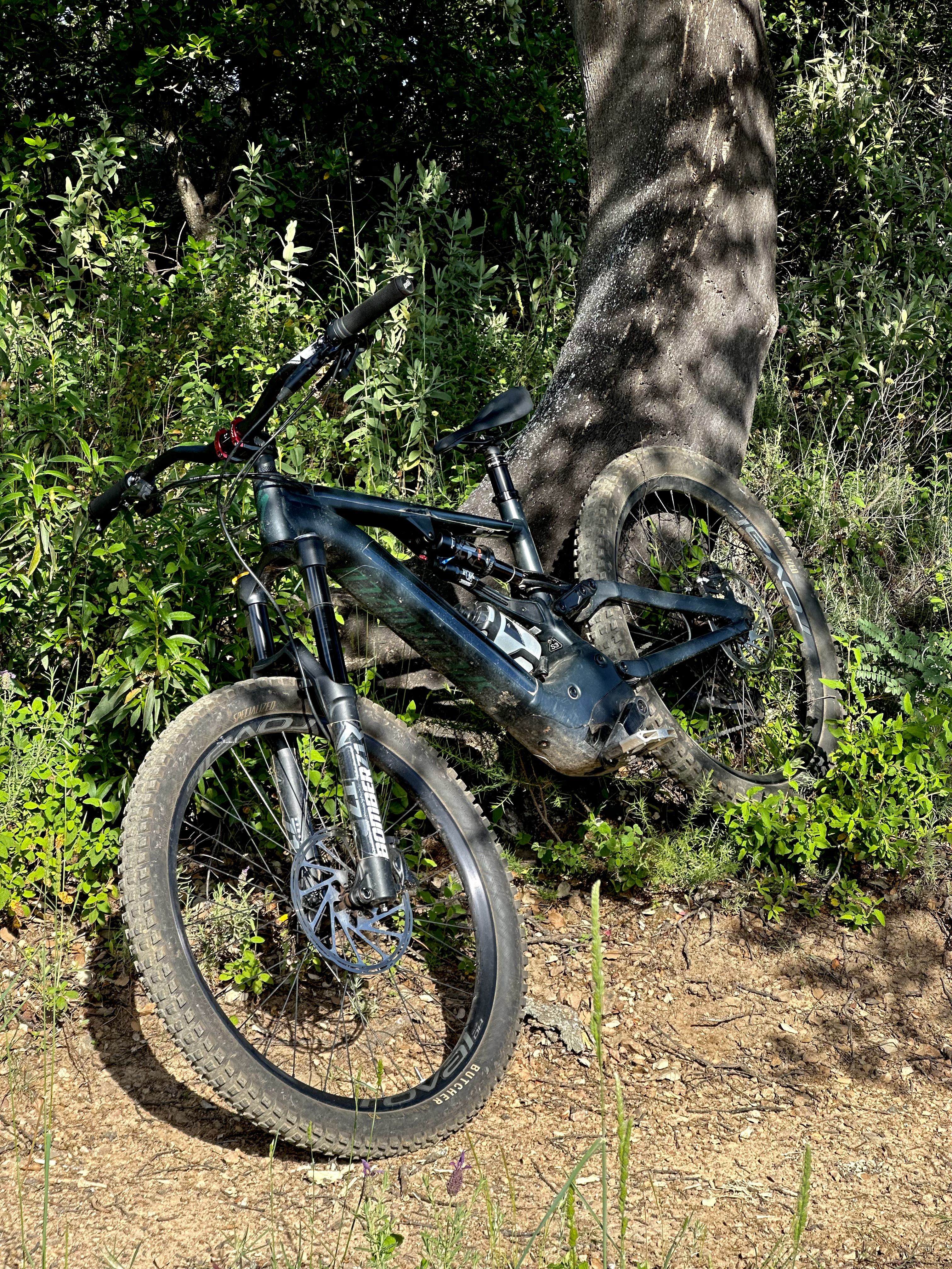

Current state:
