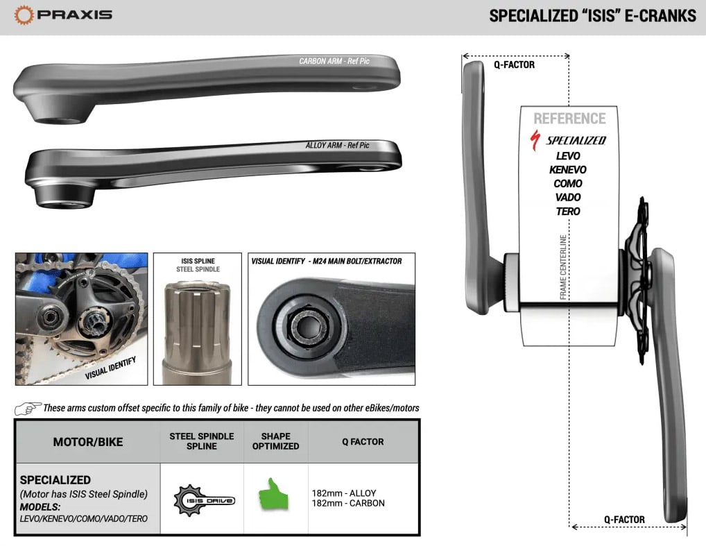

Levo Gen 3 Are these the right cranks for a gen3 Levo?

And does it matter what my front chainring is for crank compatibility? I'm installing a SRAM GX T-Type Eagle Transmission AXS Groupset soon, and I'm not sure if that's a factor for crank arms.
Would appreciate any help!

Yes. You'll want the Specialzed Offset version from Hope — it takes into account an offset that shifts the cranks approximately 4mm to to align with your frame centerline. Regarding your chainring (and spider), they are mounted independent of the cranks, so there should be no issue with Transmission compatibility.
