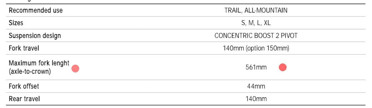

You don't mention the year of your Rise M20. For conversation purposes, let's assume it's a 2021/2022 Rise M20. Check the fork section of the "Rise Blue Paper" owners manual for the 2021/2022 Rise. The Blue Paper provides a maximum fork length to be installed on the Rise. The length is measured from the center of the axle to the top of the crown.
The Rise Carbon M series has a maximum Axle to Crown length of 561mm

Orbea specifies both a maximum travel (150mm) and Axle to Crown length (561mm) for a reason. As you increase fork travel, this places a higher stress load on the Rise's carbon fiber headtube. Exceeding the maximum Axle to Crown length, will likely exceed the frame's engineered stress load tolerances and you could potentially crack your frame if you take a hard hit. As for me, I subscribe to the "Ride it like you stole it" philosophy and figure the engineers probably built a little bit of a Fudge Factor into the frame.

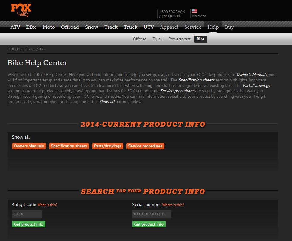

If you visit Fox's website and click on "Tech Help" under bicycles, you will open up the Bike Help Center and see a link for "Specification Sheets."

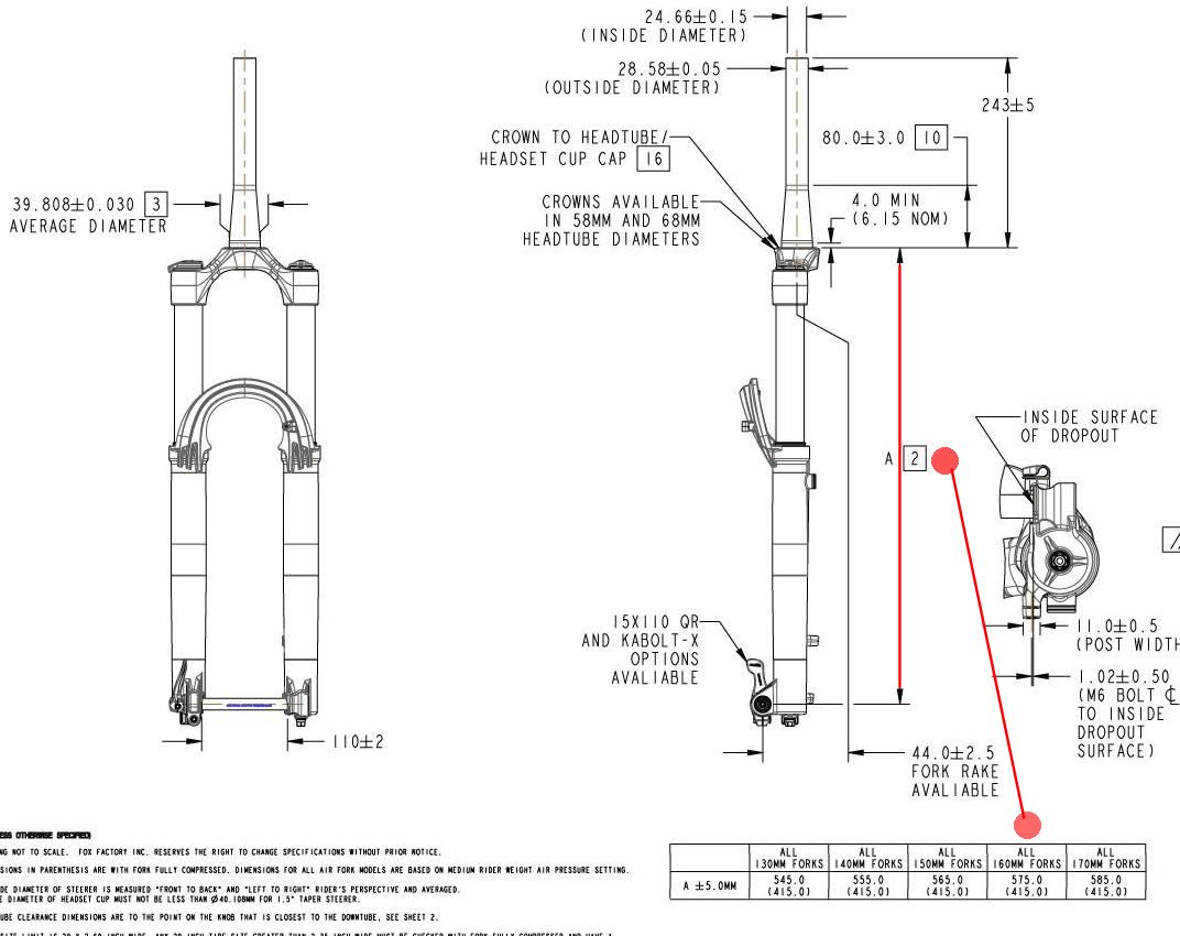

If you review the Fox specification sheet for the 2023 Fox Rhythm, 29" fork, 160mm travel, you will find it has an Axle to Crown measurement of 575mm, plus/minus 5mm in manufacturing tolerance. This places the fork outside of Orbea's maximum axle to crown length and will void the warranty if the frame/headtube should crack.

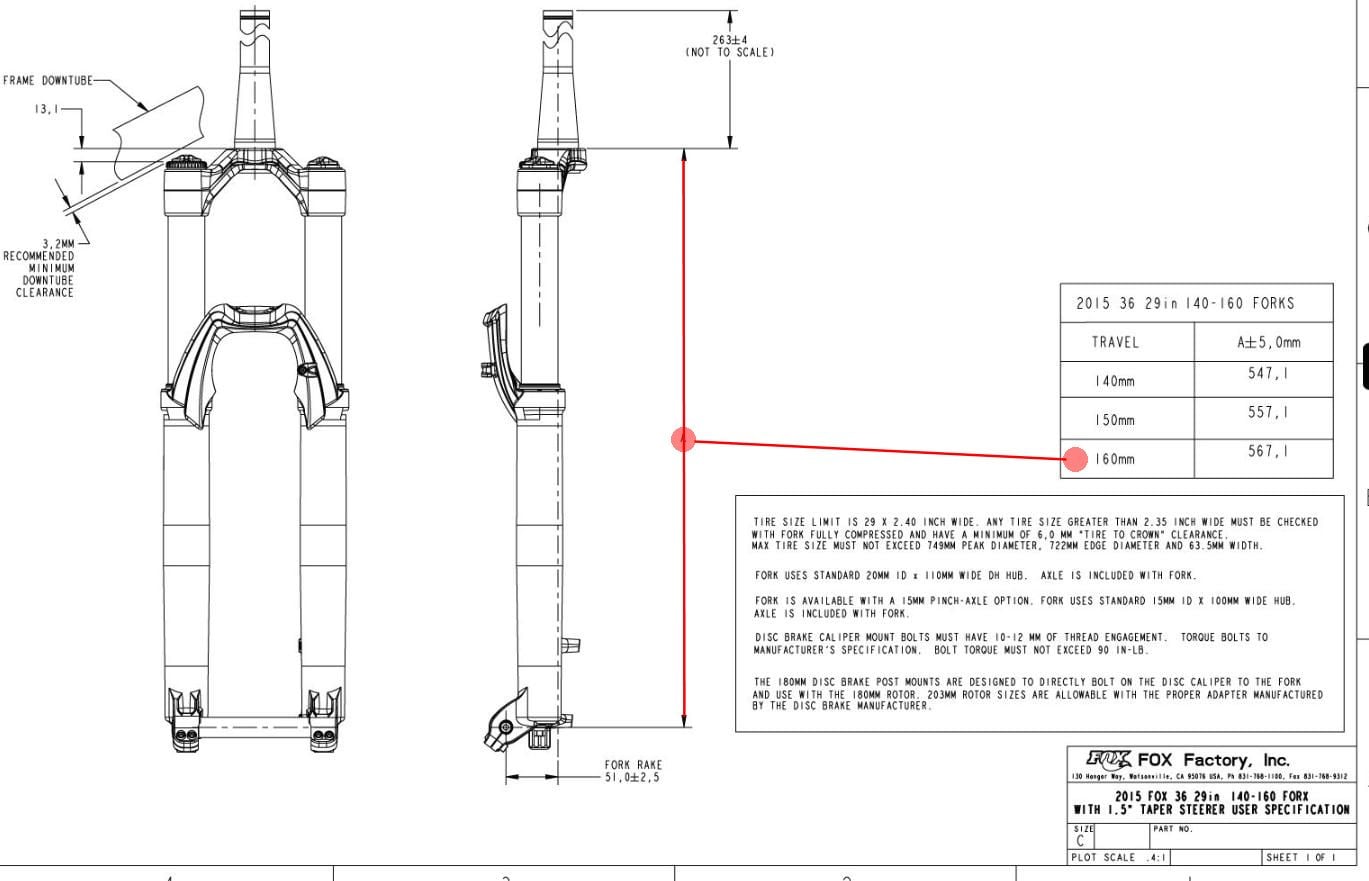

Note: A Fox fork's Axle to Crown measurement will sometimes change depending upon the year of manufacture. As an example, I ran a 2015 Fox 36, FIT4, 160mm travel fork on my Rise M20. The Axle to Crown measurement for the fork is 567mm, plus/minus 5mm. When I measured my fork, it came out to 562mm.
While the 2015 Fox fork is an older fork, I modified it with a different damper and Vorsprung suspension. It was a very capable fork and I beat the living shit out of my Rise and the fork for over 3,200 miles/5,200 Km, mostly on double black diamond terrain. I had no issues.

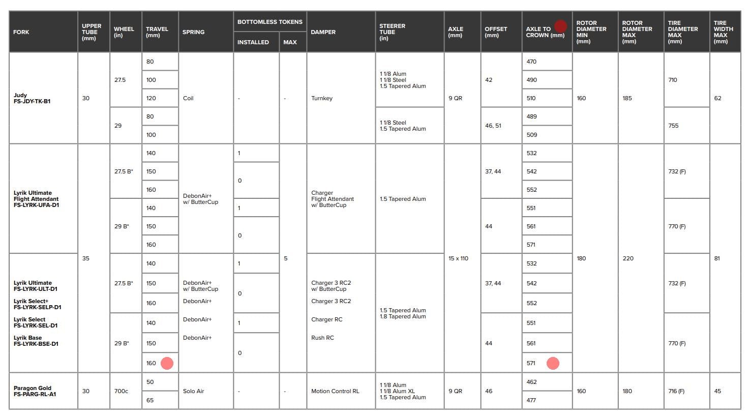

Rockshox provides a "Specification Manual" for it's forks which includes the "Axle to Crown" length for every Rockshox fork.
My buddies all own, or used to own Rises. They used a host of differing fork brands and models which exceeded Orbea's Axle to Crown maximum limit. The Rockshox Lyrik with it's 35mm stanchions is lighter than the Fox 36 and tends to suit the Rise's ultralight design ethos. My buddies found the Lyrik 160mm to be a very capable fork. If you review the specification manual for the Lyrik 160mm, you will find it has an Axle to Crown measurement of 571mm.
