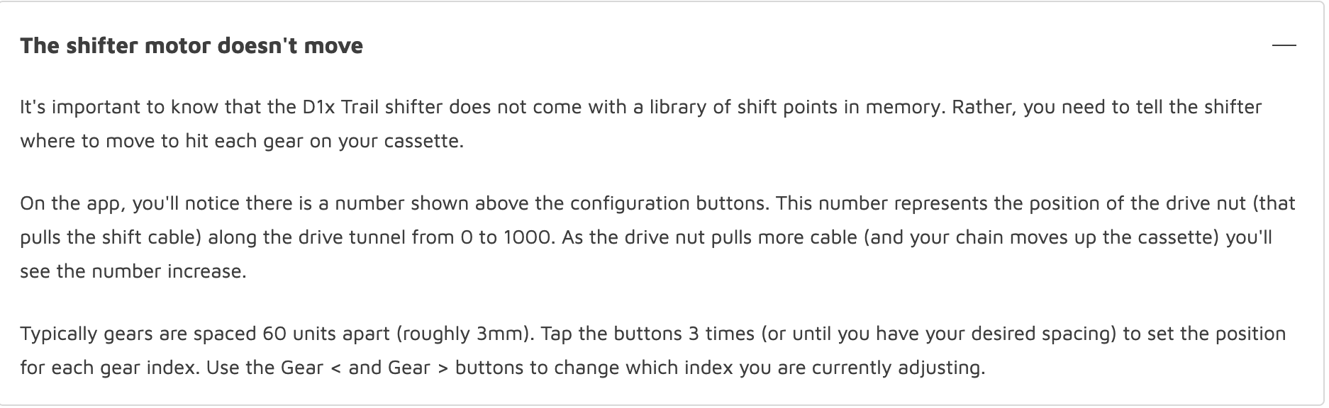

Shipping to OR was fast and I got it in a few days and I see they ship internationally also. However my bike was down but I still played around with it some and frankly couldn't get it to perform. I am really bad at reading/following directions due to a mild case of ADD and old manism so I ended up getting frustrated that it wasn't doing what I thought it should. Turns out that it was a simple thing that I was missing in that when setting it up the App shows a screen as seen above and the part I was missing was the text below it.
You need to first adjust the double arrow for larger movements and the single arrow for smaller increments to align the jockey wheel with the smallest sprocket. This is all done via the app btw the shifter comes in later after the parameters are set. Then you hit the gear up button and mess with the arrow(s) until that is working good and you will see the number value rise as well as you go along but it really doesn't mean much I found it is enough to adjust until the chain is not making any noise on the sprocket. You continue this all the way up the range and then check back down. I went up and down a few times to make sure it was working for good measure.
Next you take the paddle shifter that you have attached to your bars somewhere close to where you think it works for you and there is a button in the back that you press and that will shut off the system and when it all turns back on Voila! You are paired. Easy peasy and it will stay that way and not be interfered with by anybody else's Archer. The on button also has a fine tune feature that if you are on the trail and it gets a little wonky in a gear you can hold it for a sec and it will adjust itself. Pretty slick. Upon my first ride around the paddle would shift up on the downside of the paddle and vice versa which I found not to my taste but in the settings you can have the other way and that, at least for me, felt more natural. After riding some finish tightening everything down and you are good to go.
