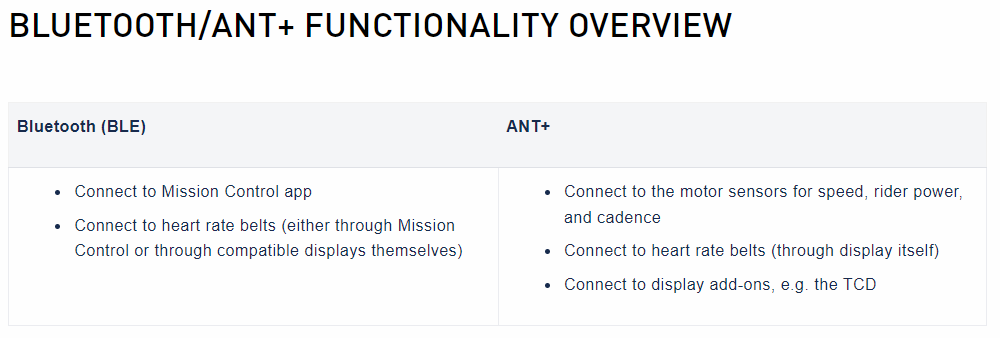

Just and FYI, I have the beta of OS 10 installed on my Ultra and was excited to get it hooked up to my levo. Levo only supports Ant+ for showing power, cadence, and speed. The apple watch does not have Ant+ support only Bluetooth so there is no ability to connect it.
It’ll depend whether the bike has BLE hardware that can broadcast. If it does the Specialised should be able to make it happen. Since the phone connection to the bike is BLE, using the mission control app, I would think they can make it compatible with the Apple Watch. Currently it only broadcasts ant+ but it looks like the hardware is capable of BLE.
Actually I’d be more than happy to just have the Watch start and stop the bike recording and read the heart rate from the watch on the bike. The phone connection just doesn’t work for me. I still need a separate HRM and I need to have the phone on the bars for GPS signal which I’m never going to do. Much easier just to use the watch.
