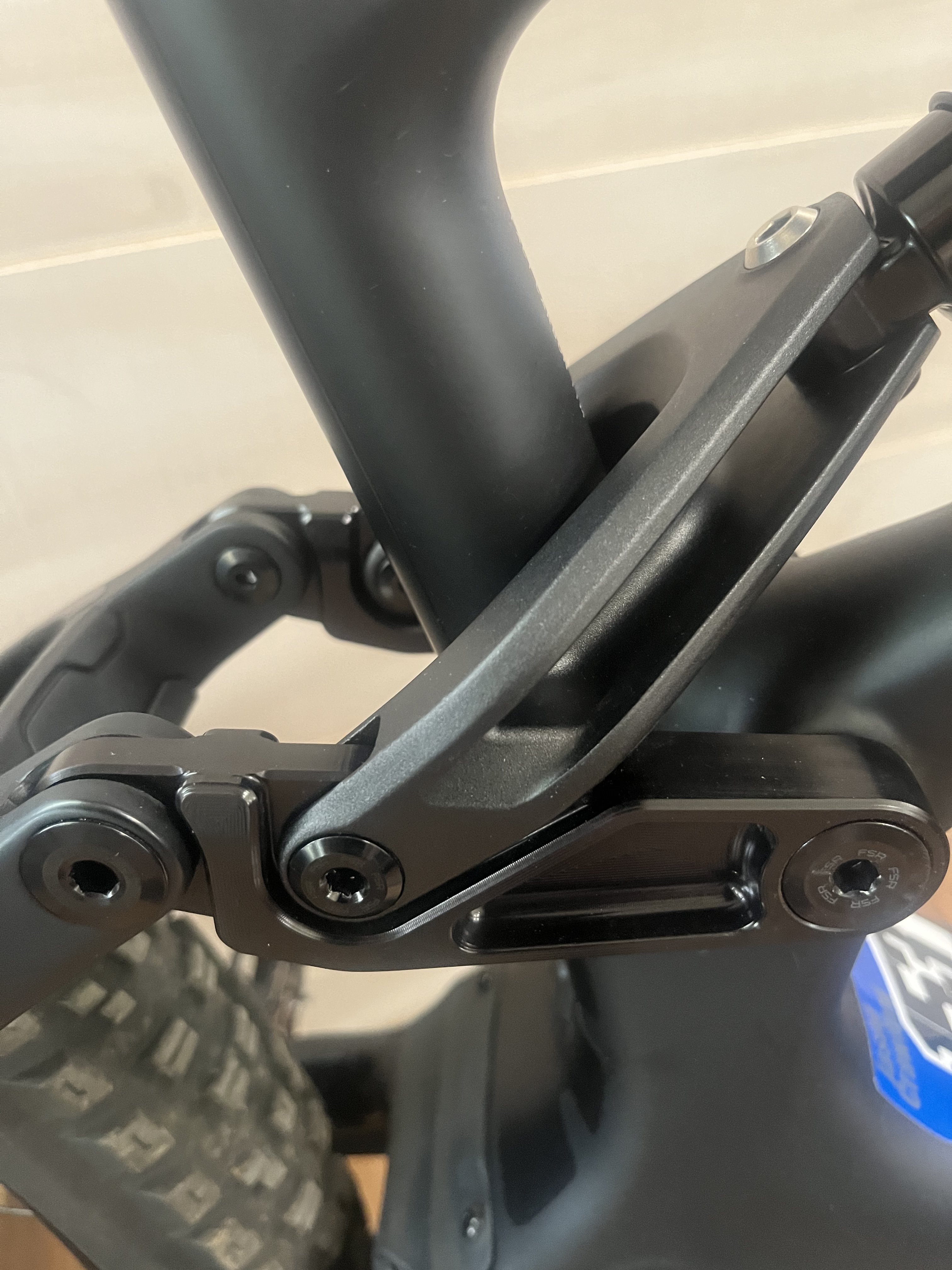

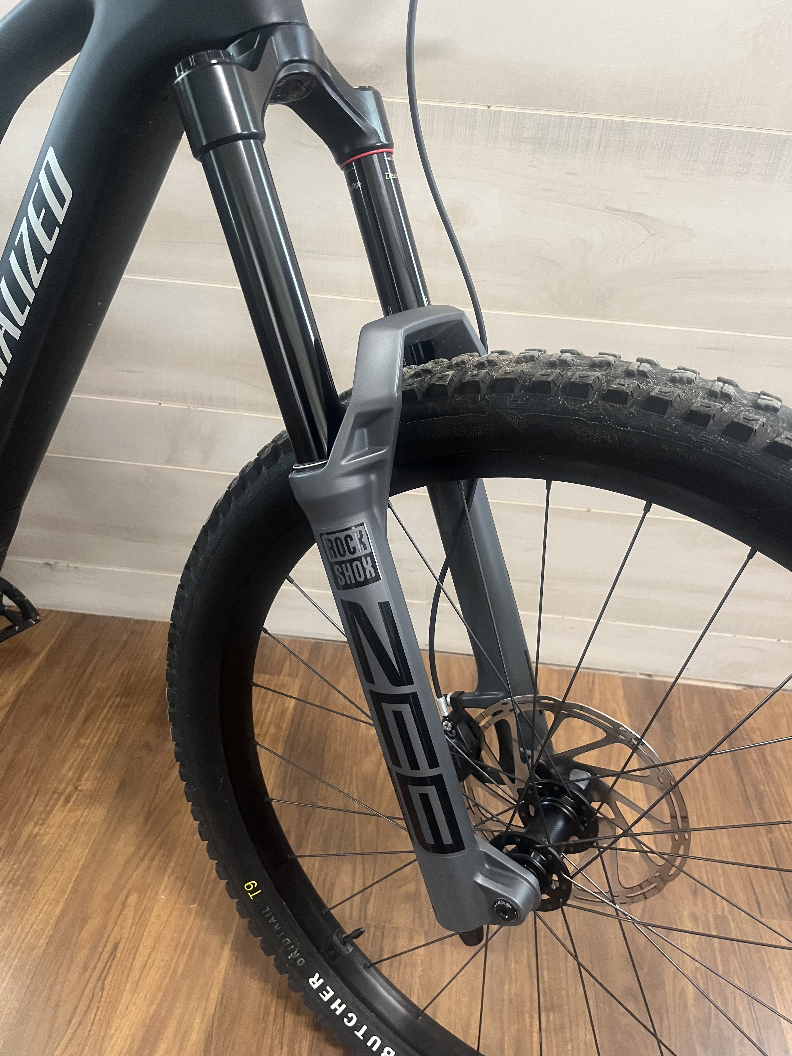

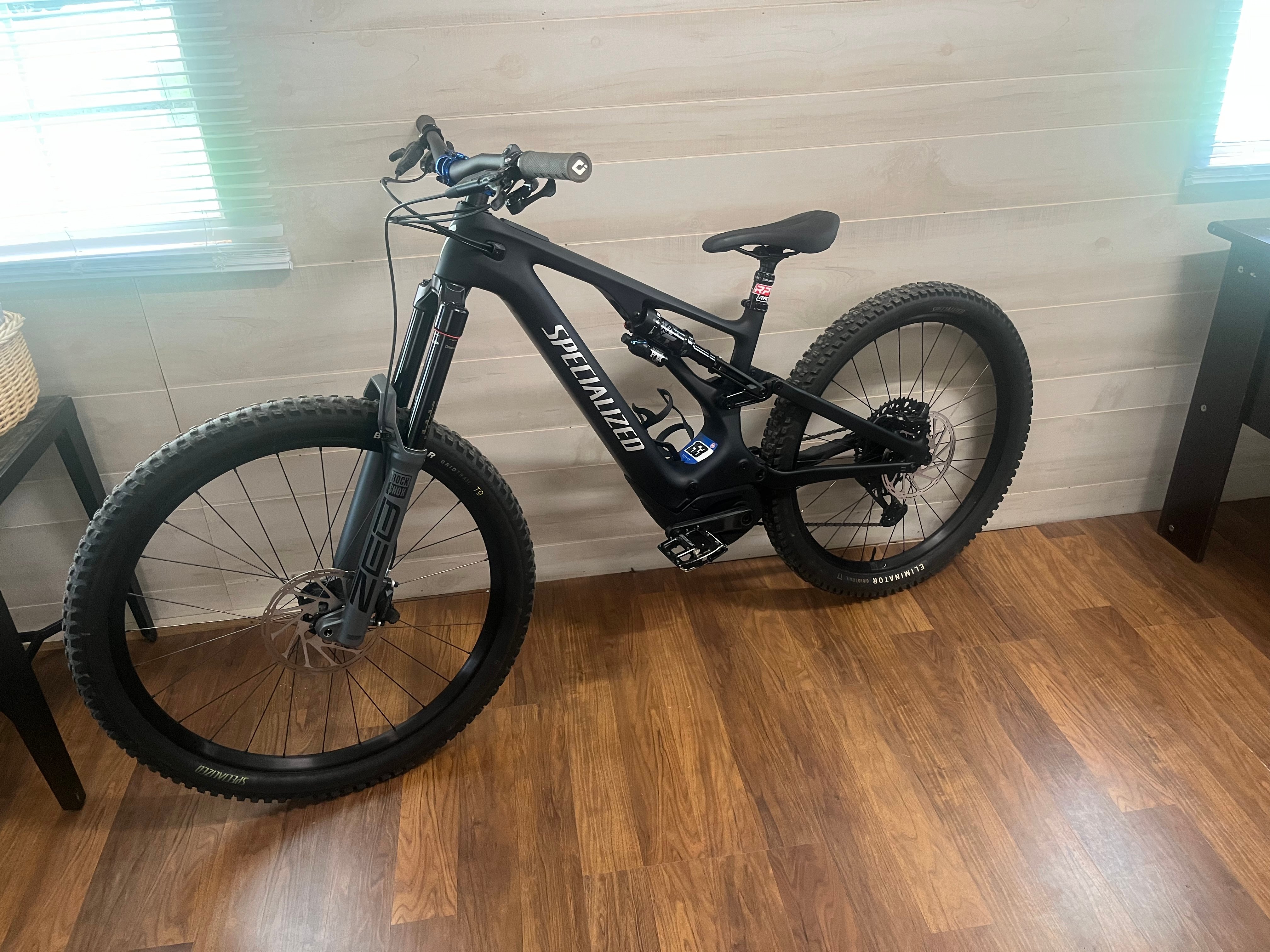

Zeb 180 mm with a cascade link. Best thing I’ve done to the bike. Can run lower fork pressure and have great hold up and small bump absorption.
5451E174-CA34-45B0-8D1F-E8971B00DA60.jpeg 77549FDA-69A9-4D41-97C5-3B17729F22B9.jpeg 3BF6D7FF-F1CF-462F-88A8-93623CA42DA5.jpeg
Crawford919
Aug 7, 2019
132
138
Yes! An actual user experience!! Any negatives at all??
I would say it has to have lower air pressure if you’re doing XC style trails to make it have front end turn In feel like it did with a stock 160mm. I raced this bike at a XC and had too much air and it pushed slightly but then lowered the pressure to 60 psi from 80 psi and it corners awesome. Otherwise nothing but advantages over stock. It will suck up the big and rough stuff like you can’t believe.
