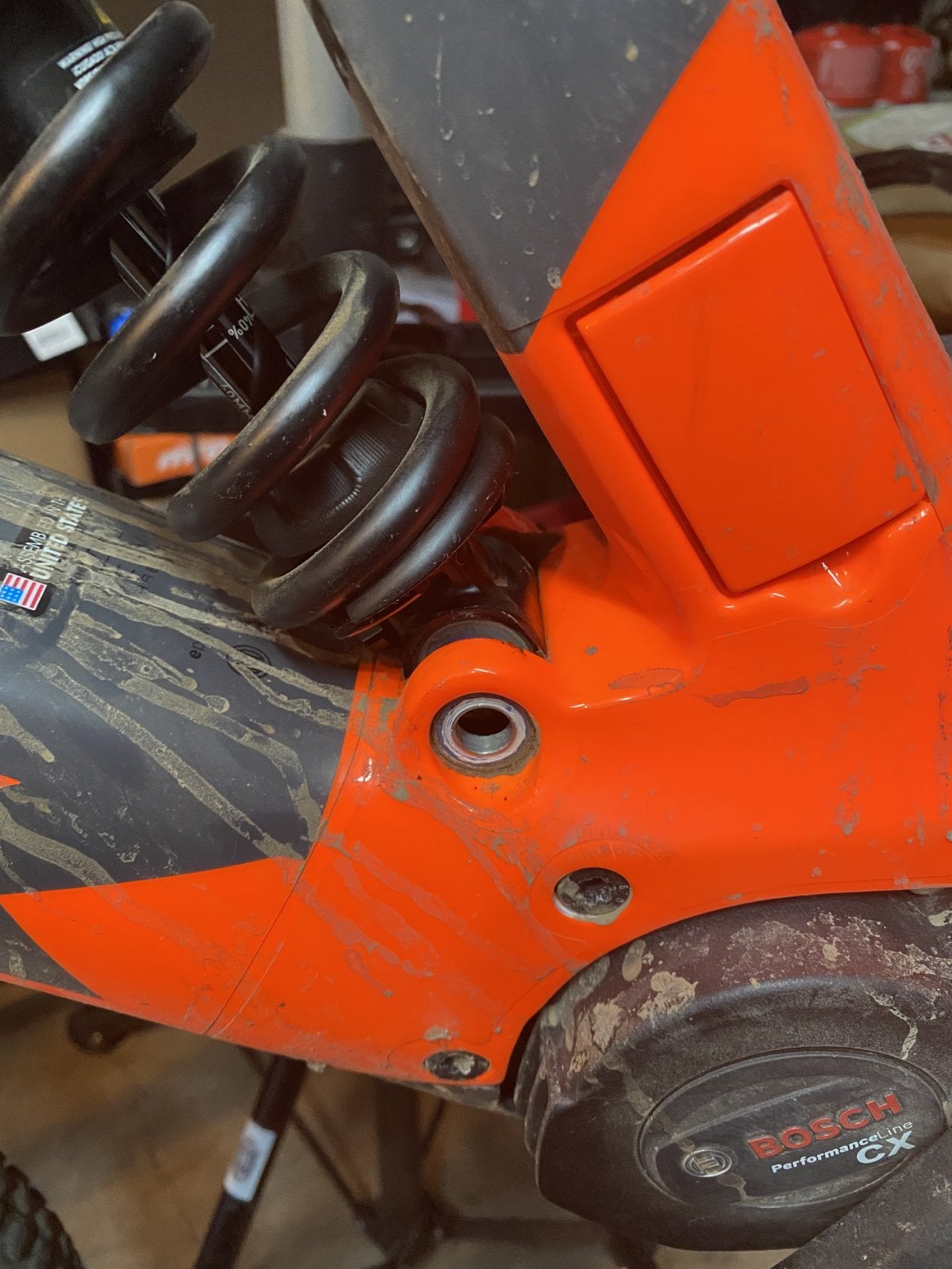

B Black8917 Member Jun 17, 2021 34 11 PNW Jul 12, 2021 #2 The bottom of Deluxe ultimate air and coil 230x65 hit the frame so the bolt doesn’t line up. It won’t sit far enough down.
B Black8917 Member Jun 17, 2021 34 11 PNW Jul 12, 2021 #5 It’s a large. Maybe if you removed the bearings and used offset bushings it would work.

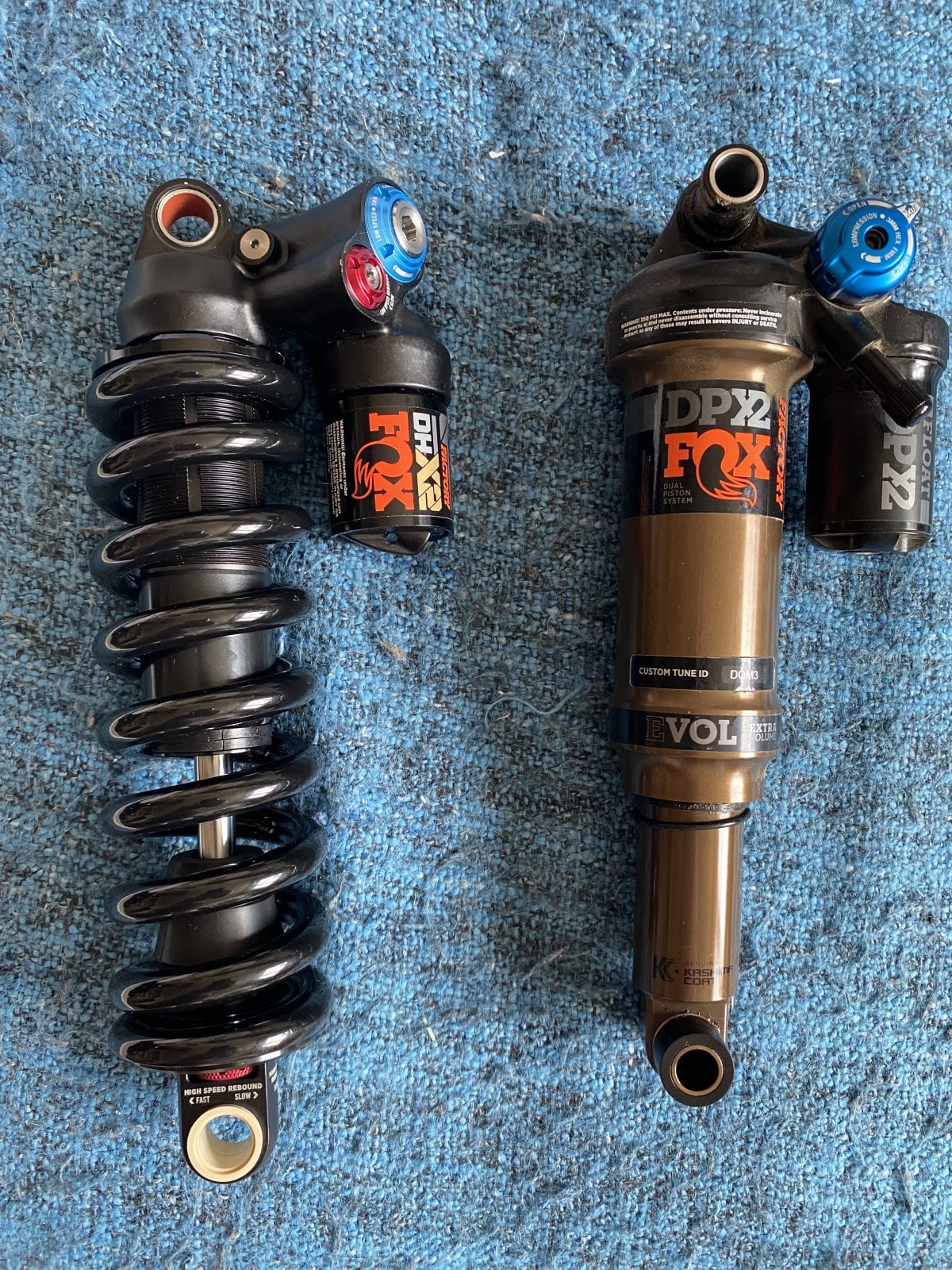

PetrD Member Jul 27, 2020 70 21 CZ Jul 15, 2021 #6 I am happy with Fox DPX2 and DHX2 on XL size of Rail.
BiGJZ74 E*POWAH Master Subscriber Mar 17, 2021 573 444 American Canyon, CA Jul 16, 2021 #7 I have both for my Rail too PetrD said: I am happy with Fox DPX2 and DHX2 on XL size of Rail. View attachment 66539 Click to expand...
