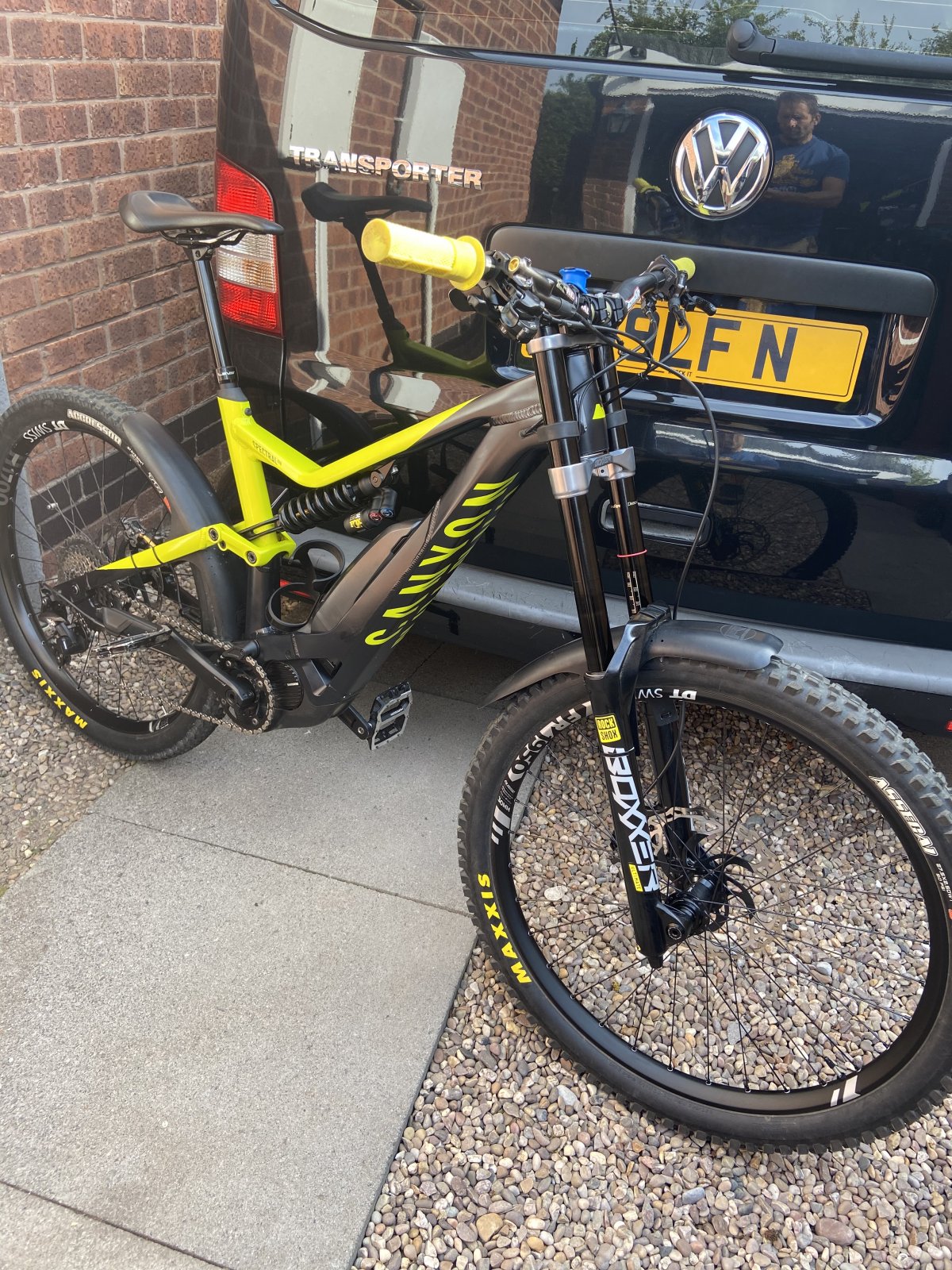

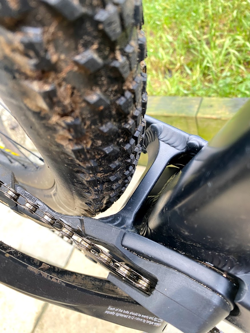

Sep 25, 2019
40
28
This is my Spectral:On with 29" wheels on it. The tyre is a 29" Maxxis Ardent Race and as you can see the clearance is small so I don't think it would take a more aggressive tyre like a Minion DHR.
