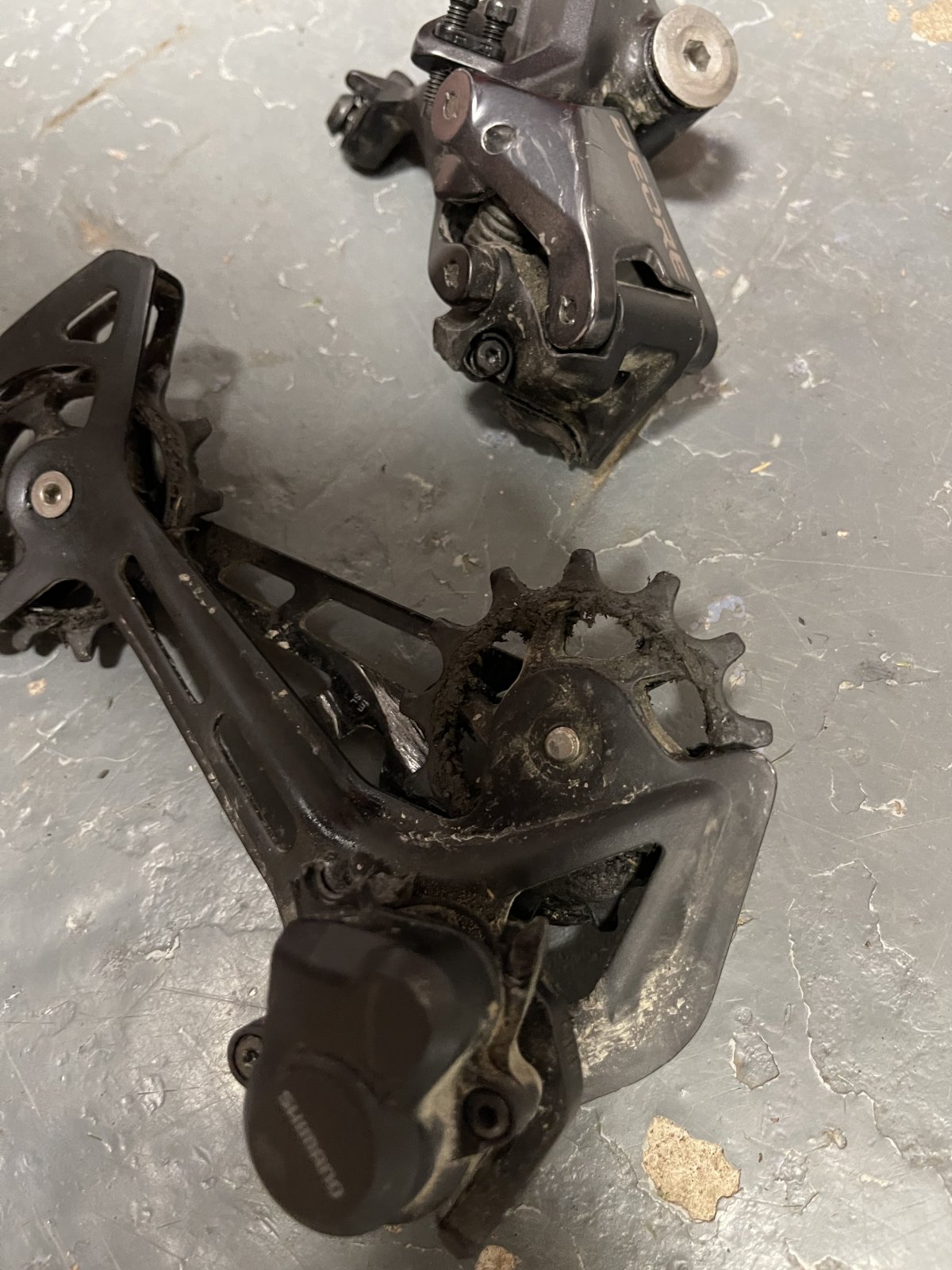

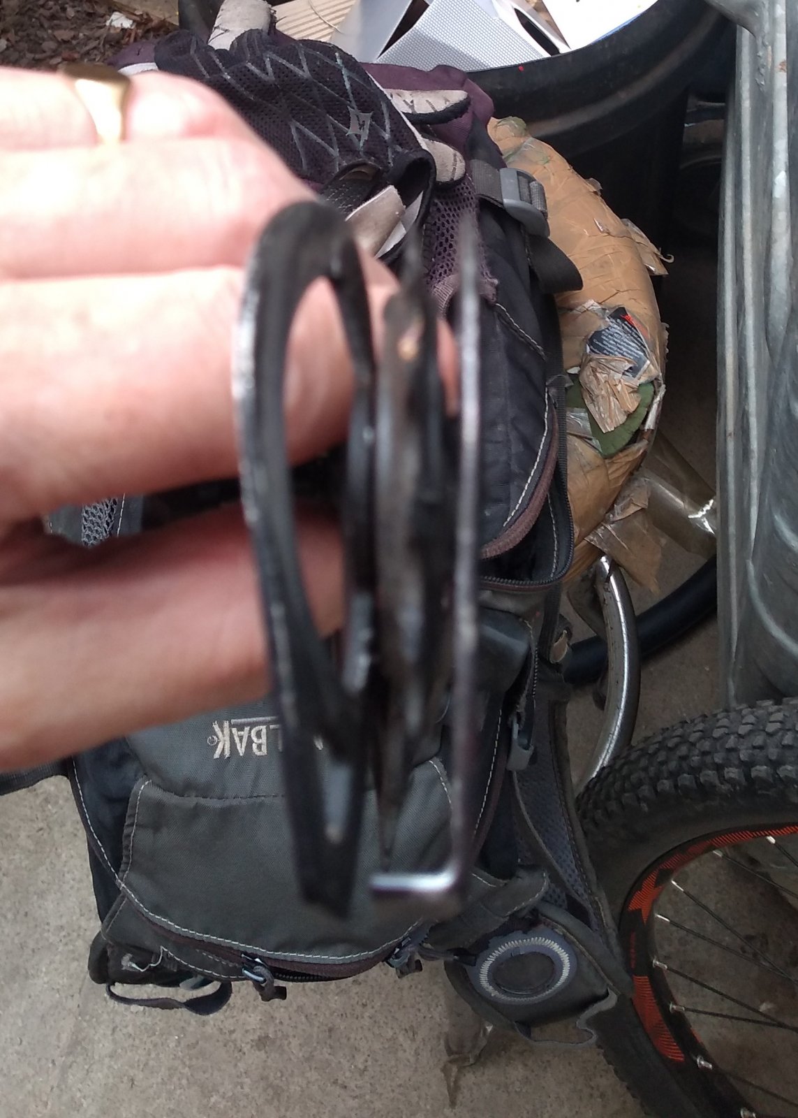

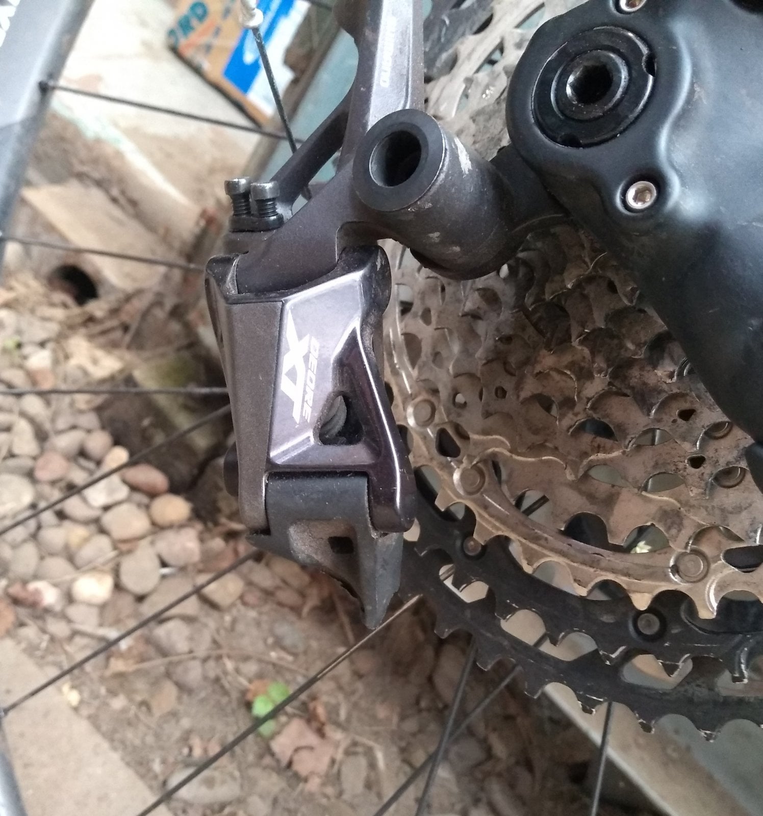

I had an off and bent one of the mech arm plates. The outer plate was bent outwards. The jockey wheel is end-on in the picture and parallel to the inner plate. You can see the outer plate flaring (and that is after @myapes had a go at straightening it. The shifting was still fine though, so we pressed on.
About 200 yards further on, I got one of those young pine tree branches stuck in the mech. It was about half an inch thick and very bendy. They are difficult to break, but cut easily. There was a horrible graunching noise and my transmission went hard, so I stopped pedalling straight away. I looked down and half the mech was hanging from the chain! The mech had snapped just below the clutch body. The mech hanger was unbent (as far as we could tell).

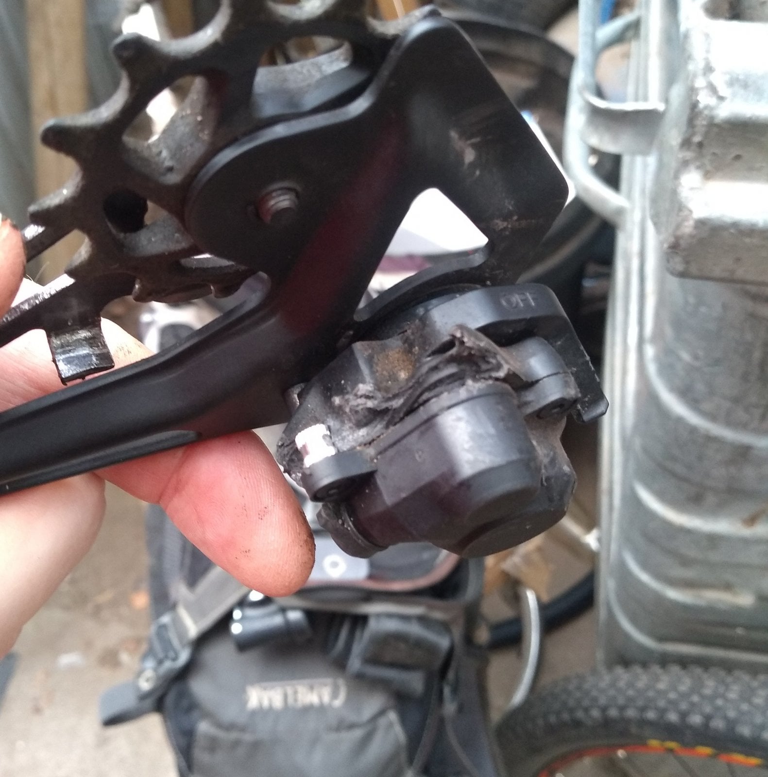

In the picture below, the mech arm holding both jockey wheels is upside down. You can see the clutch body. The fracture passed through the centreline of that silvery bit that is a metal plug that a screw goes into to secure the clutch housing (1of 3). There is a gasket that seals the clutch and that is exposed by the fracture.
Here is the main body of the mech, still attached to the bike. The fracture runs along the bottom edge of the mech that you can see, just below the hinge.

yes l guess, if you are cranking the pedals on an ebike and the transmission stalls due to a tree branch stuck in the mechanism, the motor will deliver maximum torque because it will think you hit a rock step or similar.
So it will likely smash the rear mech up good and proper, as has happened to yours.
Fortunately, I was going dead slow at the time (sharp right hairpin downhill), otherwise I dread to think what else might have got damaged.
8,933
9,273
I have just discovered that the lower jockey wheel's easy movement has been constrained by the bent side plate. It will turn but it is quite stiff. Whether that happened after the first crash, was caused by @myapes attempt to straighten it, or the second crash I now have no idea. :unsure:

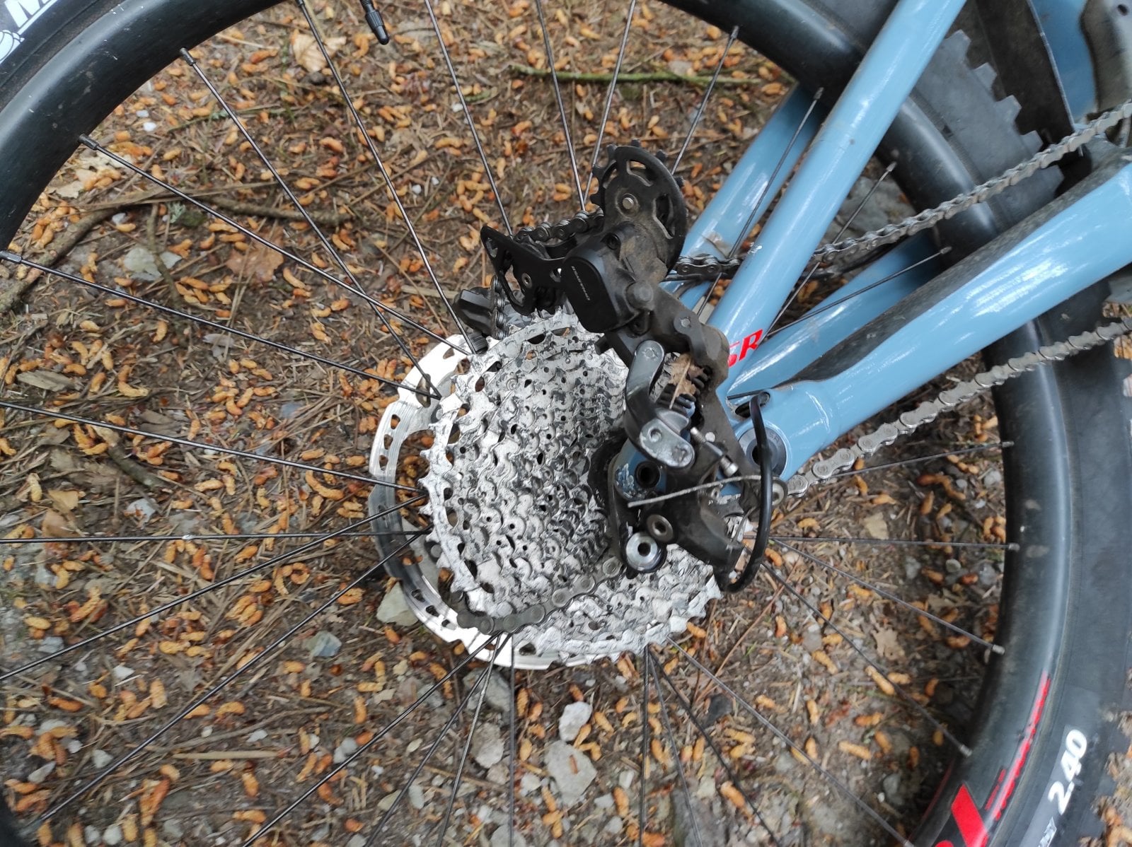

I did that the other day too. Bloody stick got me. I think It was one that I had cut shortly before doing some trail maintenance, so it was revenge of the stick!

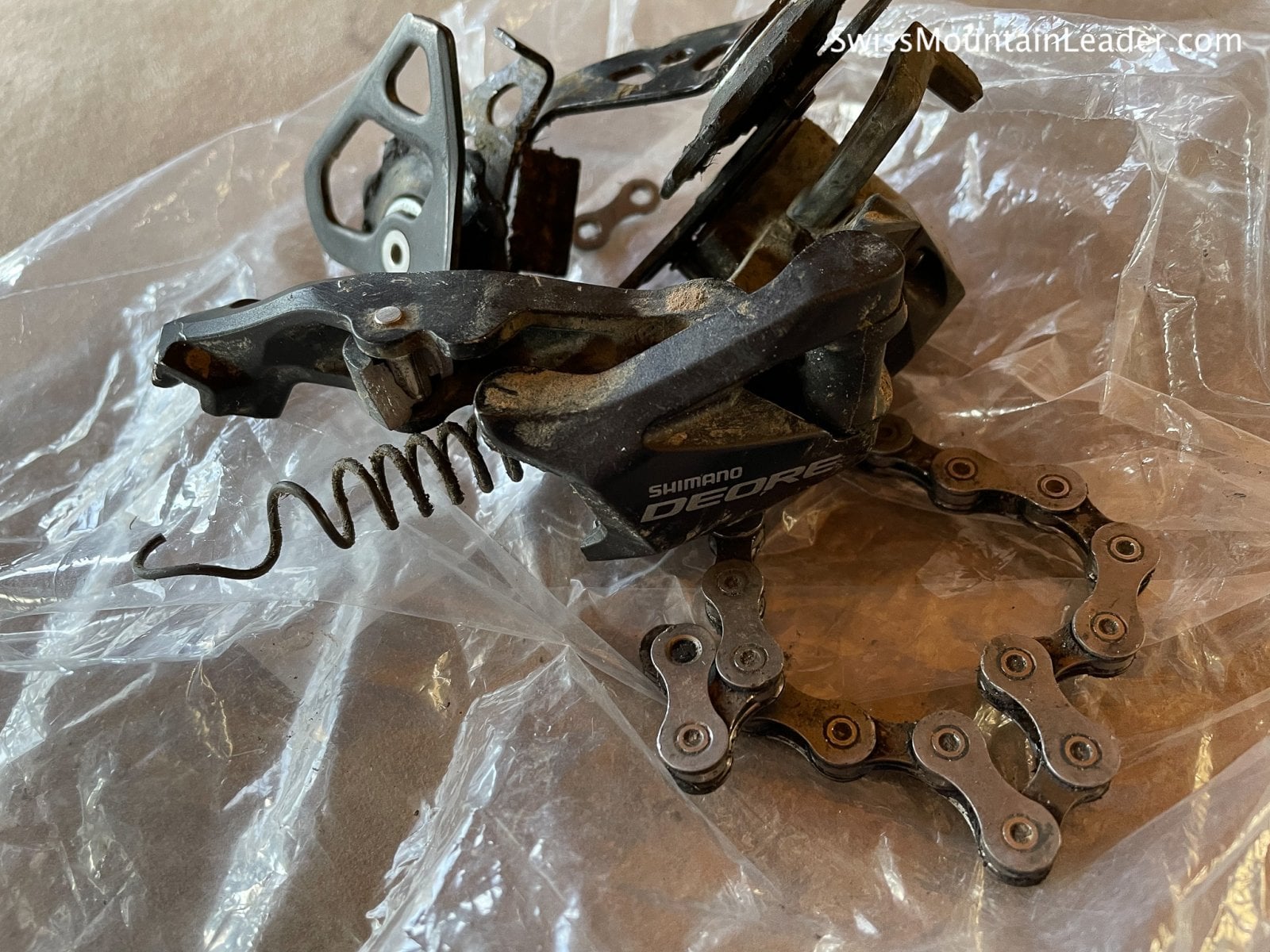

snapped one today :)
riding on a pretty abandoned forest service road, a branch leaped out and threw itself at the moving parts, I suspect part of it caught on the frame and then ripped the mech out. I broke the chain and picked a middle gear (which was horrible) and rode out. Called in the store in the village who handed me a new mech without any drama.

Now that is what I call thoroughly trashed. :eek:
it's on the desk next to me, looking at it seems to show something probably got caught in the guide pulley and then twisted that 180º and then it snapped near the mount. Not surprising that it snapped when you see the force that must have been on it.
I think it'll take a couple of days to get a like-for-like, the LBS offered one that won't quite work.

Make sure you check the hanger as well. If it's bent it'll make setting the mech up "interesting"...
...ask me how I know... :mad:

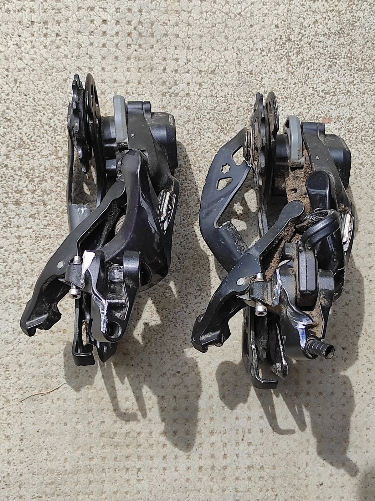

I had the exact same breakage this morning - however I was on a slow climb up a fire road - there was no stick or undergrowth to foil the mech - it just went crunch and was like that - I think the mech breaks as that part seems to be plastic or composite - I have a sacrificial bolt on the hangar and that was intact .
I am definitely taking it up with Madison / Shimano as I think it is a material failure
. The frames holding the pulleys are also very flimsy these days

Well that is three identical failures just on this thread in a few days. Me, you and @Peterg
