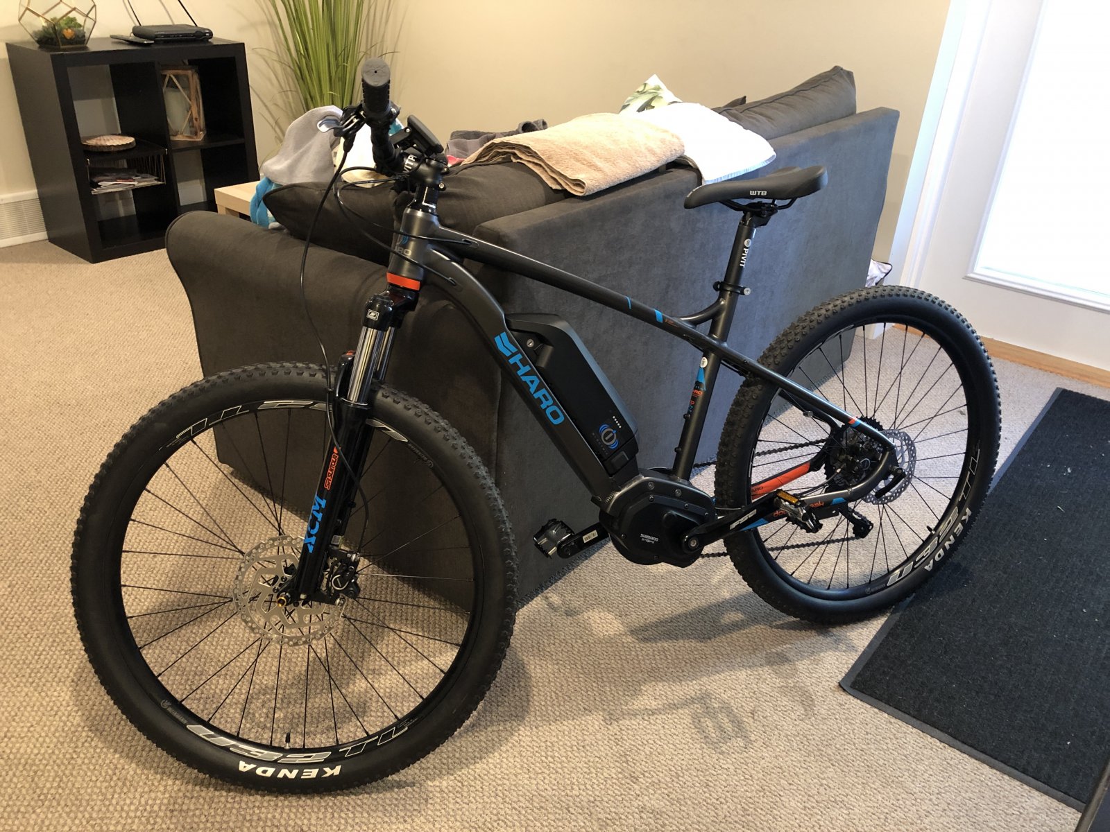

First real Mountain bike & first EMTB, pretty happy with it. Doesn't look like there are any other Haro riders here..

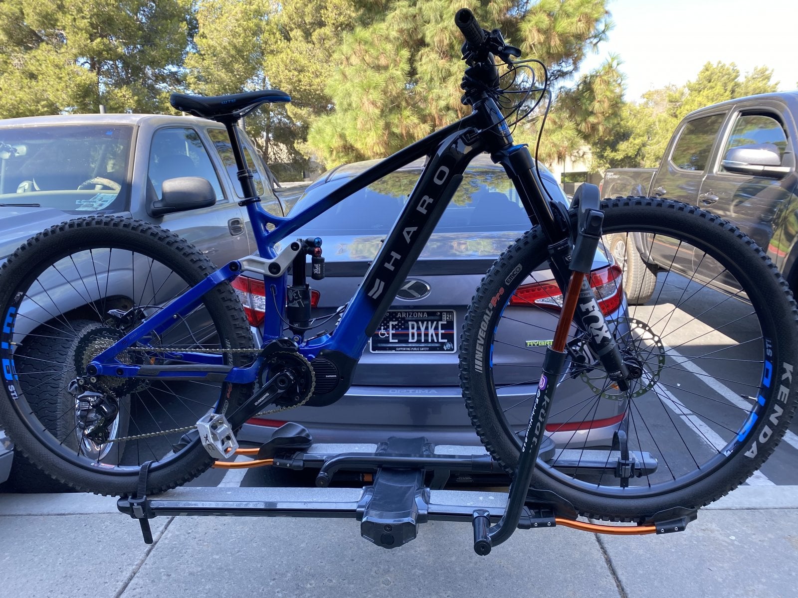

Look at the new ones. They are supposed to be here in the US in March 2020. I have a friend that works at Haro. Says they are getting great feedback from testing. They look awesome and have a pretty big battery and really nice components. Probably available in Canada about the same time I would expect?
LTP is the Canadian distributor for Haro's brands (Haro, Del Sol, and Premium). For 2020 e-bikes they seem to have chosen to distribute the Del Sol branded e-bikes, but not the Haro branded e-bikes. If anyone knows otherwise, I'd love to learn more!

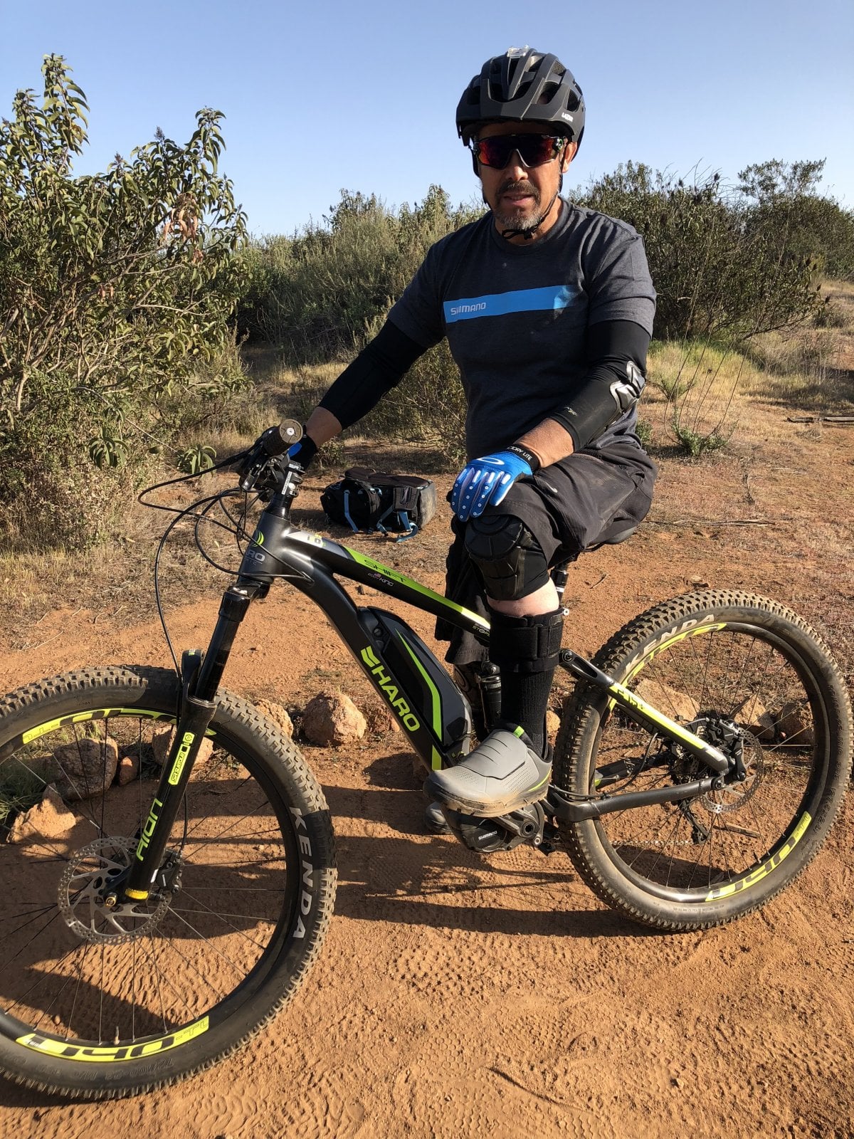

Been riding a Haro I/O5 since March 2018. Please checkout my 8 minute documentary on Youtube View attachment 30640
Thanks, I'll be getting the 2020 ebikes soon and I'll post them on here for everybody to checkout. Stay loyal to the brand. :)
WOW what an amazing story! You are a champion Eddy!!
I really enjoy my Haro, I Iook forward to seeing the 2020 ebikes! Thanks for posting!
