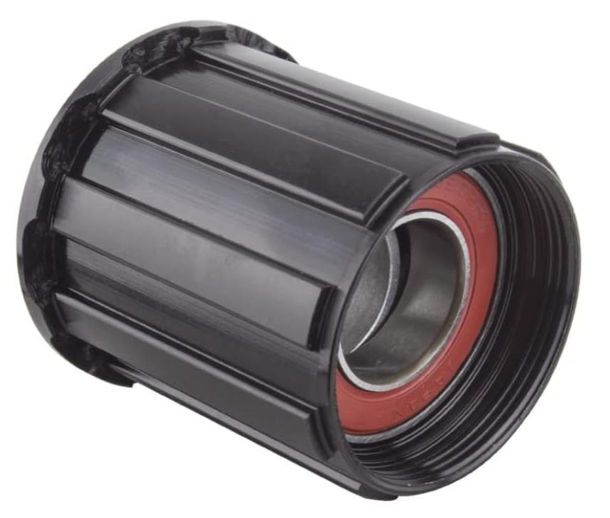

The freehub/drive on a rear hub is a much overlooked component on a bike. I would submit that it's one of the most important components on a bike. Brakes are great, it's nice to stop...however, without a correctly working freehub, you're not going anywhere, ask me how I know. Your drivetrain, i.e. Shimano, SRAM, e*thirteen, Box, etc, will dictate what freehub/driver your bike came with. The most common are Shimano and SRAM.
There are three basic Freehub or Driver designs which are as follows:
SHIMANO HG FREEHUB - Commonly used on older style Shimano drivetrains, i.e. 10 or 11 speed drivetrains.

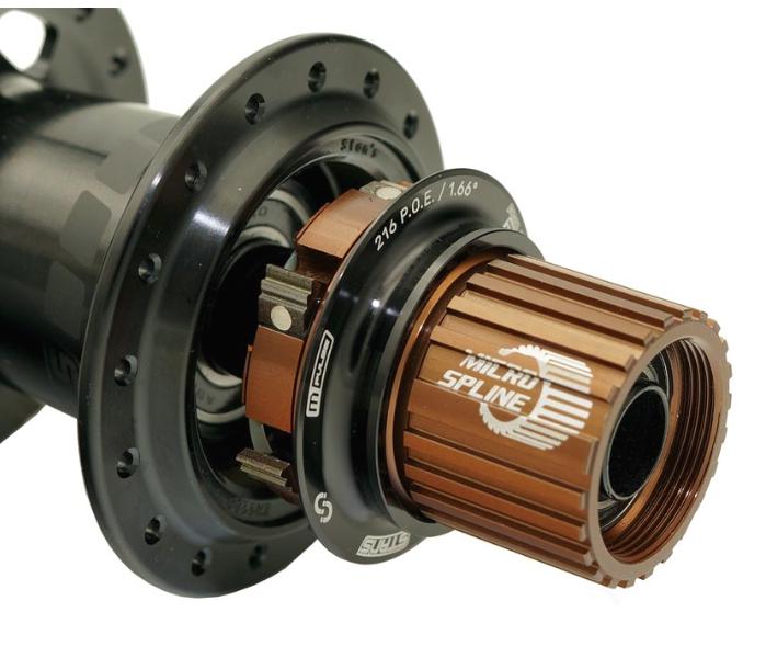

SHIMANO MICRO-SPLINE - Commonly used on modern Shimano 12 speed drivetrains

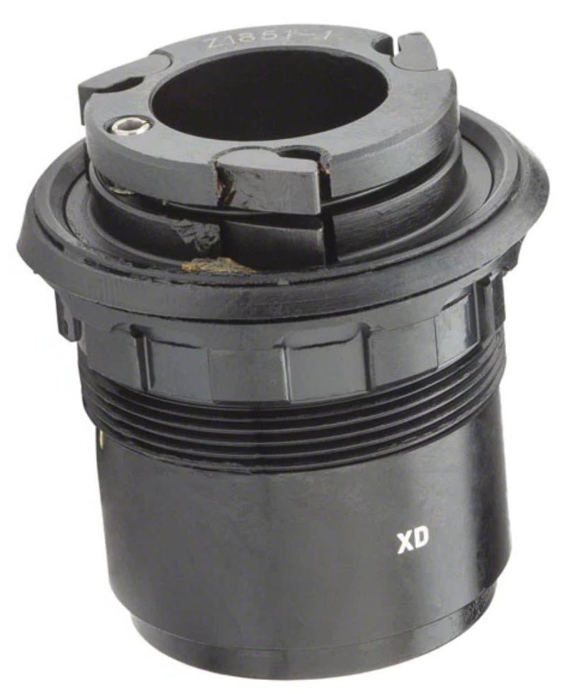

SRAM XD DRIVER - Used on SRAM 12 speed drivetrains
Important note:
Both Shimano and SRAM license their freehub/driver designs and allow the design to be manufactured and incorporated into a hub manufacturers design, i.e. D.T. Swiss, Industry Nine, Hope, etc. While the spline and cassette mounting design are the proprietary designs of SRAM and Shimano, the freehub/driver engagement is the proprietary design of the hub manufacturer. In almost all instances you cannot switch a freehub/driver belonging to one hub manufacturer and install it on another hub manufacturer's rear hub. As an example, D.T. Swiss rear hubs can be purchased with either a Shimano "Freehub", Shimano "Micro-Spline" or SRAM "XD Driver." However....you cannot use a D.T. Swiss' freehub or driver on an Industry Nine Hydra rear hub. It's also important to point out that some hub manufacturers will license and allow their freehubs/drivers to be produced by other manufacturers.
While hub manufacturers will utilize the licensed/patented design of SRAM or Shimano, the freehub/drive engagement is where the hub manufacturer's design is unique and proprietary. There are two styles of freehub/driver engagement that are most commonly found on rear hubs. They are the "Ratchet" design and the "Pawl" design. Note that there are other hub manufacturers such as Onyx which utilize a "Sprag" clutch design. Each freehub/driver engagement design has Pro and Cons, i.e. engagement angle, strength, noise, longevity, weight, consumer cost, cost to manufacture, etc.

The cassette mounts to the freehub/driver. This is typically done by the cassette threading onto the driver such as with the SRAM XD driver. With Shimano drivetrains, the cassette cogs are stacked and assembled onto the freehub splines and a threaded retention nut is tightened onto the threaded end of the freehub. The retention nut holds the cassette cogs in place on the freehub. When coasting and not pedaling the cassette floats and spins freely via the freehub/driver. When pedal force is applied by turning the cranks, the cassette and freehub/driver engage the rear hub and propel the bike forward.

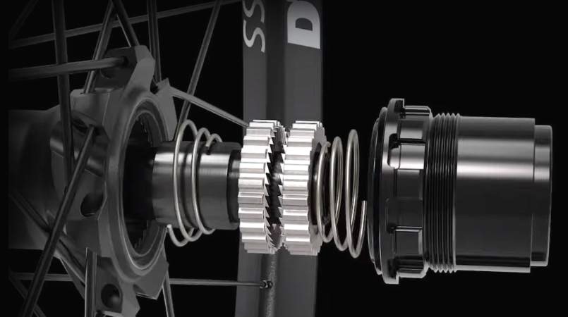

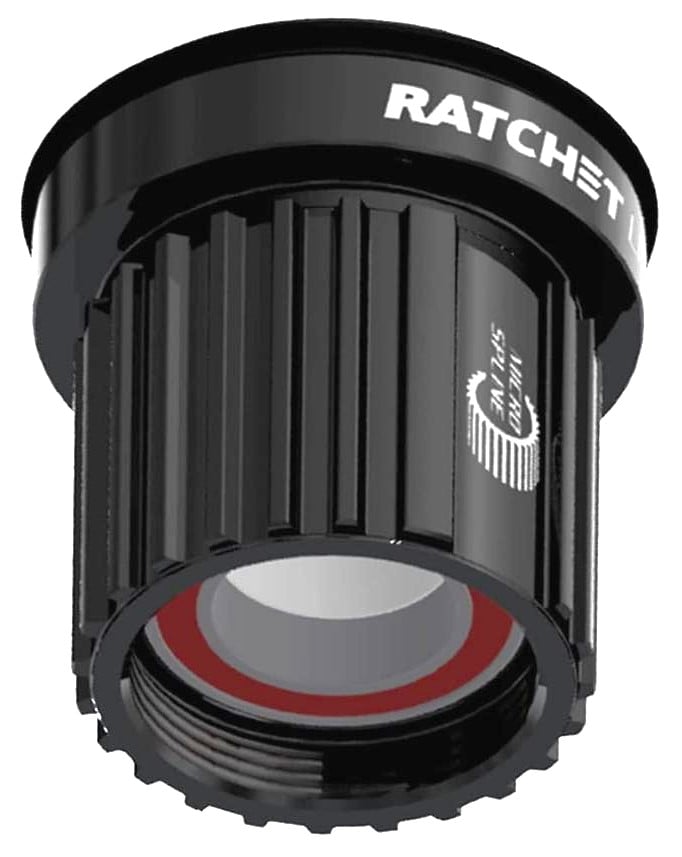

Star Ratchet Design:
D.T. Swiss employs a "Star Ratchet" freehub/driver engagement design. This is a very robust design and can withstand the torque produced by eBike motors. The design works by allowing the star ratchet teeth to disengage and float when coasting and not pedaling. When pedal force is applied, the teeth on the two star ratchets engage each other and the cassette applies power to the rear hub.
Engagement angle, i.e. how quickly pedal force is applied when the cranks are turned is dictated by the amount of teeth on the two star ratchets. The finer the tooth count, i.e. larger number of teeth, will allow a quicker crank engagement. Should the rider desire a quicker angle engagement, D.T. Swiss sells Star Ratchet upgrade kits. which have a finer tooth count.
D.T. Swiss 350 Hub with SRAM XD Driver
D.T. Swiss star ratchet engagement rings for various D.T. Swiss wheel hubs. Note that the finer the tooth count, the quicker hub/crank engagement will be.
DT-Swiss-240-Ratchet-DEG-hub-review_90T-MTB-fast-engagement_90T-vs-35T-vs-18T-ratchets.jpg

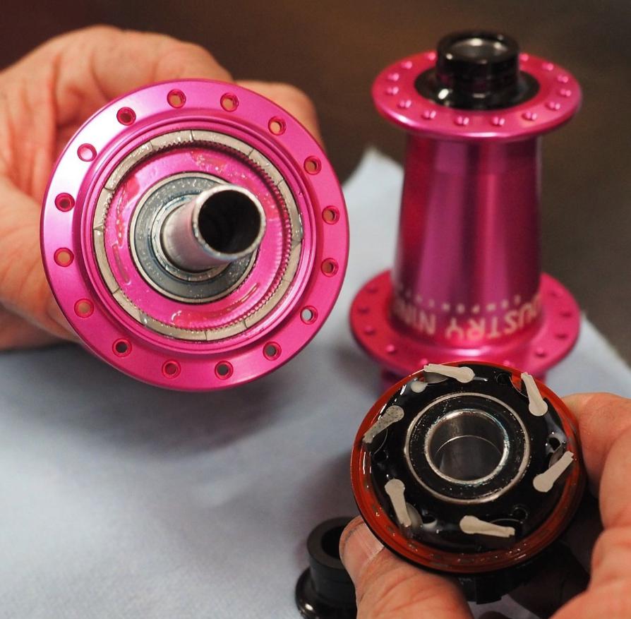

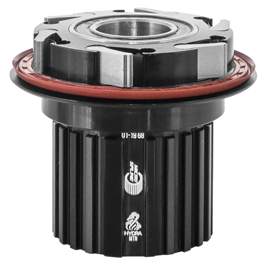

Industry Nine Hydra with freehub/pawls and drive ring shown.
The amount of pawls that a freehub/driver has, will dictate how quick the engagement will be when the cranks are turned. As an example, Industry Nine Hydra freehubs have six pawls and offers an immediate engagement, whereas a D.T. Swiss 370 freehub with three pawls will offer a slower engagement.
This is because not all pawls on a freehub/driver will immediately engage the drive ring. This is due to pawl synchronizing with the drive ring. The more pawls, the more pawls available to engage the drive ring and thus a quicker engagement. It should be noted that freehubs with less pawls, i.e. three pawl design are weaker than a six pawl design. This is because with a three pawl design, there may be only one of two pawls that imediately engage the drive ring when the cranks are turned. This places more stress on those few pawls doing the engagement.

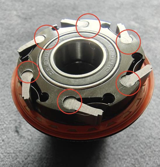

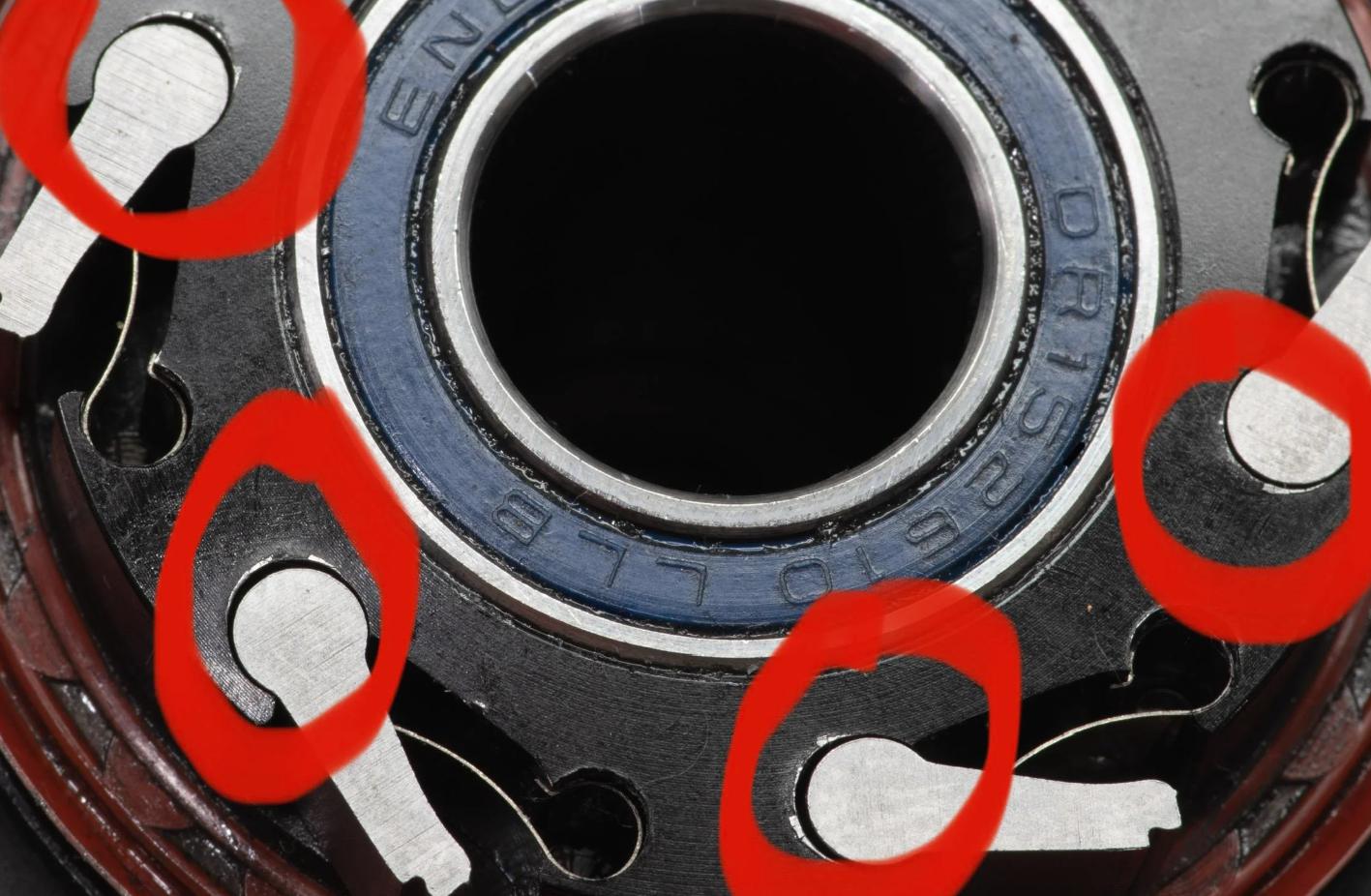

Having owned various "Pawl" designed hubs/freehubs, it's been my personal experience that Industry Nine freehubs do not hold up well long term to the torque produced by eBike motors. Industry Nine hubs however, are an excellent choice for traditional pedal bike drivetrains. While Industry Nine Hydra engagement is excellent, longevity of the freehub is not as good nor as strong as the D.T. Swiss star ratchet design. I've tried both for thousands of miles. It's also been my experience that hub bearing wear and failure is more prevalent with Industry Nine hubs as opposed to D.T. Swiss. This is especially so with the older style Industry Nine "Torch" style hub.
It's been my personal experience that Industry Nine Hydra freehubs/drivers will begin to develop engagement issues after about 1,500-2,000 miles of hard eBike use. The aluminum alloy bore slots which the hardened steel pawls rest and rotate in, will eventually become enlarged. This introduces play into the pawl and drive ring engagement. When this happens, the pawls and drive ring no longer engage correctly and securely. Your cranks will begin slipping/skipping under a hard pedal.
Industry Nine Hydra hub with elongated pawl bores.
I've also encountered issues with the tension springs used in pawl freehub designs. The springs provide tension between the pawls and drive ring. On three-pawl freehubs such as that used on Specialized Turbo Levo base model wheels, the springs will begin to lose temper, i.e. lose their springiness. When this happens, the freehub will begin to skip on the drive ring and eventually fail.
In situations where the alloy pawl bores become elongated, a new freehub replacement will correct the situation. In situations where pawl springs lose their temper, a rebuild with new springs and pawls will remedy the issue. Typically, if pawls start skipping on the drive ring, they will damage the pawls. The pawls should be replaced along with the springs if they are damaged.

I personally prefer the D.T. Swiss 350 hub with 54T star ratchet. I have several D.T. Swiss 350 hub wheelsets which have at least seven thousand miles on them. They look like shit from rock strikes, but the hubs are still going strong with only the occasional bearing replacement required. The D.T. Swiss star ratchet design is built like a brick shit house and will hold up to a lot of eBike motor abuse.
I also like that D.T. Swiss hubs are quick and very easy to service, i.e. clean and re-lubricate the freehub on the D.T. Swiss star ratchet design. All you need to do is physically pull/tug the cassette off of the hub to quickly get access to the star ratchet system for cleaning and lubrication purposes.

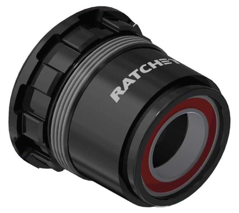

You have several options available to you. I believe number one to be your quickest and easiest option to achieve a quicker crank arm engagement and also a more robust freehub engagement.
1) D.T. Swiss sells a conversion kit that will convert your 370 rear hub's three pawl freehub/driver to a star ratchet design. I've included a link to D.T. Swiss' website so you can research the matter. I'd be more specific about the conversion but I do not know what type of drivetrain and freehub your rear wheel has. If you go the conversion from three pawl to star ratchet route, purchase the 54T star ratchet kit.

You are correct. D.T.Swiss offers a star ratchet conversion kit for the 370 hub.
