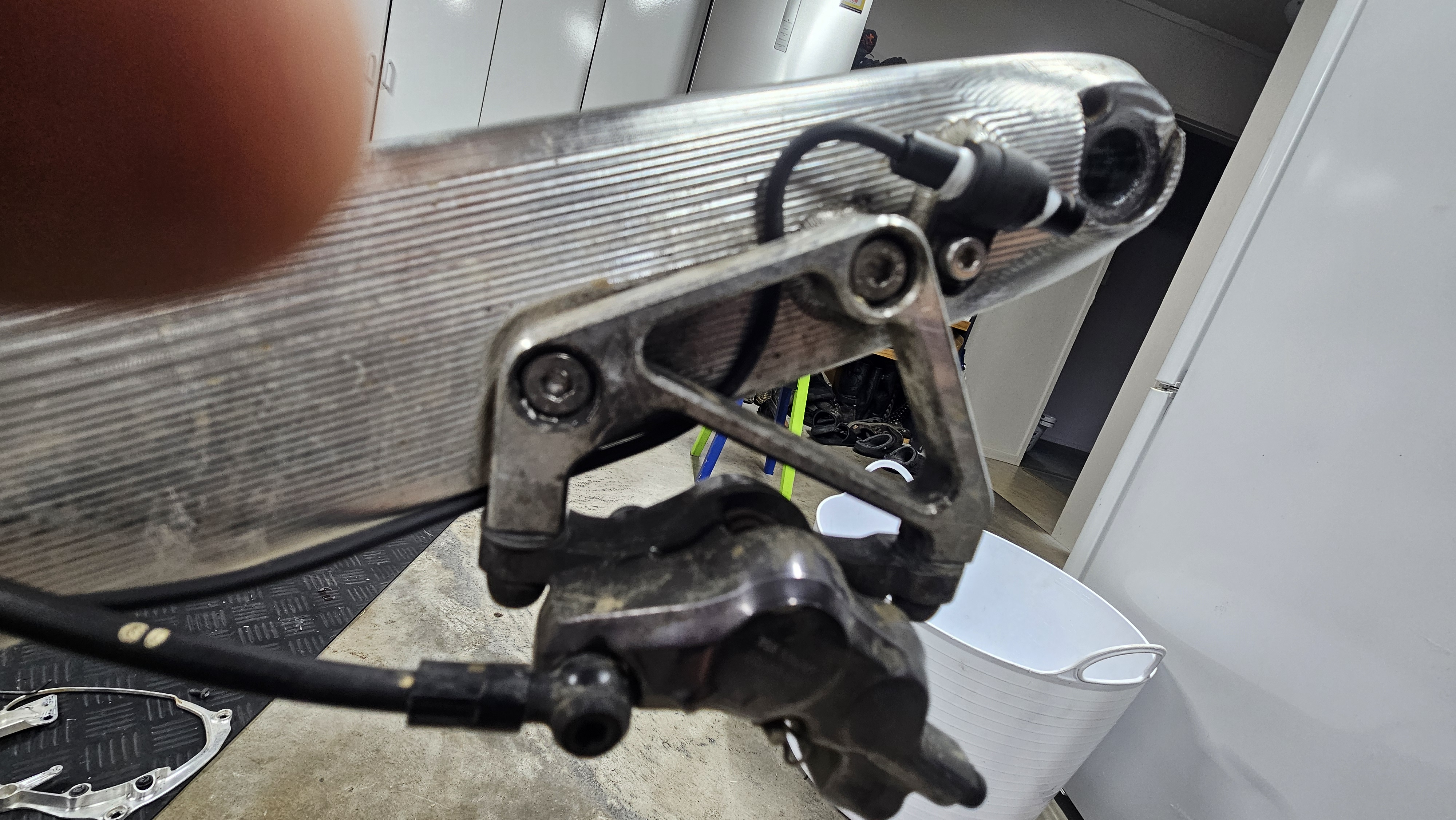

I'm thinking that it might be the pole routing of the sensor. It was floating close to he rotor, could easily be caught by a stick and or vibrate onto the rotor.
I've gone sneaky with this routing
I've gone sneaky with this routing View attachment 134575
That sensor looks much bigger than I expected compared to seeing a picture of one.

The mount that Mondraker use is much nicer than the crappy Bosch 'P-clip' style.
I'm wondering if it's rattling around and causing the failures.
Also, are your wheel bearings good and it's not the disc magnet hitting the sensor?
Bearings are good. But it's damn close. The one sided pole clamp is pretty average so likely it might be hitting. I'll do some closer inspection

What is the white stuff on the sensor??
The "P" clip that holds the sensor has a groove in its centre, into which the shoulder midway along the sensor fits, such that the sensor cannot move. This means the sensor can only be properly located into the "P" clip by opening the clip, installing the sensor and ensuring the groove and shoulder line up. If that has not been done the sensor will move and if it moves more that a bout 5mm it will cease to work.
