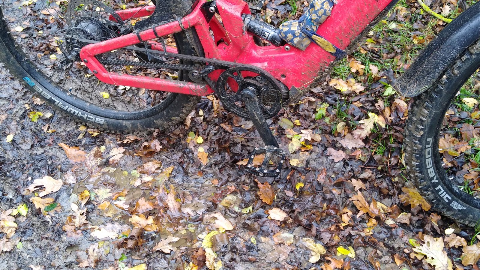

I have had my R&M delight mountain with Rollhof and gates belt for 3 months now Was desperate to get away from derailleurs and all the faff.
The Rollhof has electronic change which is superb and coupled with the Gates belt makes post ride cleaning a doddle , simple , gentle hose/brush down and Bobs your Auntie. Just what I wanted . It is heavy though but if you can fit it to a light frame things would be great.

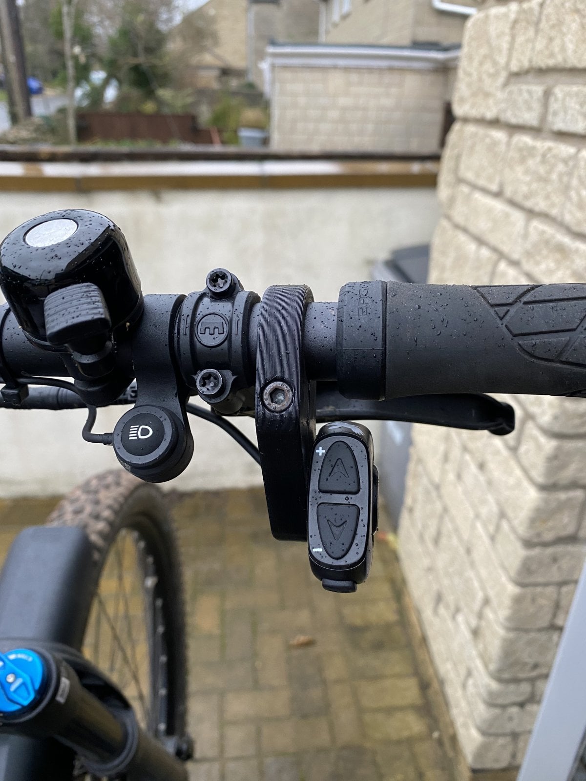

Another one here with an R&M Delite Mountain Rohloff.
So far so good. Ploughs through mud without clogging up the cassette and derailleur (as they aren't there!) and is generally at home wherever i have taken it. The only thing i miss from my Kenevo is the Ohlins coil shock, in every other respect this bike is better (for me).
The Rohloff is brilliant. 1st is as low as i'd ever need and i rarely go above 10th or 11th, but 14th has been used a few times on some long tarmac downhills. I relocated the rohloff shifter so it's under the bar rather than on the bar and that helps, but other than that it's as it came from R&M.

Verysideways. Hi. Interested in how you mounted the gear selector below the bars. I find I have to look down at the switch to be sure I press + or - which can be “inconvenient” on some occasions, with levers that was not a problem. Cheers
