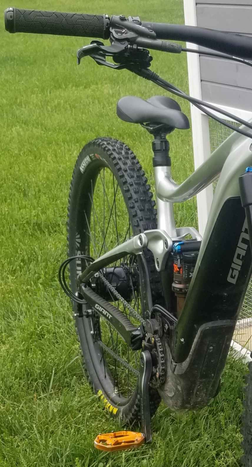

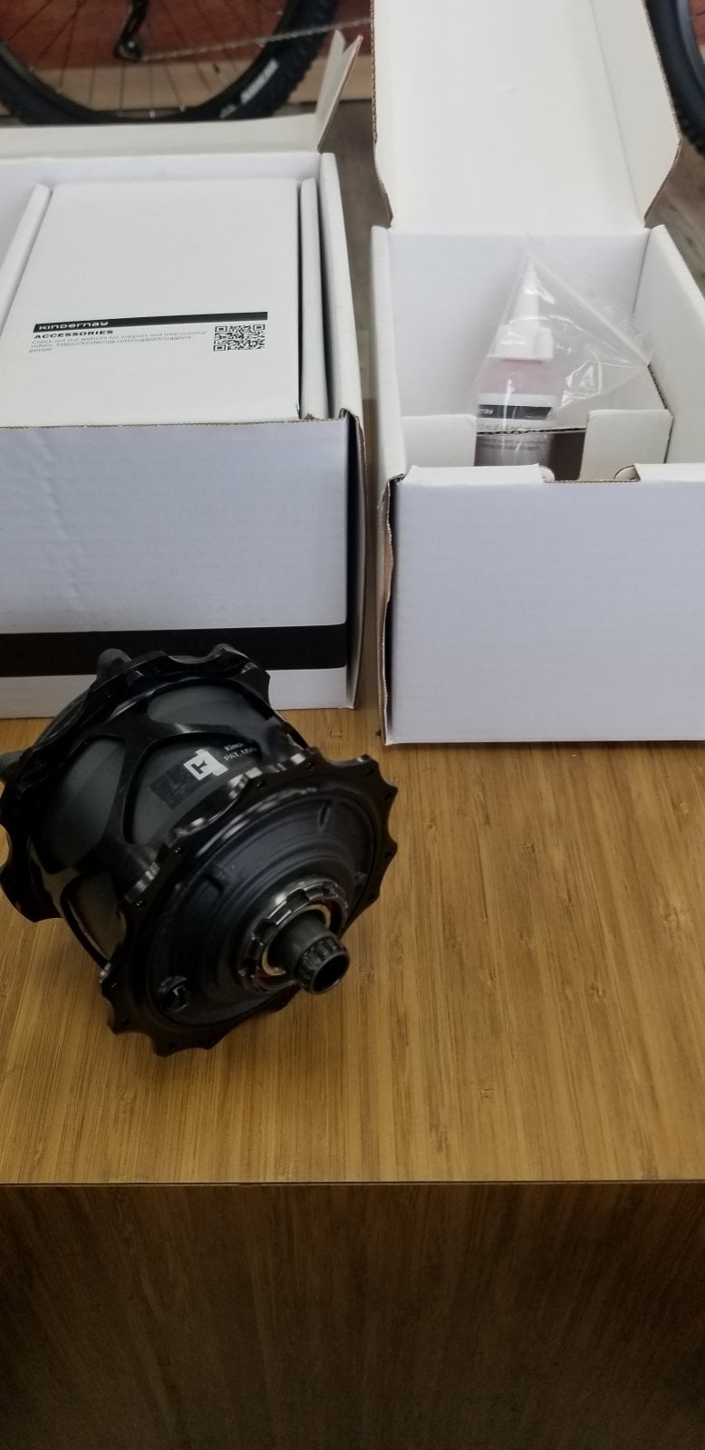

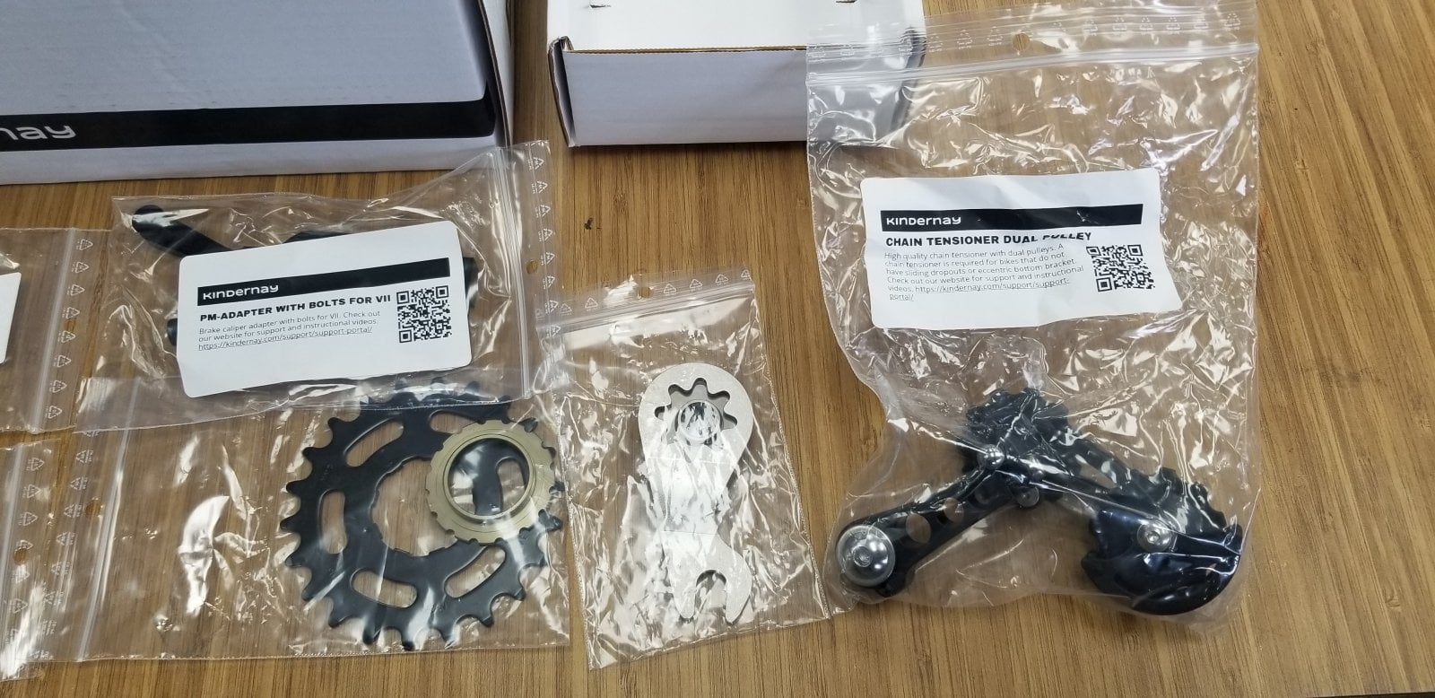

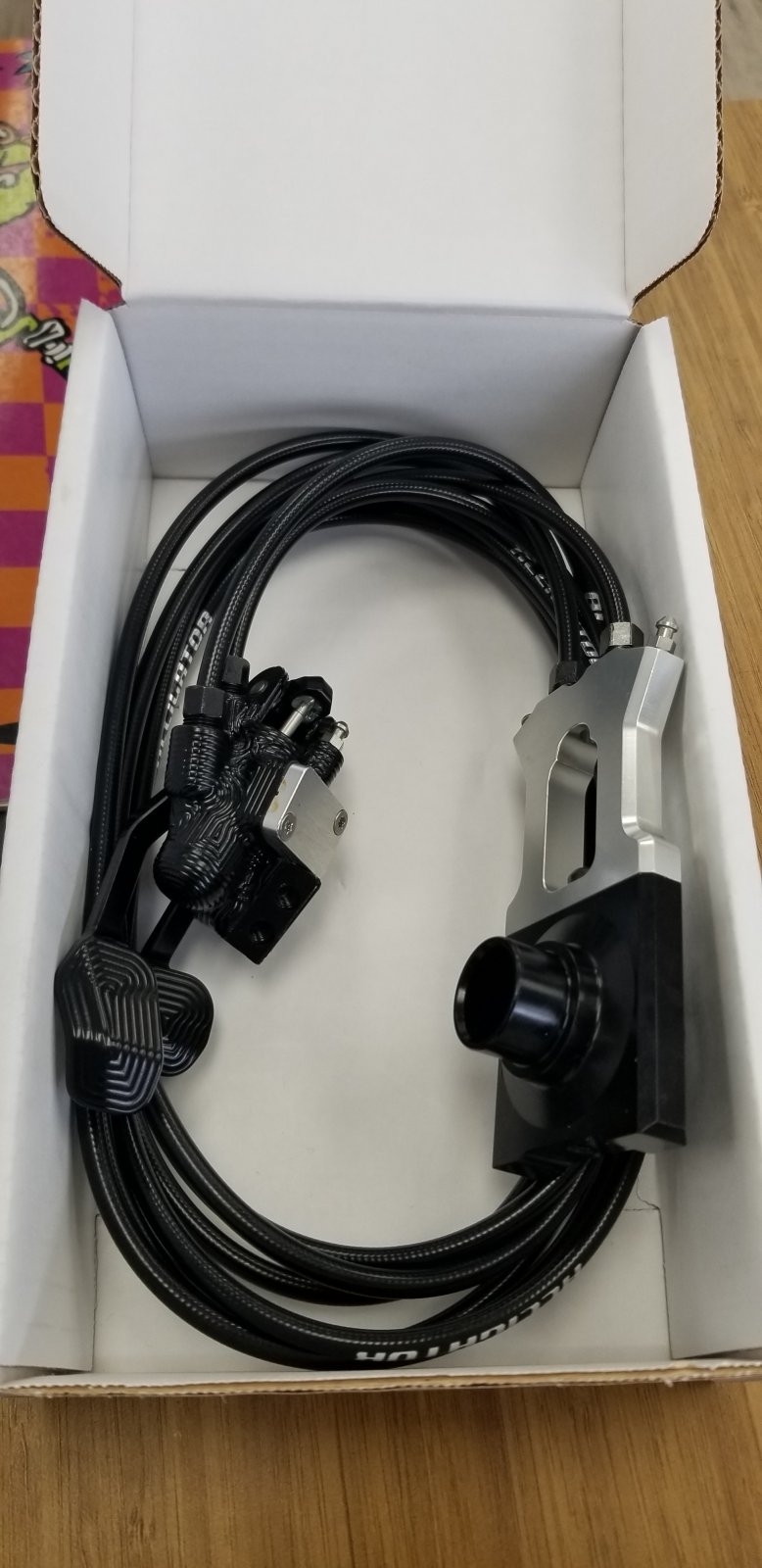

The Kindernay vii arrived in Louisville today. Pictures later.
Because I'm trying to create bomb proof, not fancy, I've decided to have the shop lace it to a Duroc 35, IF available, OR to an OEM spare hoop as second option.

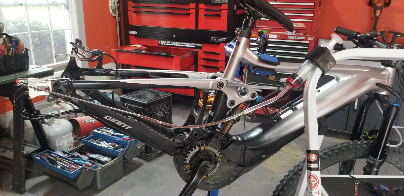

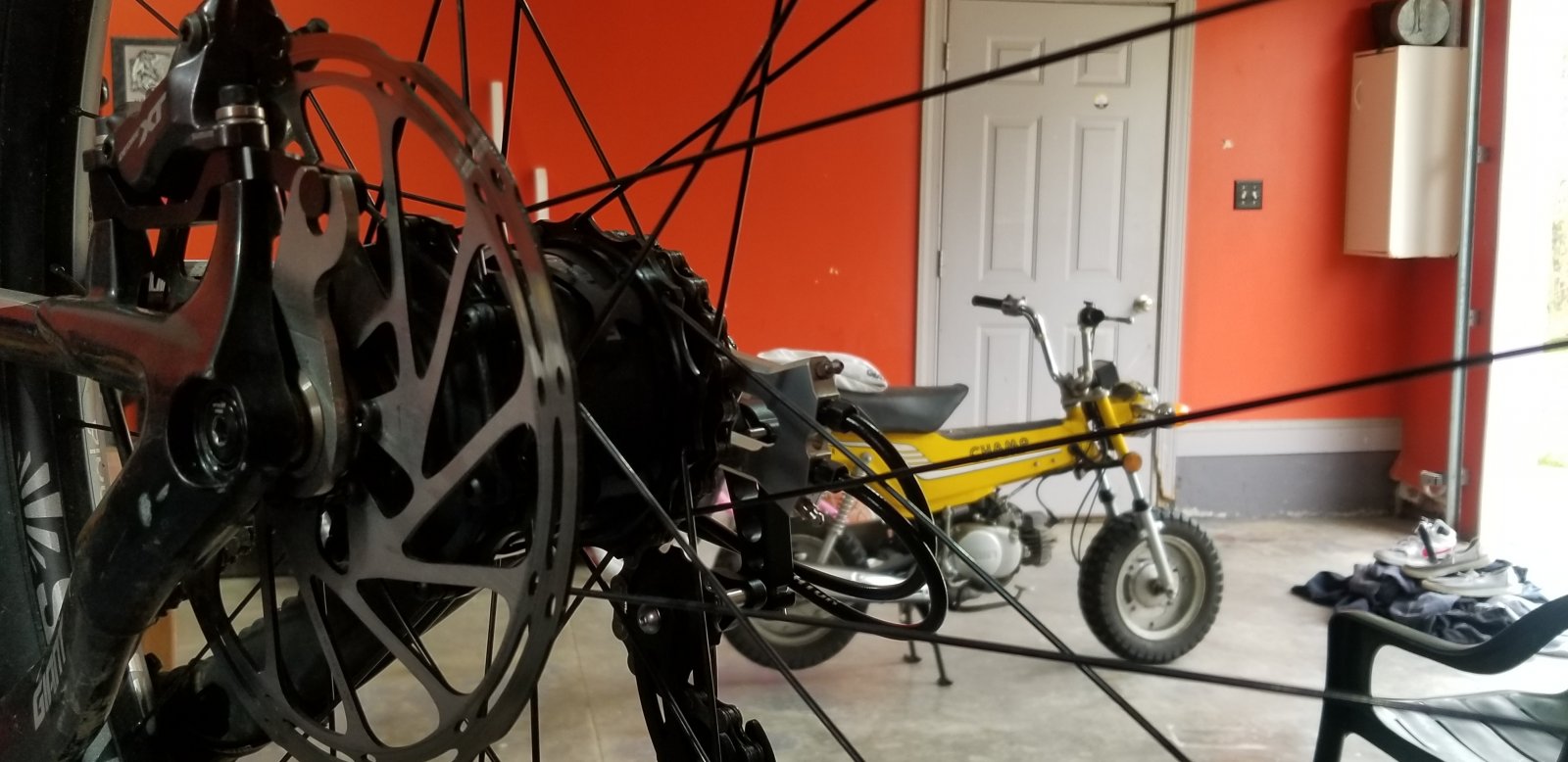

For anybody considering a Kindernay VII on a Trance X e+, some quick notes.
1) If trying to follow the OEM cable routing, the supplied cables will be too short. I have not yet figured out the correct length, or if following the OEM routing will even be possible- the hoses are too large in diameter for the Trance X routing, and a fair amount of Dremel work would be required. I have yet to fully consider the range of options available for hose routing, but It's safe to say that unless your happy to run the hydraulic hoses externally, this is not plug and play.
2) Get it installed and working, before splitting the hoses to run them internally. This way, you will know how a properly evacuated system is supposed to operate. We unfortunately introduced a gob of air in the system while splitting the lines, and this proved confounding to get out (hint: follow the instructions LOL).
Anyway, with the air out of the lines, and importantly the Onesie, the system has an almost digital feel to the shifter with the bike on the stand. See @knut7 's video reviews for a good description of the shifting action when peddling. It shifts pretty much exactly has he says. More later. My back is killing me 🤕

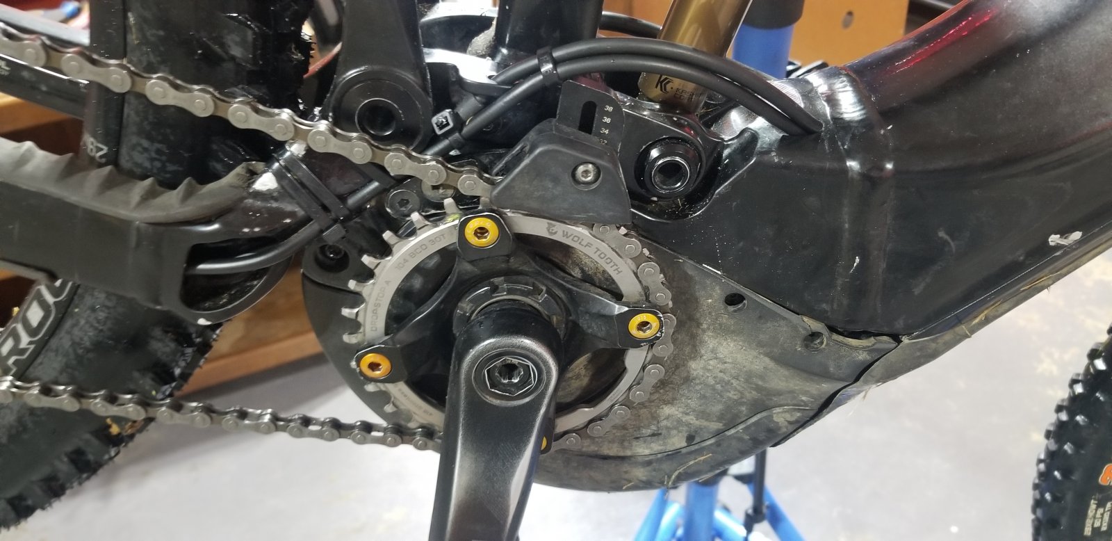

Nice. How are the hoses currently run at the main triangle? Getting them in and running them through the battery compartment should be doable on a lot of brands. The hoses could cause some rattle. Exiting the frame seems to be more of a challenge, especially if you want to run them through the chainstay. The hoses are actually routed through the chainstay on the testbike, which I ended up buying. But the rubber O-rings had to go. It will be interesting to see how much damage is done to the hoses rubbing against that metal edge. Seems fine so far though. I would probably run the hoses outside the chainstay and just fit a big chainstay protector if I was doing the conversion on my bike.
DrStupid
Jul 10, 2019
1,464
2,128
Pleasureville Ky
Right now, I'm running one hose excatly as the OEM shifter cable. That one is supernice 😊
The second hose is going over the motor, under the frame, and out the back circa 2019, to outside the lower chainstay.
The Trance chainstay grows considerably when the Maestro compresses, so I'm not happy with my routing. The hose gets pulled quite tight at bottom-out, and then festoons- for lack of a better word- down the CS just like my sciatic nerve, when the suspension returns.
I have no doubt this can all be done nicely enough on the Trance X. We have some messages out with Kindernay right now, concerning the possibility of a smaller ID. hose, that may make the OEM route possible for both hoses😎 hope springs eternally.
If needed, I'll pipe out the holes in the CS, and the Maestro link to take the two hoses all the way OEM style.

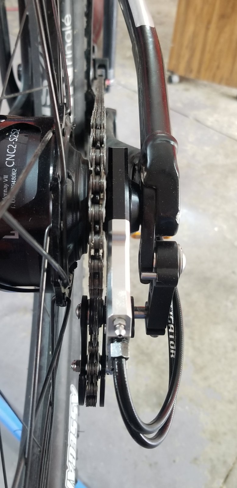

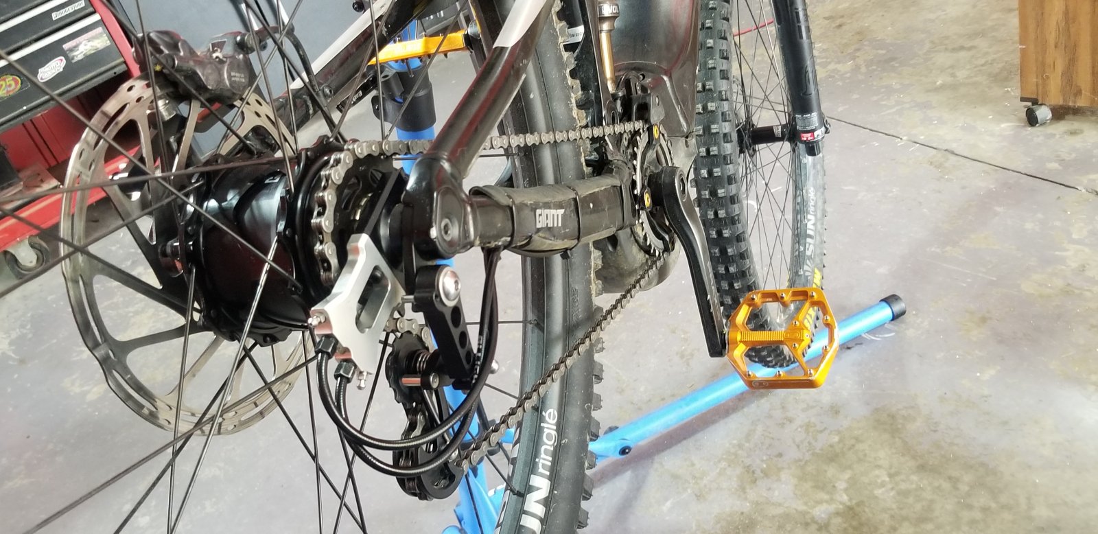

I had to void the Trance's warranty with a Dremel Tool, but managed following the OEM hose route.
There is still some work to be done, but it's beyond trail worthy at this point.
I am not able to ride hard,, but I can manage some simple trials stuff, and in those conditions the K7 maybe quite an advantage. The shifts are digitally speedy, and take place even while back peddling, with one caveat... the shift waits for forward pressure to be released from the crank.
Edit: Ride opinion notes-
The K7 makes a mechanical symphony of sounds,. If super quiet is your thing? Roll on. The claims online are that these get quieter with time, and it seems sensible. The 8 speed chain, Duroc 35 Wheel laced with beefy spokes to the K7 IGH, make for a solid feeling platform. It maybe months before I push it hard on the trail, but kicking around the place enjoying some balance stuff, the K7 is a hoot for joy riding.

Nice!
Kindernay claim a break-in period of like 500 km. The rough edges of the fresh cogs/gears makes the internals move less smoothly.
On the K7 we tested there were little noise. I've heard other claims about the hub being noisy, but I couldn't relate. On my K7 there is noticeably more noise on the higher gears. There is a difference in lever feel around the 4th gear when something is shifted inside the hub, this is where the noise starts. Not too bad, I'm waiting to see if it will go away after break-in before investigating. Seems there is a difference in noise between the hubs though.

interesting spoke pattern!
