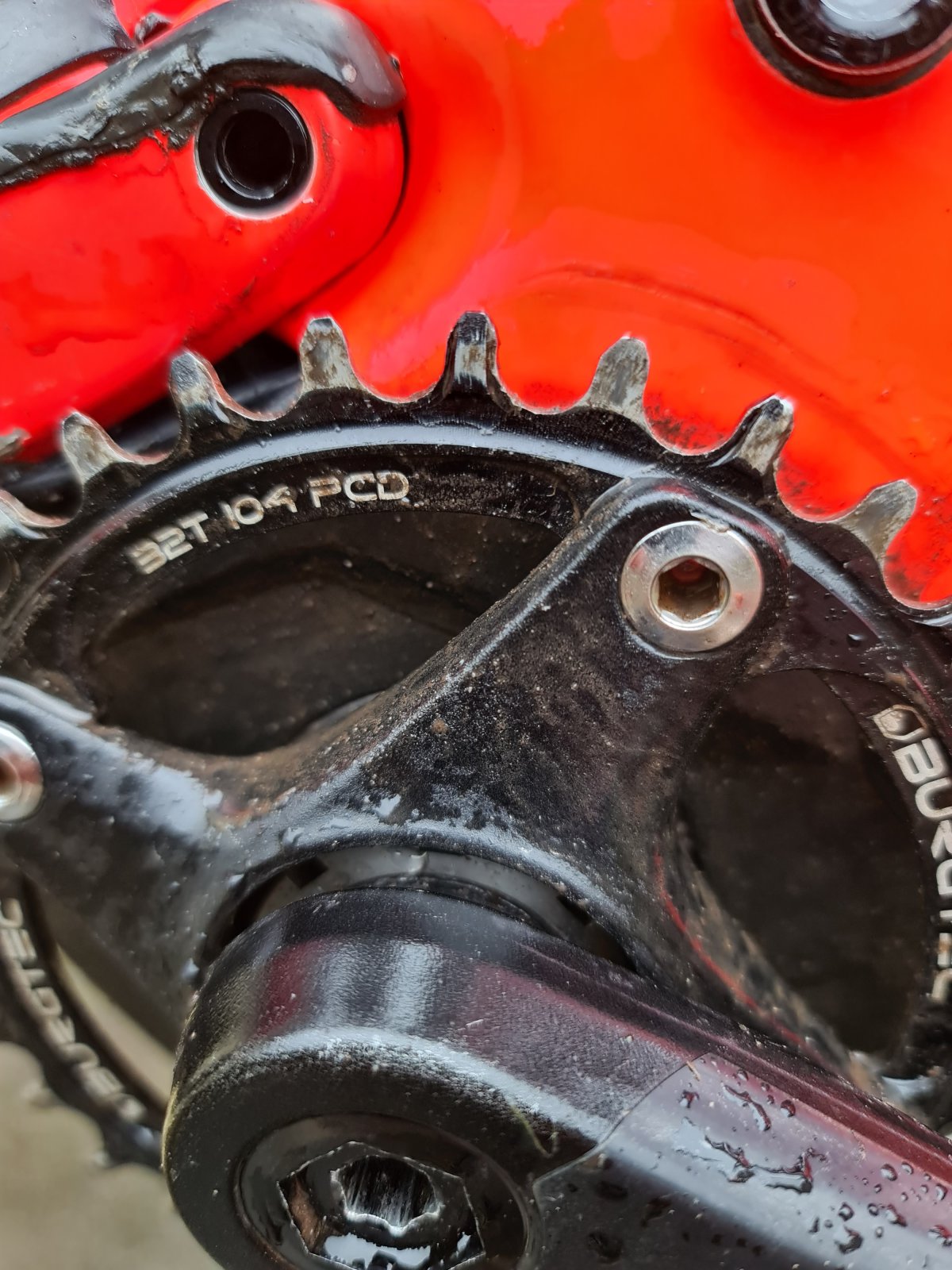

Looks like chain suck as chain coming off chainring at 6 o clock , burgtec crap only done 500 miles , gonna put praxis one back on , had to simulate load by holding back brake on whilst in work stand.

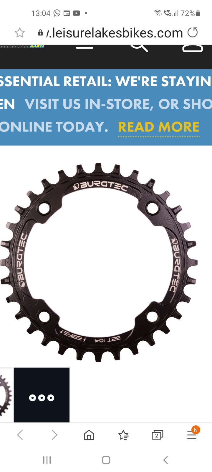

I reckon that chainwheel is so worn that the noise with a beat of 4 is the chain hitting the 4 arms of the spider. Below is what your chainring should look like!!

original praxis back on and its ok now, 500 miles on that burgtec is ridiculous , are hope any better or is it better sticking to a steel one, fancy going for a 34t
