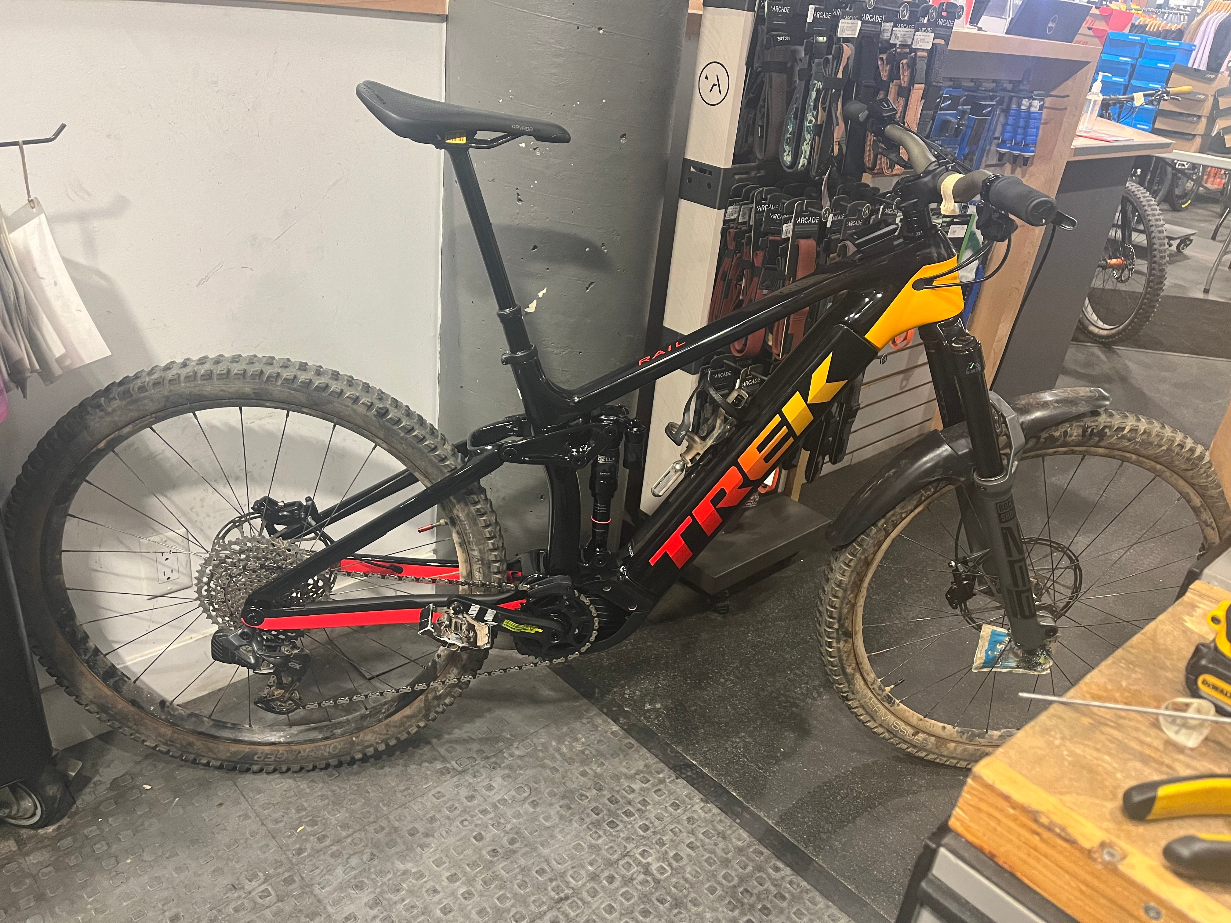

Whistler
I have a ‘22 trek rail 9.8 and I’ve been having never ending issues with it turning off while riding. After 5 rides on the new bike the motor had to be replaced because it died. With the new motor the bike consistently turns off on rough ground. Spoke to the trek booth at crankworks and they recommended starting a warranty claim, did the claim and they sent out foam pads for the battery. This didn’t fix it so they sent out all new rib mounting hardware, this didn’t fix it and made to worse.
Now they are blaming Bosch when the issue is clearly the battery moving. Bosch have rightly replied that it isn’t caused by them and they see a lot of issue’s caused by the rib mounting system.
Has anyone else had this?
Am I ever going to get a working bike or is the money gone?
