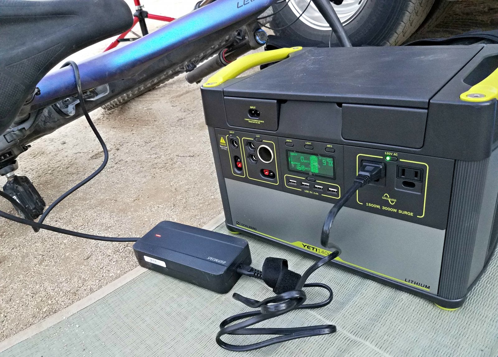

We use a portable Li-ion battery to recharge our bikes off-grid. The pic below shows our Goal Zero 1400Wh battery which after several years of use can still deliver ~1100Wh (enough to fully recharge two Levo SL bikes and their Range Extenders). We keep the Yeti charged from two 100Ah Li-ion batteries in our camper van and keep those topped up with two 100W solar chargers on the van roof (at least when the sun is shining).

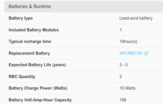

By looking at the APC website you can see it has an internal battery of 168Wh. Considering the transformation losses (UPS battery -> ebike battery), you can charge one 625Wh battery only to ~20%.
