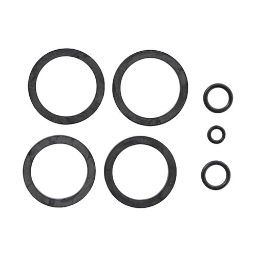

ive looked all over the place since this post for caliper seals but can only find a kit that includes the pistons. are the seals available as a set do you know?
Mikerb
May 16, 2019
6,523
5,002
Weymouth
aye thats the kit that has the pistons as well, I just need the seals.. but hey, at least ill have spares :D
Ah ok.....I read your post as you only being able to find the pistons but not the seals! I doubt you will find the seals on their own, complete kit is cheap enough so why put old pistons back in!!
why change them? you wouldnt do it on a motorbike or car, pistons rarely wear in my experience, they only fail because they corrode or get so covered in crap they cant be cleaned and knacker new seals.. ive rebuilt a fair few motorbike and car calipers but they are hefty old items, not like the miniature guides
Gary
Old Tartan Bollocks
Mar 29, 2018
10,496
10,702
the internet
It means... you are a very clever man noticing that big heavy motor vehicle calipers have bigger longer lasting seals... I have every faith in your ability to one day work out why tiny lightweight bicycle caliper seals and pistons do not last as long. ;)
Ps. If you're doing a caliper seal replacement I'd be tempted to just pay the extra £4 for the full piston and seal kit and replace your pistons at the same time... That way you'll be confident it's not a (burned the fuck out) piston issue.

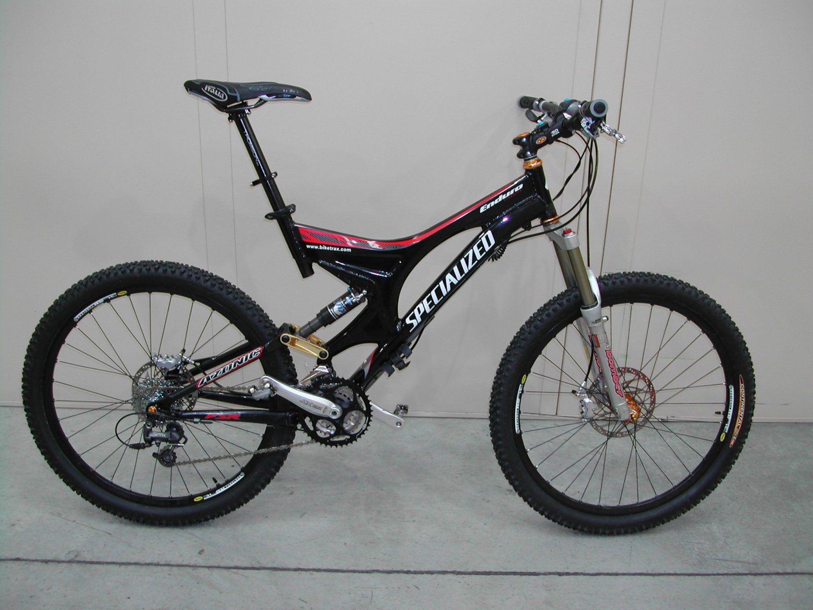

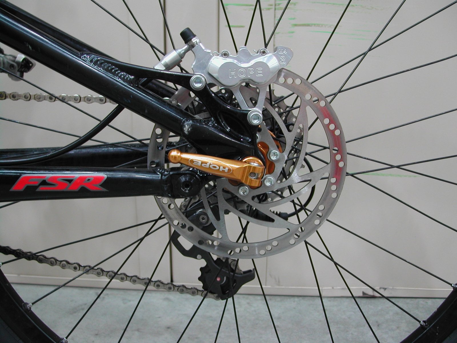

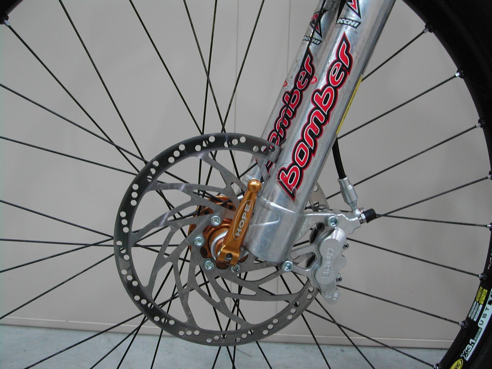

my old Spesh Enduro had Hope M4's (I think) they were fitted brand new in around 2002, I never once changed the seals or bled them since then to now, even after burning them up, I also never warped the discs...!
are the newer brakes just more highly strung and need more maintenance.. how often is it reasonable to change the pistons and seals etc?
Gary
Old Tartan Bollocks
Mar 29, 2018
10,496
10,702
the internet
My DH bike in 2001 had hope brakes (something similar to yours) which would often blow lever piston seals daily.
I haven't changed a single piston seal on any of my own bikes since I got rid of those.
So. no.
Do you think 19 years on your brakes might be having to work slightly harder?

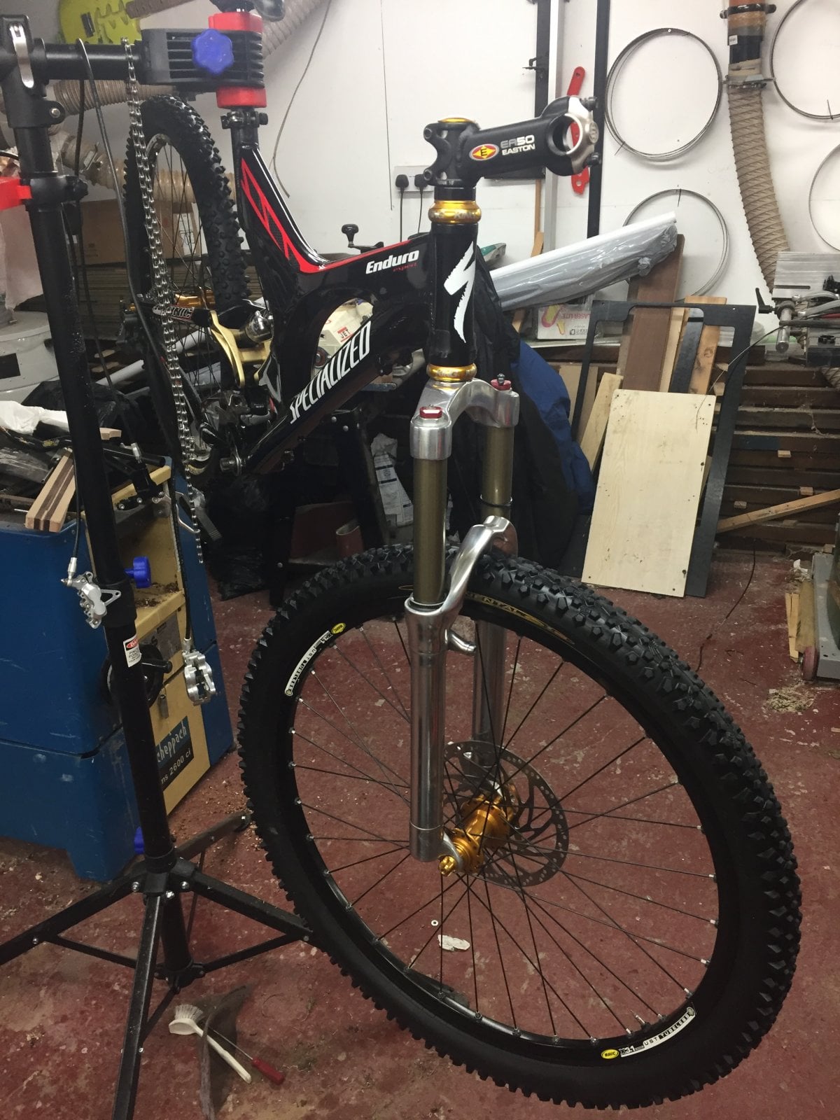

post a side on pic of the full bike will ya?
I have a soft spot for those old Enduros as I had the 02 SX for a while. The short travel supercross version. not the later long travel freeride/enduro thing
#264LYFBrah
my mate had an identical bike apart from a few components, we built them as we wanted them
this is the south downs, many years ago
dobbyhasfriends
🌹Old Bloke 🎸
Sep 19, 2019
3,254
4,642
Llandovery, Wales
cheers.
Awesome little bikes for their time
they were excellent, bought the frame and shock for £650 brand new, that was what they cost - im sure you remember.
I still have that bike and completely stripped it last year and it looks new, I removed the decals from the forks and mirror polished them. sadly the rear shock is beyond repair and ive been looking for a replacement just so 'if' I ever wanted to ride it, I could.
