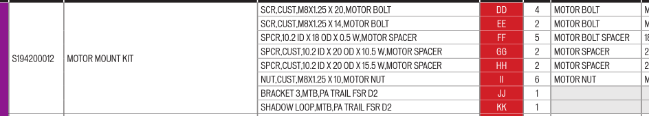

- Somebody here posted about their motor rubbing, so I ordered a motor bolt kit

Motor bolt kit is Spesh part number S194200012. I got mine from a US web site, but you guys should have some choices.

The new mounting hardware has arrived and I'm now wondering, do you have to replace just the bolts or do I have to replace all the mounting hardware as well on the actual motor ? To eliminate the creak while pedalling ? The latter will be an extremely difficult job

I don't mean this to be snotty! Ask yourself, if you replace only the bolts and the creak is still there when it's all back together, how angry will you be? Better to be thorough!
For me, the hardest part of the whole job was routing the dropper cable around the shadow loop (or whatever they call it). Dropping the motor all the way out and replacing the captive nuts doesn't add all that much more to the job..
Take a few photos of the assembly before pulling stuff apart. I thought I would remember what goes where, but I was mistaken. I had to redo a few steps.
Also, I used grease where the captive nuts attached to the motor housing. I greased every place a metal part touched another metal part as well as where the motor housing gets close to the inside of the frame. I did NOT want to do the job a second time!

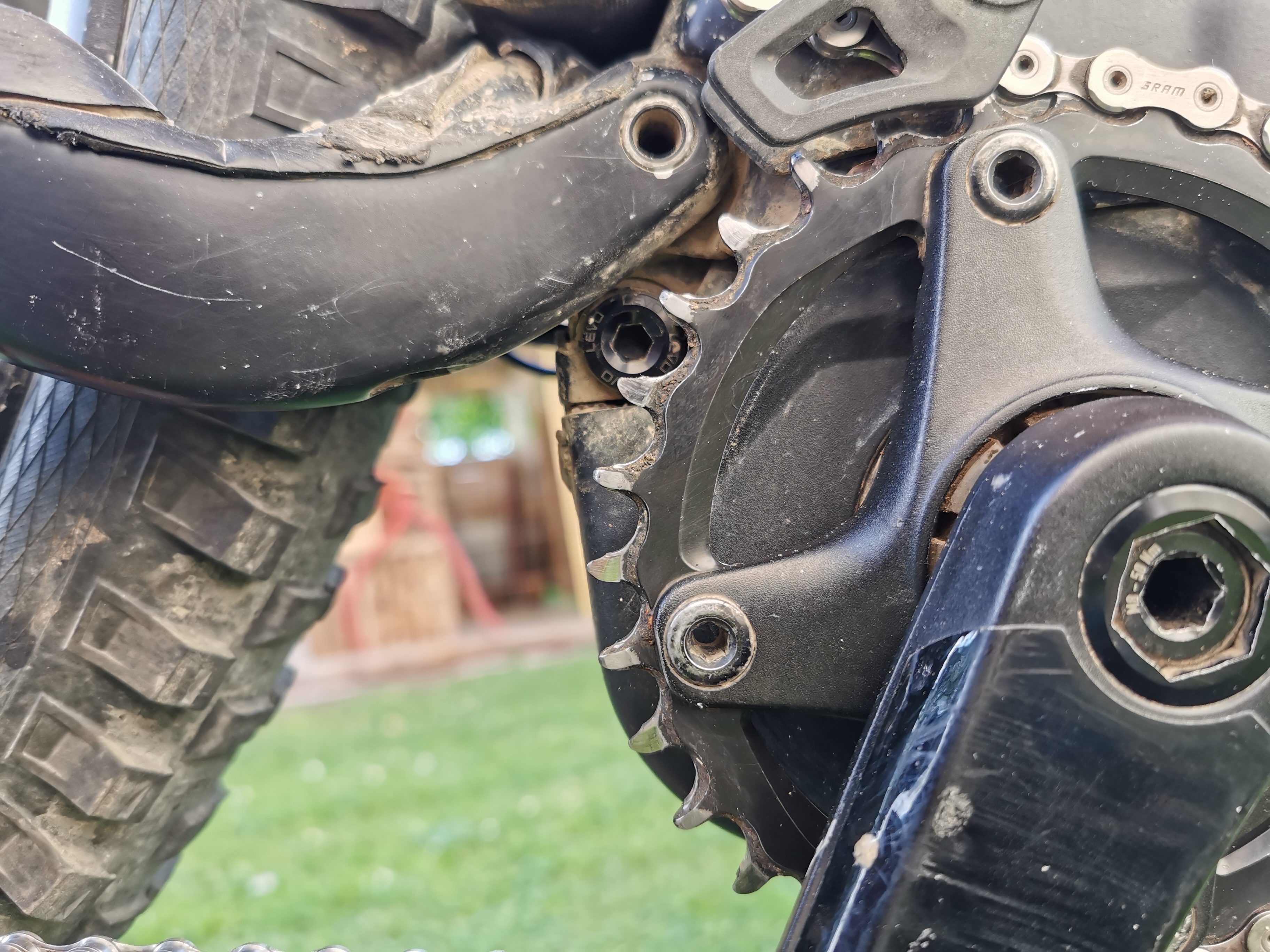

My Gen2 Levo developed severe creaking when pedaling, I tightened all motor bolts except the one on the right lower part of the motor which is inaccessible due to chainstay being in front of the bolt. If I let air out of the shock and compress the rear wheel to the bottom, will this make motor bolt accessible? Or will I have to remove the chainstay?

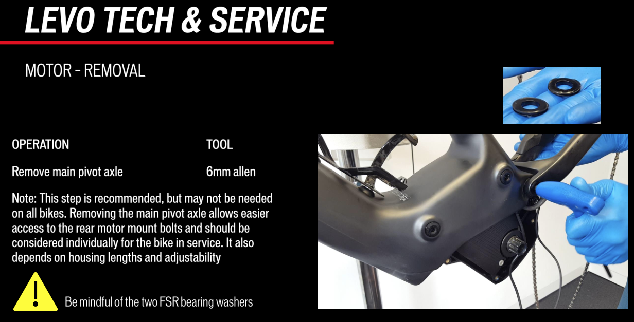

The service manual says some frames require chainstay removal, while others don't. My choice was to remove it because it's easy to do and it makes the rest of the job easier. You can clean and inspect the bearings while you're in there.
Like it says, watch for those thin washers! They'll stick to one surface or the other, then fall to the floor when you're not looking.

Today I removed the shock to be able to lift the rear end to the max travel to access remaining motor bolt and I can confirm, Gen2 Levo frame size L with 32T chainring the lower right motor bolt is then accessible, but just barely ... With 34-38T chainring it might be needed to also remove the chainring to access this bolt ....
