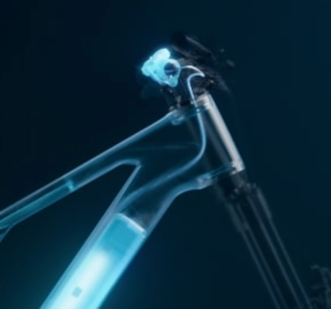

The first few rides the frame was silent, but not any longer. I thought the EP801 was loosening up. Nope, not yet. 180 miles and still no motor rattle.
The clacking/slapping sound is from the cables in the head tube area. The upper headset cover has four cables running through it into the headtube cavity (Shimano control wire, rear brake, dropper post and shifter cable). My carbon bars have the Shimano control wire rattling faintly, too. All of these bits need enough slack to not turn into tight, bike tendons, so cutting them super short is bad idea.
Enter the SpinBlock concern. I'll get to that later on.
Let's fix the noise first.
Is this an accurate depiction?
It's possible that the lines are striking the steerer tube and the sides or end of the downtube/headtube, depending on how long they are.
🔬 My in process, yet untested solution is:
#1 Stuff a length/chunk of soft open cell foam into the end of the handlebar to trap and silence Mr Shimano wire.
Remove the left handgrip, insert the foam. A second piece could be stuffed in via the right side of the bar to reach the fat section of the bar to avoid stressing the wire. Done.
#2 Entirely remove the fork leaving all cables in place on the bar and stem. The head tube soft foam(s) will be pushed in through the space left open by removal of the fork. Bearings in or out, no matter.
Attach/glue a soft shoelace to each piece of headtube foam to enable their future and inevitable removal.
#3 Fill the void around and behind the steerer tube to the battery. I'm not sure yet if the foam(s) will be placed against the frame to centre and isolate the cables from the frame or in one larger chunk in the centre to push them outward. Two or three smaller pieces will be easier to place than one big one.
Leave the shoelace(s) long enough for recovering the foam and tuck them in last. Pull on the shoelaces and out comes all of the stuff packed in there.
That's my plan.
That's my plan.

Hi Letteredrock
I have not completed the foaming as I described earlier.
I have had success in eliminating most noise by simply adding tape to the bars to stop the cables slapping on the lower back side of the bar. When the cables are pushed into the headset port deep enough to create enough clearance at the bars the slapping at the bar sound gets replaced by a much louder clatter from inside the headtube. Pushing the extra length of cable into the frame made the problem different and worse.
It sounds lazy, but wrapping black electrical tape to hold the cables to the bars has me reconsidering my plans with the foam because it's working so well.
