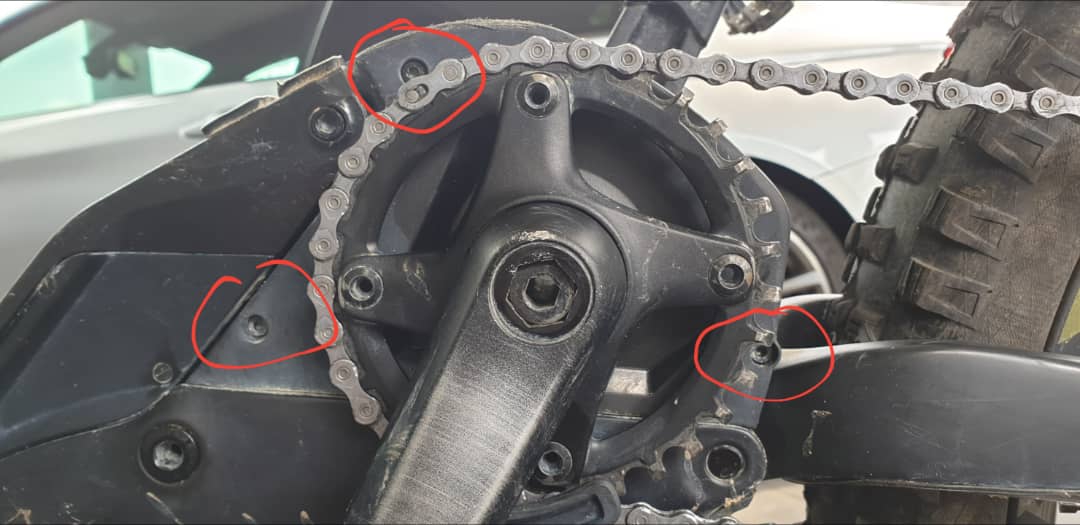

Sounds suspiciously like loose motor covers. Try tightening the three small bolts on the plastic motor covers on either side of the motor and see if it goes away. Mine tend to loosen up every three or four weeks and have to be re-tightened again. It's gotten so that I check them after every off-road ride to see if they are still snug. They are very small bolts so you wouldn't want to over tighten. Haven't ever seen any torque listing for them.
OMG I COULD KISS YOU. i dunno why it never occured to be to check those bolts....i tigthened everything else. u are right, all 3 were loose and spinning freely. in fact..the bolt to the leftmost...i cant tighten it...it just spins freely. but tightening the other 2 has stopped the creak completely
Have you tried blue loctite?
oh god..u dunno how much love i feel for you right now Jeff McD...may you never crash, may all your rides be bliss
Hey just glad I could finally help someone in the forum for once. I had the same issue when I was new to my 2018 levo, read this tip in a post and benefited immensely as well. The trouble is those are tiny little bolts and they tend to keep loosening. Easy to strip them which is what you might have done or perhaps the mechanic with that one bolt.

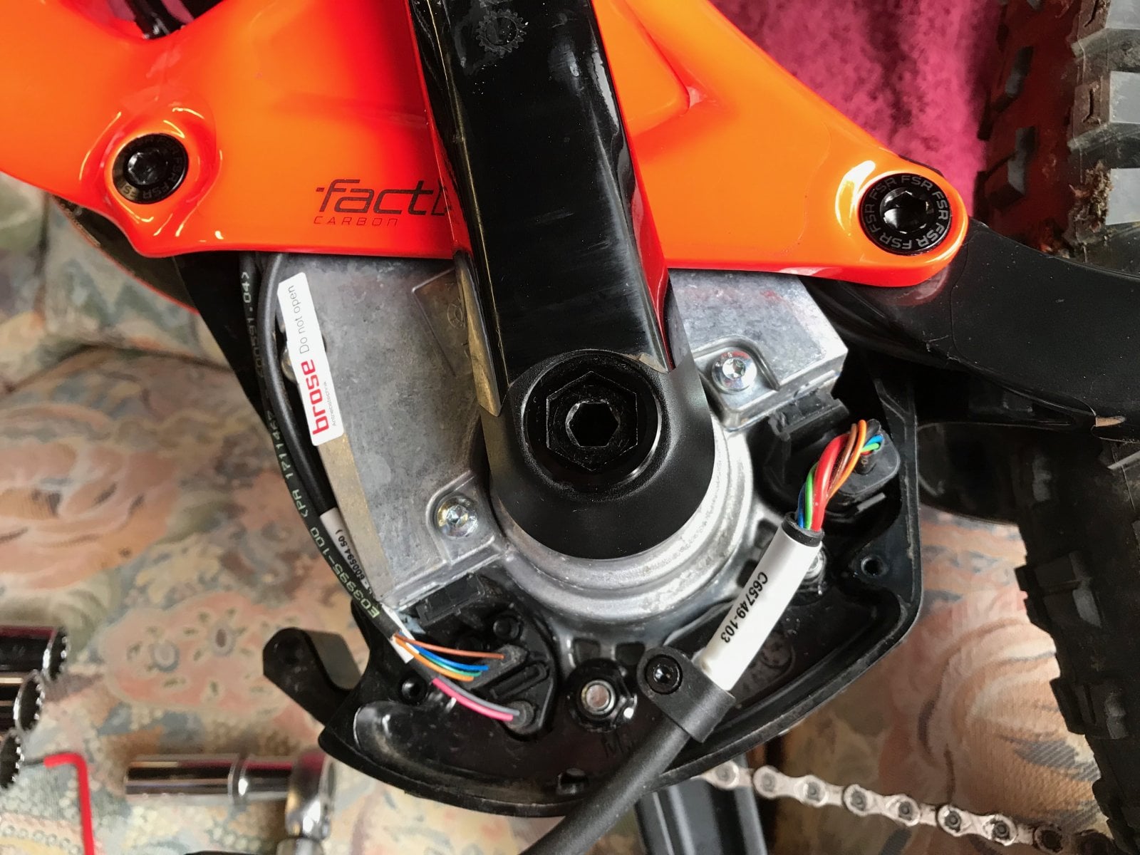

Tightened everything. Tightened plastic cover bolts. Removed non drive side cover. Removed battery. Really struggling to get to the bottom of it. Had the bike a week. It was not as pronounced as it now is. So noisy it's embarrassing and not a good advert for Specialized.

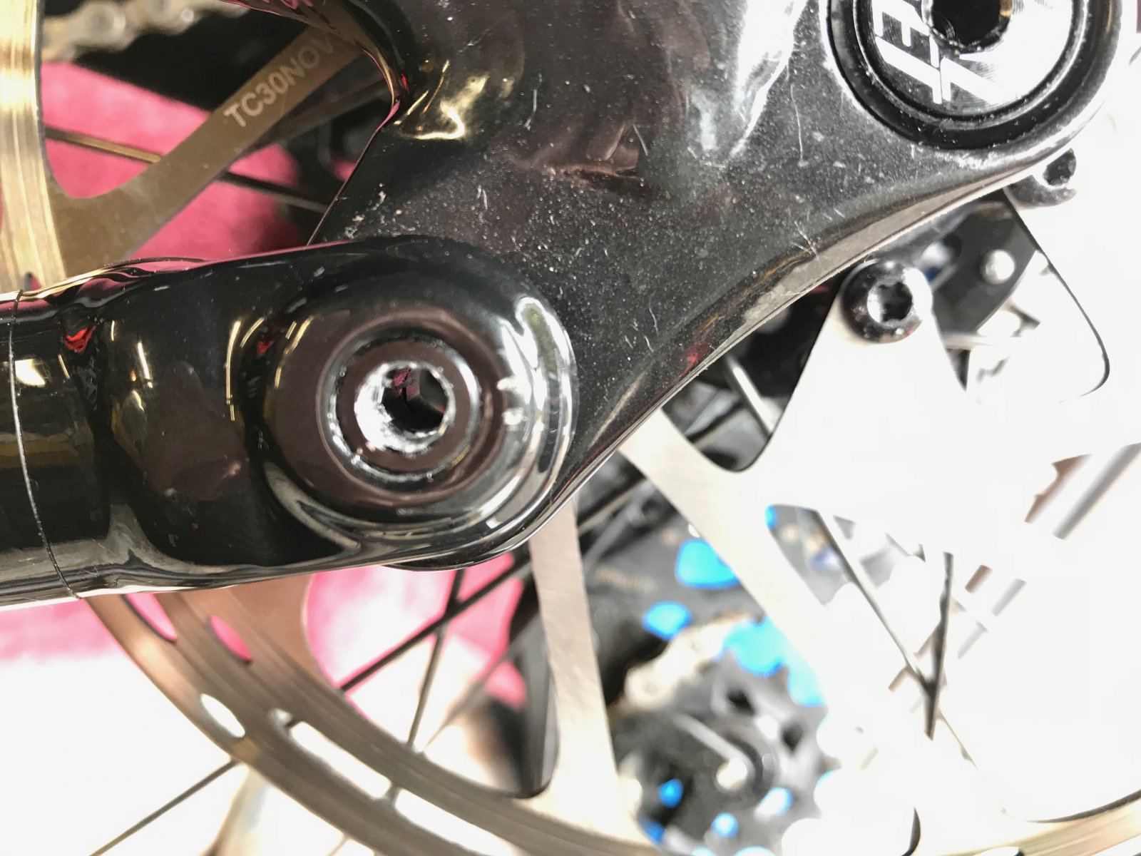

So the shop suggested tightening the 2 nuts that are visible by the wiring loom. Did that, no better.
It happens only when applying weight/pressure/torque to the left crank. Does it with the cover off. Couldn't take other cover off as I don't have the tools. Would be happy if someone could tell me which tools I need. (Puller and XLC 8 Spline Isis Bottom Bracket Tool which nobody seems to have in stock) If anyone can send me a link to a UK seller for the puller, I'll try and buy one)

2018 or 2019 model? If 2018 check the lower battery bolt that the battery housing rotates on when removing the battery. Mine was a bit loose. Check suspension bolts for rear triangle.
Also make sure pedal is threaded in securely and crank bolt is snug to 37 N meters torque. Otherwise I am at a loss. Not familiar with 2019 model.
Finally, since you bought it used, I would check the entire lower frame for tiny cracks. You never can tell.

So, spent the last hour refitting non drive plastic cover and crank and battery and then checking torques and tightening, where necessary. Got to doing the non drive side rear suspension chain stay/lower arm pivot at rear(near axle and have somehow managed to round out the hex. I figure they may be left and right hand threads respectively but it just kinda felt to crumble. I'm guessing it's alloy? (see photo)
I'm not touching it now till I've spoken to the supplying shop in the Midlands. I'm 2 hours away from them by car so a right PIA to take it back.
All in all, very disappointed with this bike and it seems it's kinda symptomatic of the brand.
Any suggestions on how to get the bolt out would be welcome but I suspect it will be going back to the shop.

Since you never did get a reply..or for the benefit of others.....that bolt is now scrap so get a bolt that is a comfort fit ( thread end )and araldite it in...obs wait for the araldite to set. Use some wd 40 to ensure the thread is not seized. Undo the pivot bolt using the hex of the bolt you have araldited in.

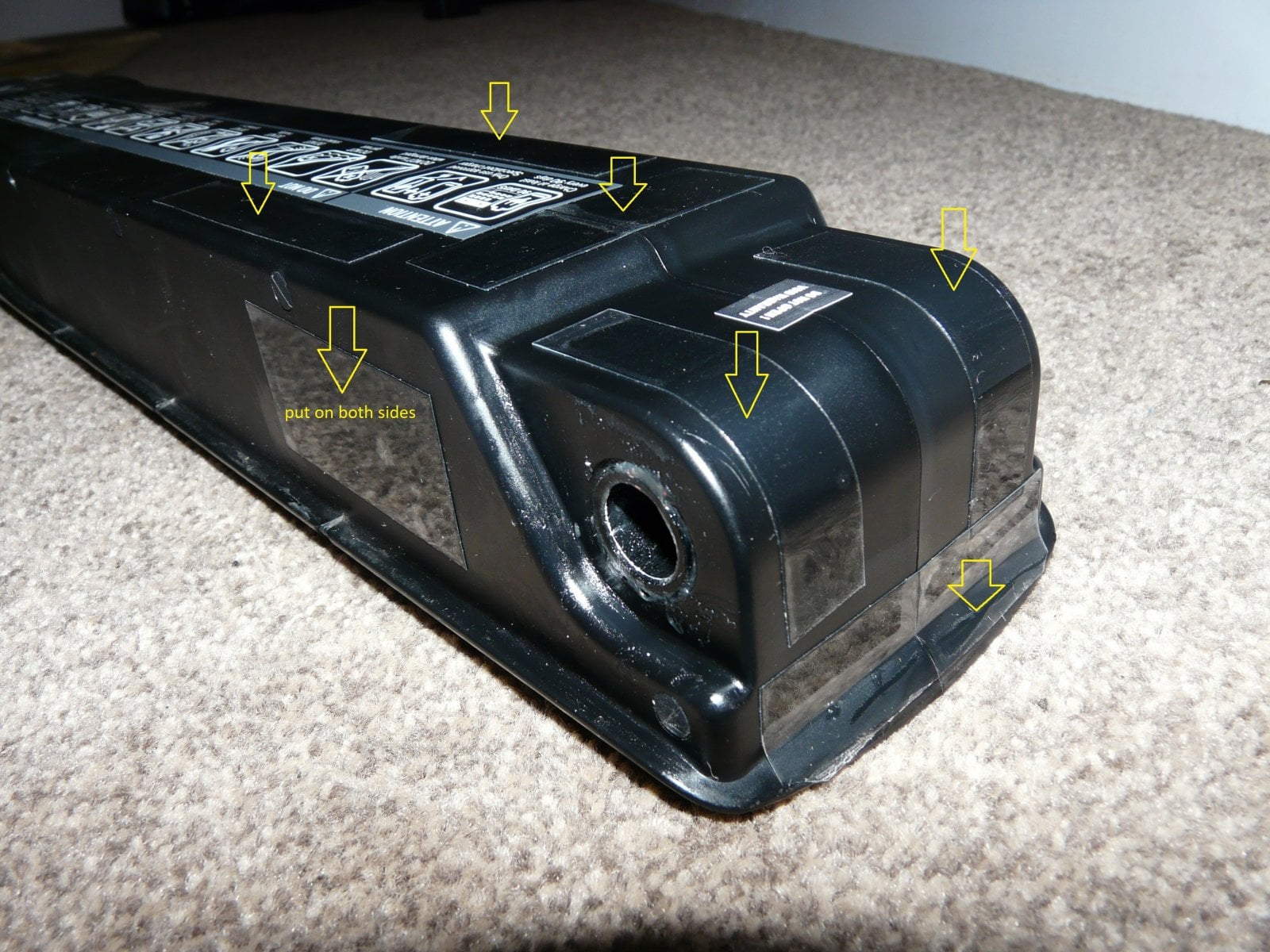

My creak/clicking was caused by the other end of the battery (to test if battery, take it out and ride bike and see if noise goes), where a lug fits in to recess on frame. Some silicone grease got ride of the noise but eventually it comes back, so I put a layer of insulation tape on the lug to tighten up the fit. Creak gone.
