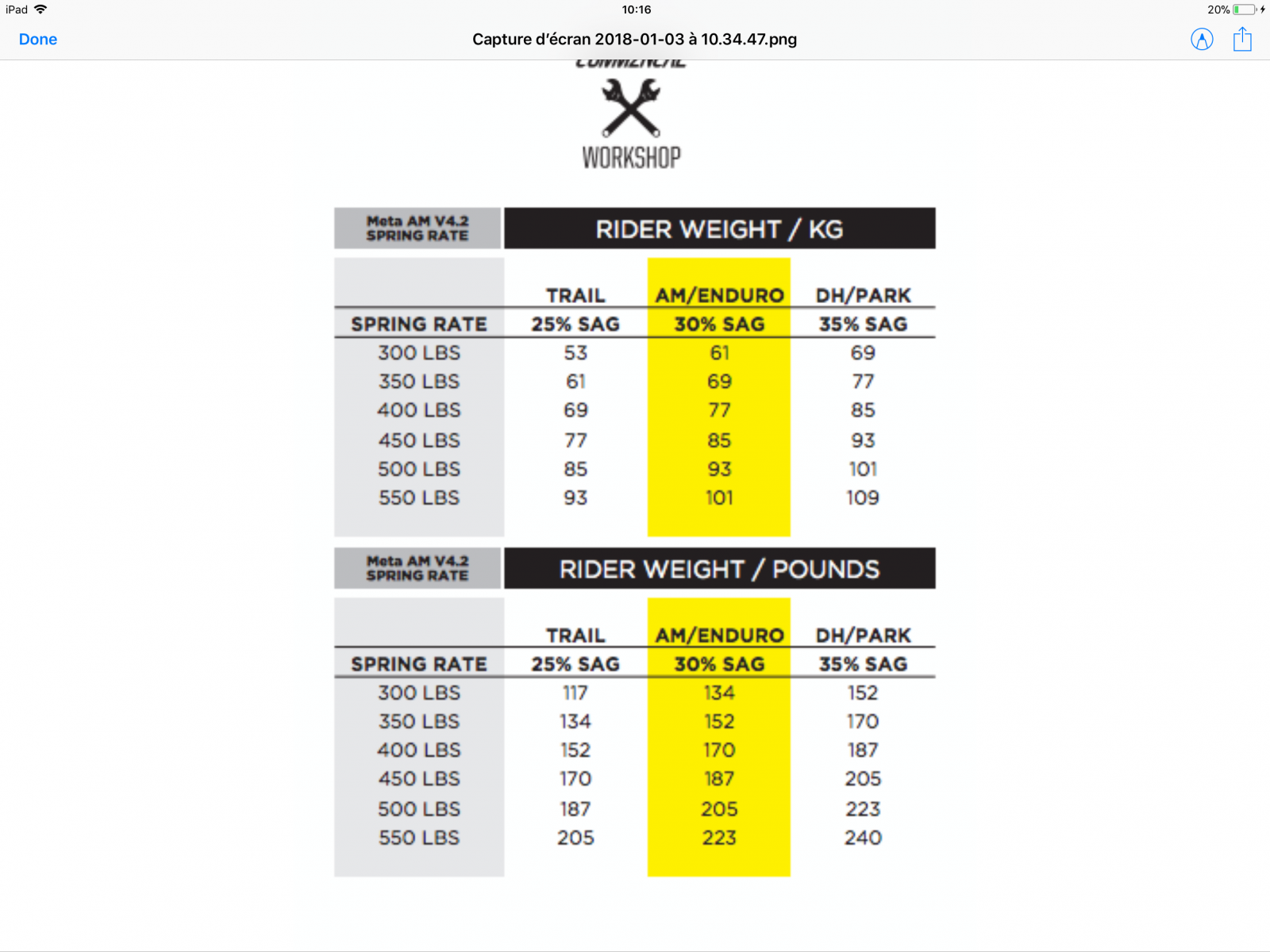

I was thinking the same not just because of the very strong spec you get for the price but also coil shock and easy to get the right spring wieght. Springs are only £25 approx so it’s not a huge extra cost to get the bike set up . You’ll also get a very strong quality wheelset that’s been properly specced for heavy use .

are 800lb+ shock springs really readily available?
Good thought , not sure ,I think the 650 spring would do the job , I have a 600 spring fitted which gives me the correct sag fully kitted for winter with no preload at all , I can use my 550 spring if Iam running light in summer . not sure how much more that 600 spring will take with some pre load but there is plenty available on the adjuster . I think it would probably do 120kg ok so if wieght was reducing as hoped a they list a 650 which would be fine I think . It’s also quite easy to get a custom spring made
But as you say Gary a hardtail probably suits the purpose much better especially for commuting

Pre-load is never a good thing kernow. it's always better to get a spring closest to correct weight with no pre-load as you have.
If I were in this position I'd def try to find the guy who does custom springs mentioned above and find out how accurate/straight his springs are and if happy with his work go for one (or possibly two).
I've had custom springs made in the past (Not because of being heavy but back when leverage ratios were very high and shocks were short stroke) quality ranged from really good to laughable.
I do believe that you cannot be that general about how heavy the spring is as it relatetes to leverage ratios and other factors on the specific bike. I do for example have a 2018 Turbo Levo with a Push Tuned Van RC from TFtuned and they advices a 700 lbs spring based on my 110 kg fully kitted and the specific bike. My preload is about 1 1/2 turn and just perfect. Much more preload and one will totally ruin the nimble feeling of a coil shock
Karsten
100%
rider preference, Leverage curve, suspension kinematics and shock tune (damping) and settings also make a massive difference to what weight spring is ideal.
The basic online spring calcs are just that. a basic (rough) guide. Most will get pretty close results for most riders though.
Karsten
I agree I understand all that , however Iam not being general , there is a spring listing for this shock based on body wieght and it’s been spot on for 5 of us who all bought these bikes , Iam only referring to the commencal models with the rock shock coil fitted , and the answer was , without complicating it too much for solepassenger who asked the question , yes you could have a full suspension ebike that would work ok with a 120kg plus rider with off the shelf parts
Here’s the spring chart commencal produce , the springs are available up to 650
