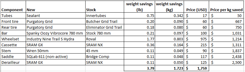

I went through this exercise on my aluminum SL. If you have not switched to tubeless that is the first thing to do and is dirt cheap. As others have mentioned the stock wheels and NX cassette are very heavy. If you don’t ride in sharp rocks or do big jumps you can also save weight with a lighter casing tire. You can get some light aluminum wheels such as the Trail S from Industry Nine for much less than carbon. The table below ranks some options by the cost per weight saved. Note that there are no carbon fiber components on the list.

I went through this exercise on my aluminum SL. If you have not switched to tubeless that is the first thing to do and is dirt cheap. As others have mentioned the stock wheels and NX cassette are very heavy. If you don’t ride in sharp rocks or do big jumps you can also save weight with a lighter casing tire. You can get some light aluminum wheels such as the Trail S from Industry Nine for much less than carbon. The table below ranks some options by the cost per weight saved. Note that there are no carbon fiber components on the list. View attachment 58962
you should expand your spreadsheet to include all of the avail upgrade options as I find it time consuming. :) I've been somehow holding off on the I9 rims.

P.S. The i9 wheels may have had the biggest performance impact of all my mods. Right up there with the AXS derailleur I am running now, anyway.

Hah! I only shared the cut down version. I also have weights and prices of different jockey wheels for derailleurs. I think I may have a problem...
