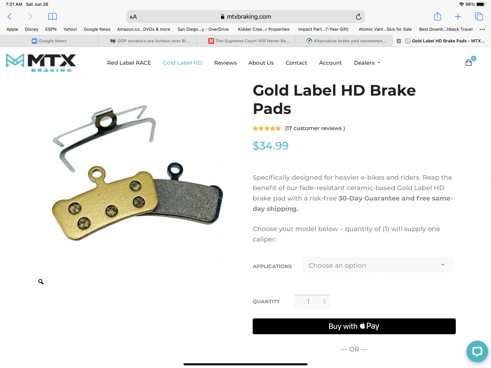

MTX Gold Label HD (GL131) pads are currently hitting-the-mark on the front while I use-up the stock D02S pads on the rear. (And yes, I can/have faded the D02Ss in the stock front setup, which is what prompted going to RT-M800s and N04Cs. YMMV, of course.)

MTX Red pads front and rear have been great and super quiet. Yes they are not full metal pads, but I've never had a problem on long descents.

I bought the MTX gold pads. So far so good. Excellent braking power with little to no fade.
