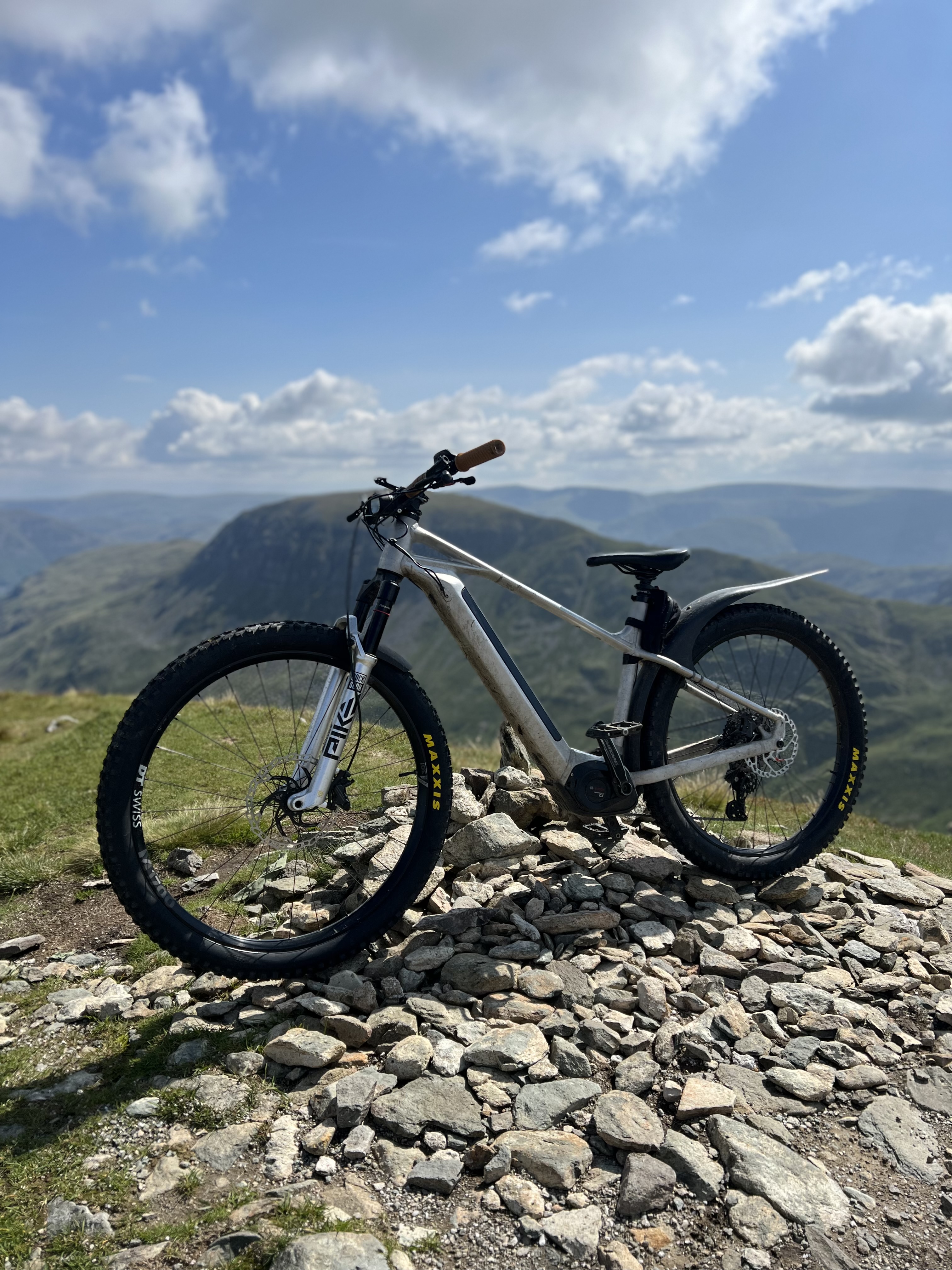

I feel ya! I think a nice slack enduro Ebike would do well, especially with the new Bosch SX motor.
I purchased a 2020 Mondraker Prime as it covers nearly everything I can throw at it, which also included towing a kids buggy behind it on epic.
The mondraker caught my attention as it was a couple of kg's lighter than the equivalent Cube/Trek etc. It is just a shame that nearly all HT have a 69* head angle...
I now run -2* angled headset, 120mm Pike Ultimate fork, mullet setup DHF 29 x 2.6 - DHR II 27.5 x 2.8.
This month I have done Dollywagen Pike and Sticks Pass as well as a 45km trek around Lady Bower Reservoir, including Potato Alley etc...
I may go up to 140mm on the pike in the future...

I should add that with the slight changes I have made the head tube angle is now 66* and if I where to extend the fork to 140mm it would be at 65*, although the seat tube angle is getting slack, currently at 73*.

Nice! Appreciate the effort you've put into that build and it obviously performs well too.
I've not seen the Prime before so I'll have a look into it.
it's a shame there is nothing out there slacker, Guessing putting anything over a 140 would make it pretty unrideable other than downhill?
That calculator is super handy too (y)

Nice rig! Have the same bike and if sure handles it well above its purpose. Good idea with the angled headset. Which one you have? Thought of trying the one from works components EC44-ZS56
