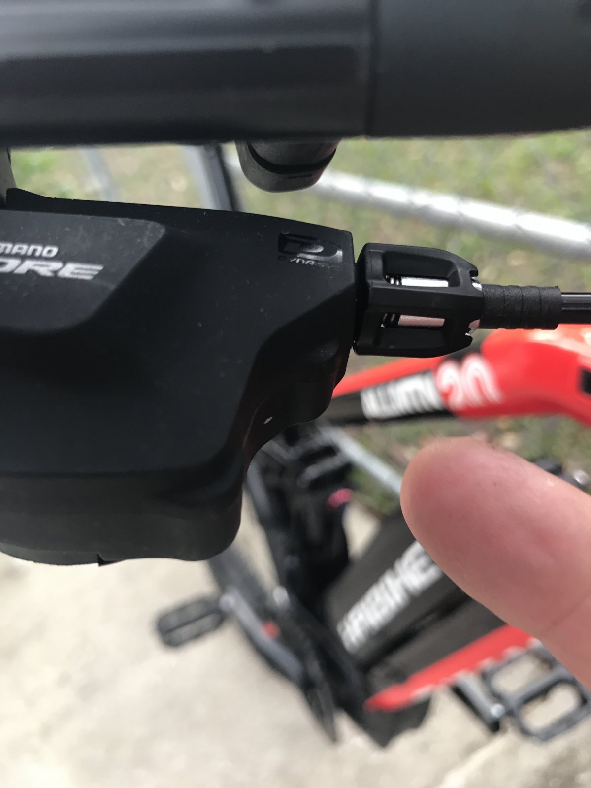

Hello, from Florida, my brethren. I went for a ride the other day on my Haibike all mtn 2.0 and it was a gorgeous day....High 60’s (18.5c) and just enough clouds to offer some shade.
I was super stoked for my ride and took off. My bike has Deore shifters and dearaileurs.
About a mile into the ride, and at about 190 miles total on the bike, the chain started making popping sounds and the gear wound change, the another revolution or more it would repeat.
It is my belief that there has been some chain stretch and shifter wire stretch. I think that’s what’s happening.
On my road bike, a giant defy ther is a barrel nut that can be turned to correct this. I do not see on my bike ?. I see an adjuster up at the shifter.... but?????
Question is: Can one make quick adjustments on the trail to EASily fix this problem and not ruin the ride.
That beautiful day I limped through 4.4 miles. Worrying that I was gonna break something—when your are applying gorse to the pedals and it “pops” that is a bad feeling.

Yes, you can adjust the barrel adjuster on the shifter as you ride. As soon as you think about it, you can't remember which way though ... damn... ... I think it's if it's crap on it's changes up (to the small gears), rotate it towards you a small amount ... test again, rotate more if necessary. Likewise, if it's crap changing down (to the big gears) , rotate it away from you.
The cable can stretch, or sometimes just get caught up a bit in the suspension movement or where it enters the frame and things get tighter.

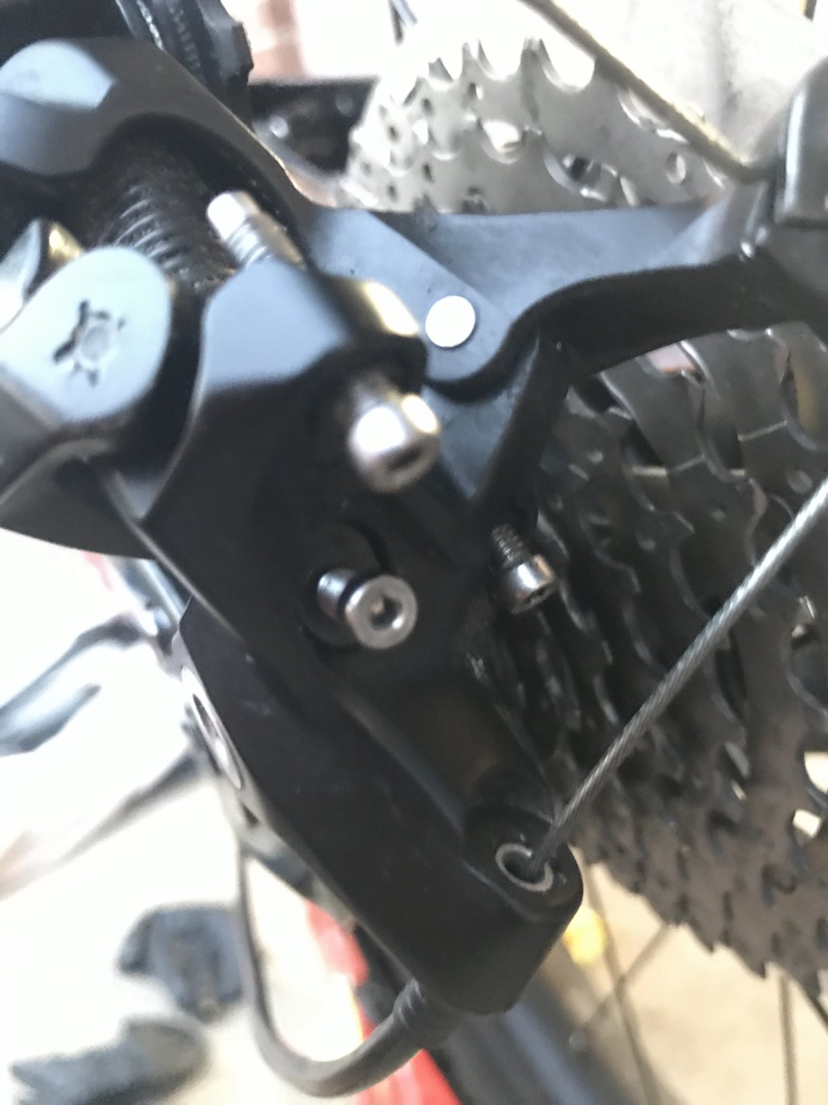

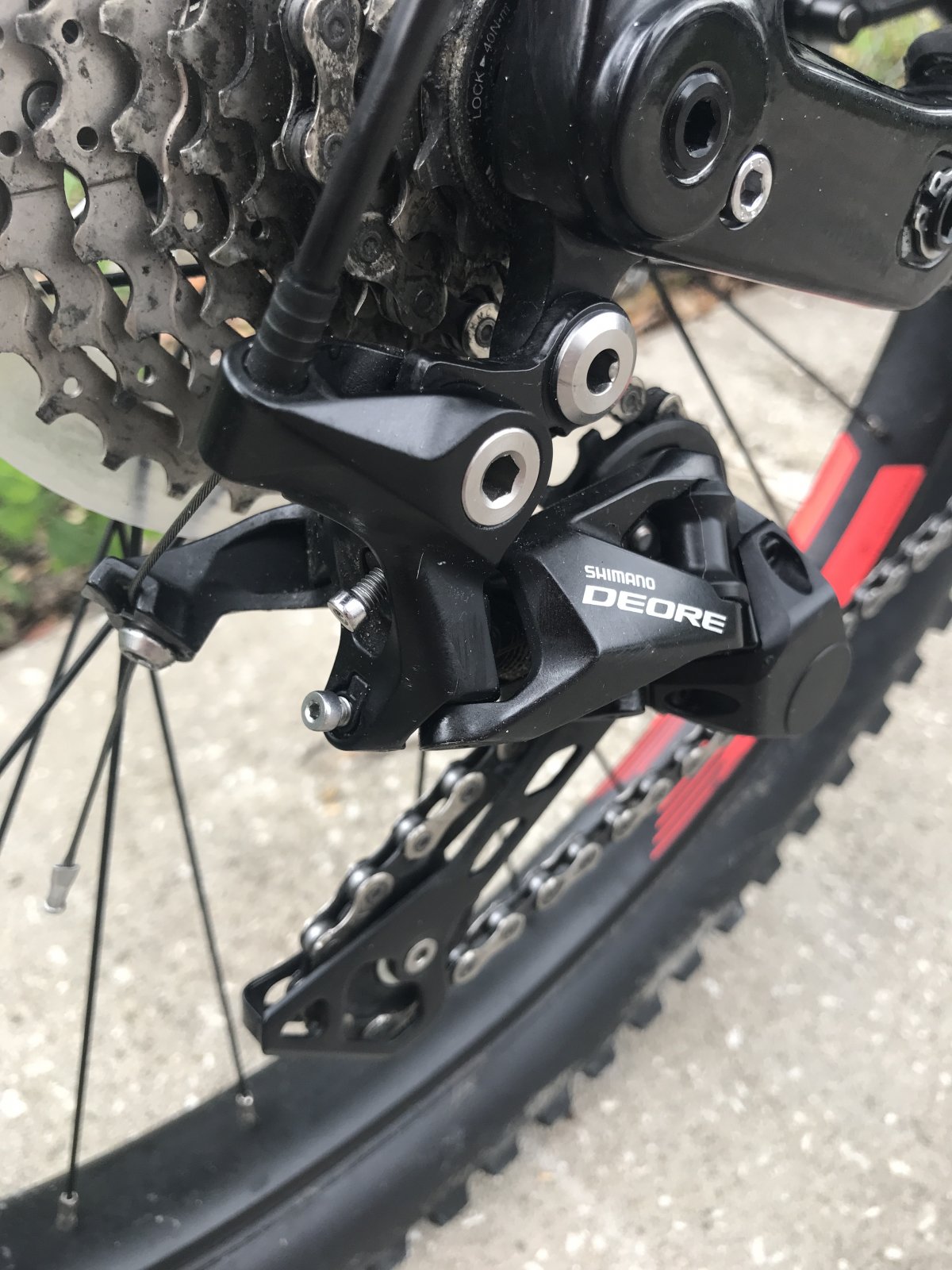

What I determined is that there was one link that goes through the jockey wheels and over the cassette poorly. So I ordered two chains.
And all the tweaking I did was for naught— well not exactly, I did learn some things through trial and error.

B tension.
Suggest you watch a YouTube guide on setting up a mech.
