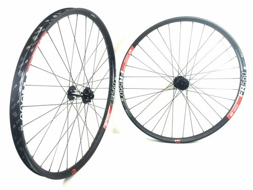

DT Swiss HXC might be a good alternative but not sure if they are worth the extra money.
These look bullet proof as rated ASTM 5 - E-Deemax S30 29 - E-MTB - Wheels - MTB | Mavic
As a good packup pair, these are good value.
FR560 is a very tough rim - FR 560 | DT Swiss
and the 350 hub is very reliable.
