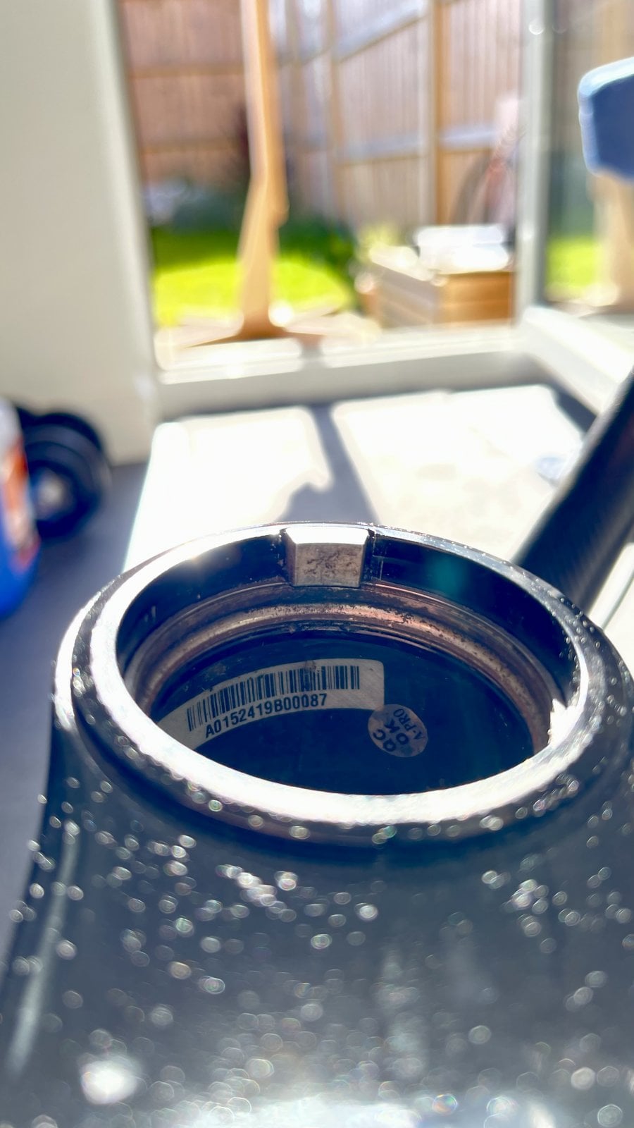

Hi, I’m new to this emtb-ing.
I bought my secondhand decoy a few weeks ago, been out a few times and my new shred is awesome.

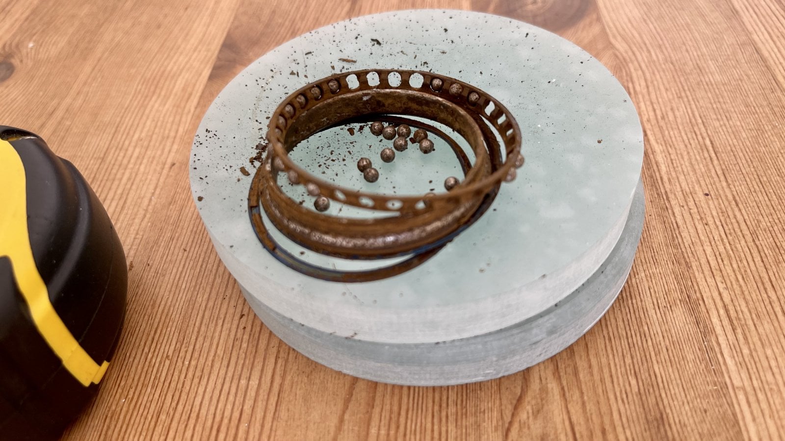

I’ve noticed I keep getting a creaky noise from the headset area so thought I’d investigate. The upper bearings are smooth and not dirty, the lower ones. Well they’re totally shot which I’m gutted about,
I’ve ordered a new bearing set but my issue is how the hell do I get the bearing cage out as the lock block is in the way.
Any advice would be really handy cheers

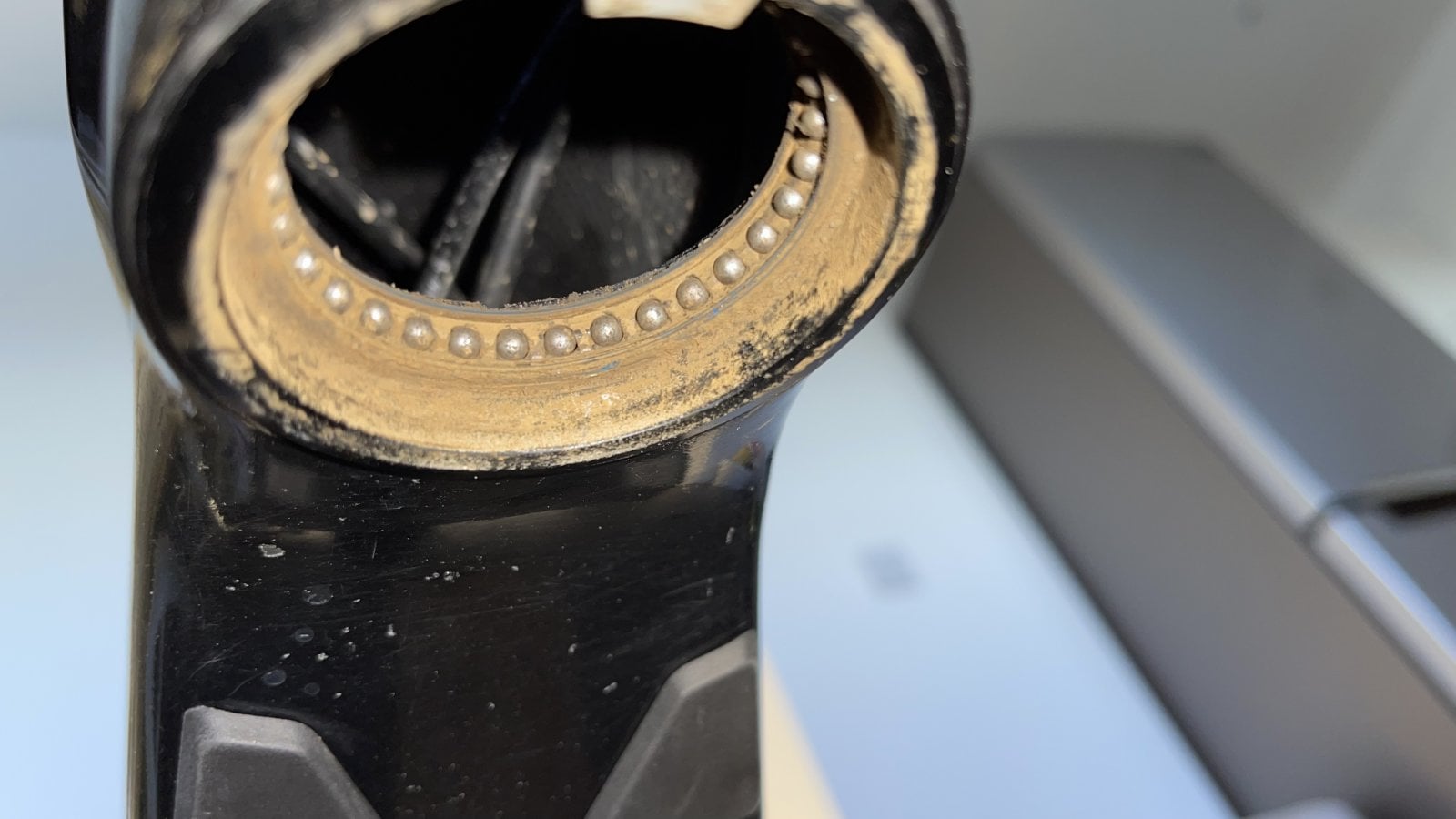

This is exactly what I was afraid of. I gotta wonder what the engineering advantages were supposed to be.
Eighteen rides in and wicked headset creak. Greased everything and creak resolved for one ride so far. Fingers crossed because when it happens again I'll be installing a new headset. Haven't pressed one in for years, but oh well

I had this issue yesterday, bearings everywhere but ended up finding all the bearings and putting it back together otherwise I wouldn’t have been able to ride on our trip. Silly design
