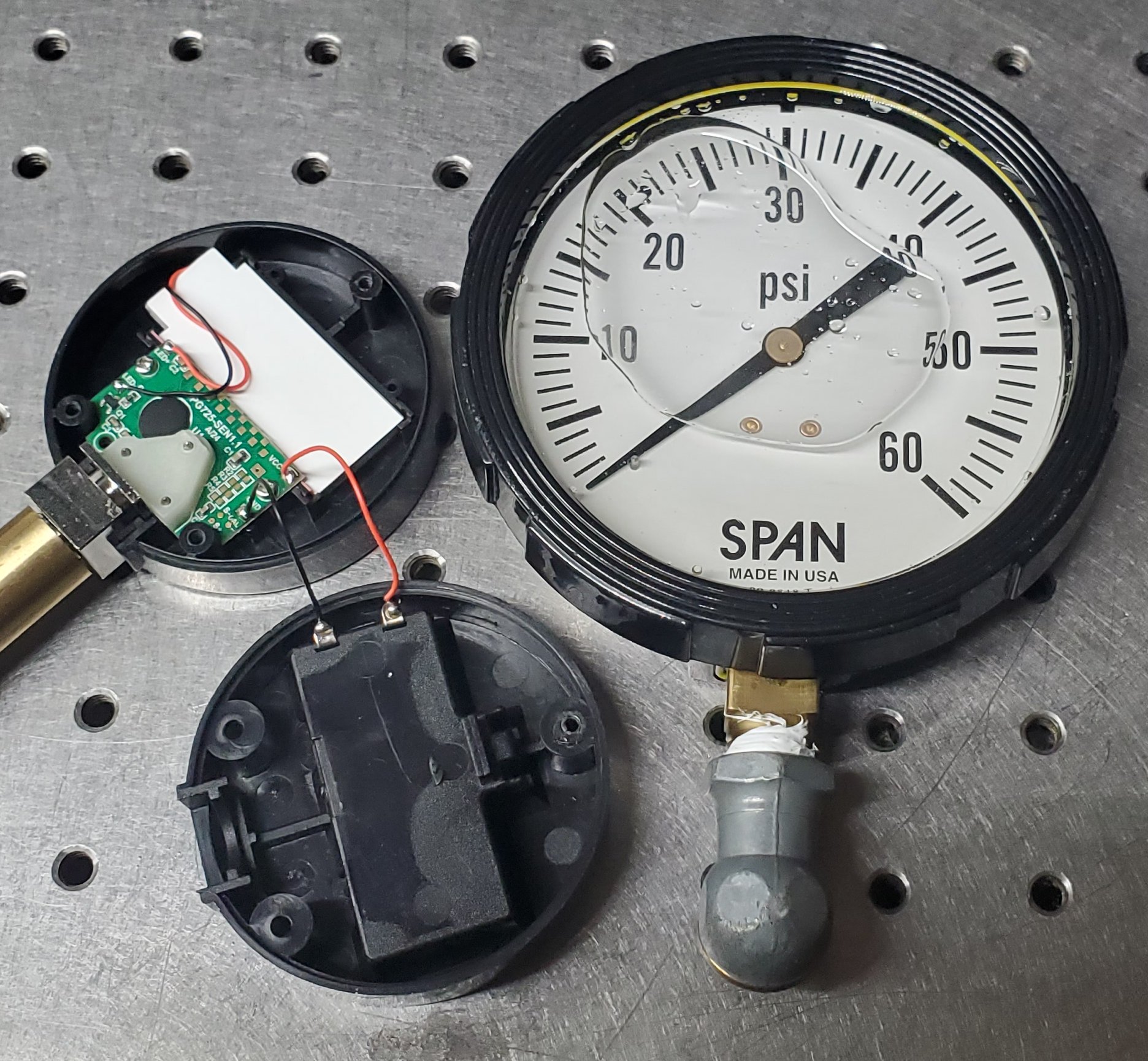

How can both be tested and calibrated?
It doesn't matter. It's an exercise in futility. The gauges most of us use are imported trash, and there's nothing you can do to change that.
Over the years, I've accumulated a variety of gauges, both analog and digital. Digital gauges can vary with battery charge. Analog gauges are made of parts stamped from junk material. Both are susceptible to accumulated contamination from microscopic droplets of sealant. I've found that most start giving grossly erroneous results after six months or a year.
A while back I decided to "calibrate" my gauges. I found a couple that were in agreement at the pressure that I run my tires. I assumed that those were more likely to be correct. I set the other gauges to show the same reading as the "correct" gauges. On some, the "zero" was off, but that doesn't really matter for what I was doing.
Despite putting in a lot of effort on calibration, consistency didn't improve. Over time, the readings on the gauges changed again. Needless to say, I was disappointed.
My current setup is to set the pressure using the gauge on my Joeblow Mountain pump. The pressures I like are 26/23 on THAT pump. Maybe the actual pressures are different, but it doesn't matter as long as I can fill my tires to the way I like them. This pump is just over two years old, and the pressures still seem consistent. If the gauge starts getting weird, I'll eventually be able to feel it on the trail.

It's like other products not all can be trash, some better than worst but as far as I have understood it's best to use the same gauge every time to get the most precise measurements.
Anyway I'm satisfied with the D2 and now just jumped on the Cycplus hype but kept my $10 pump in reserve so I got a open return.
