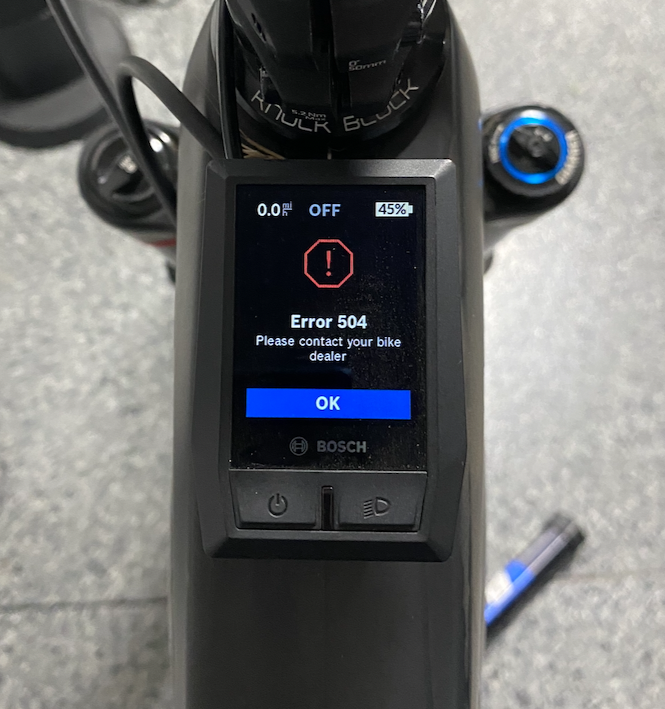

I was out on a ride earlier when my bike suddenly threw up an error 504 code on the display. I was at a standstill at the time waiting for someone to go past and I didn't think much of it as it disappeared when pressed a button.
When I started riding it felt almost like it was in some sort of limp mode. The motor would kick in at first then barely have any power.
I still had 4 of 5 bars of charge but weirdly the range was showing 0 miles.
I've just done a quick Google and all I can find are threads by people who have had their bike chipped and getting this error, mine hasn't been tampered with at all so I'm a bit puzzled.
Any ideas?

OMFG, it turns out I have to ride it for 90 minutes to clear the error :eek:
It's like riding in treacle, and how the heck am I not going to look stupid riding in a circle for an hour and a half :LOL:
On a more serious note, how can this error have occurred? If the speed sensor has moved slightly could it potentially cause it?
Really stumped but I've emailed Bosch to see what they have to say.

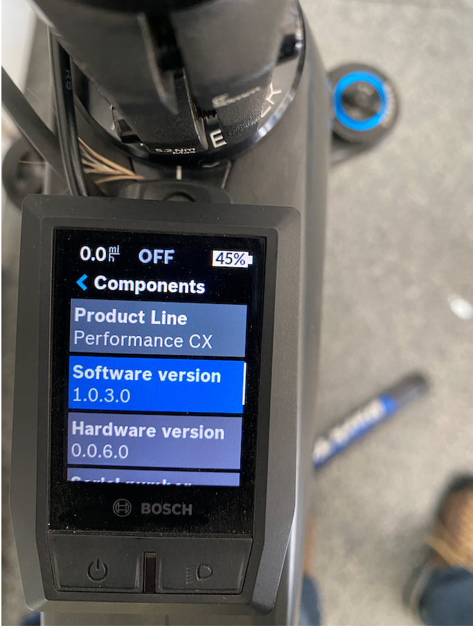

I have a new Trek Rail. Mine has the latest software (1.0.3.0) and is a stock/standard bike. I just got the 504 code the other night far away from home. It was a slow ride back and became dark and left me in an unsafe condition on a black bike with dark gear on riding home past dark.
I had a Levo before this Trek with the Bosch Gen 4 and the Levo never let me down. The chainring came off on the Bosch within the first 100 miles and now it gets this terrible 504 error code. If it were a car, I'd be close to calling it a lemon and asking for a refund!
Bosch needs to get their act together and fix this issue. I will try to return the bike and go to a Levo if this happens again.

So is the firmware version 1.0.3.0 the latest one which is supposed to stop these spurious errors? Not good if it is.
I'd email Bosch mate to let them know so they can log it.
I agree, expect better from a company like Bosch. Motor is great when it’s working....

I thought v1.0.3 was the latest and it fixes the errors too :mad: Checking which version you have depends on which display you have to someones earlier question. To check what you do for your Bosch display look at the bottom of this page:-
