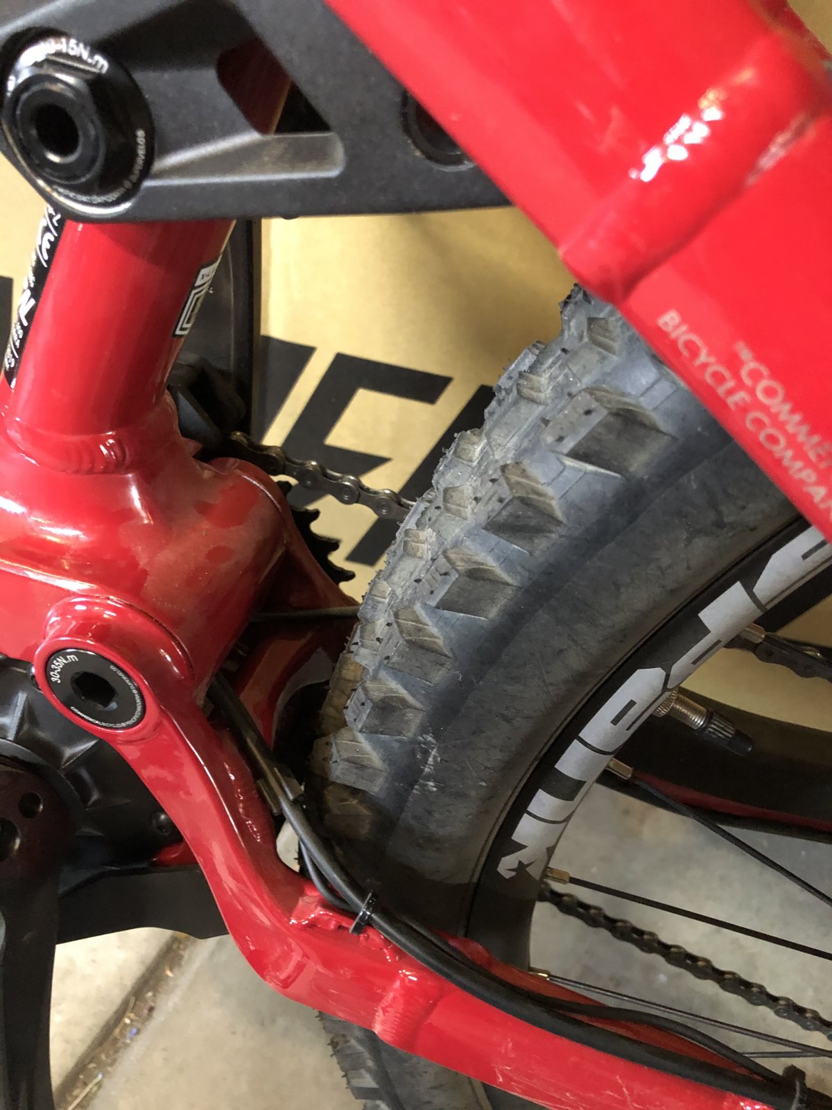

Do you have problems with dirt and rocks getting in this spot on your bike. (I’m thinking possibly a piece of foam stuffed
in there and then making a small fender to zip tie to the lower chains stays) just bought an XL and I’m trying to figure out the best way to deal with this area

I've not had anything wedge in there and be a problem, but I didn't fancy it as an ingress point or a nice little cubbby hole for transporting mud and grit.

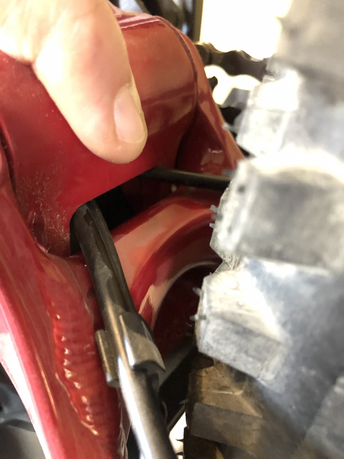

I was trying to figure out how to get a RRP enduroguard wedged in there and tied to the chainstays. The issue has been the cables are a little tight and push it too close to the tyre - need to finesse them into a more forgiving path or find a better fitting guard.

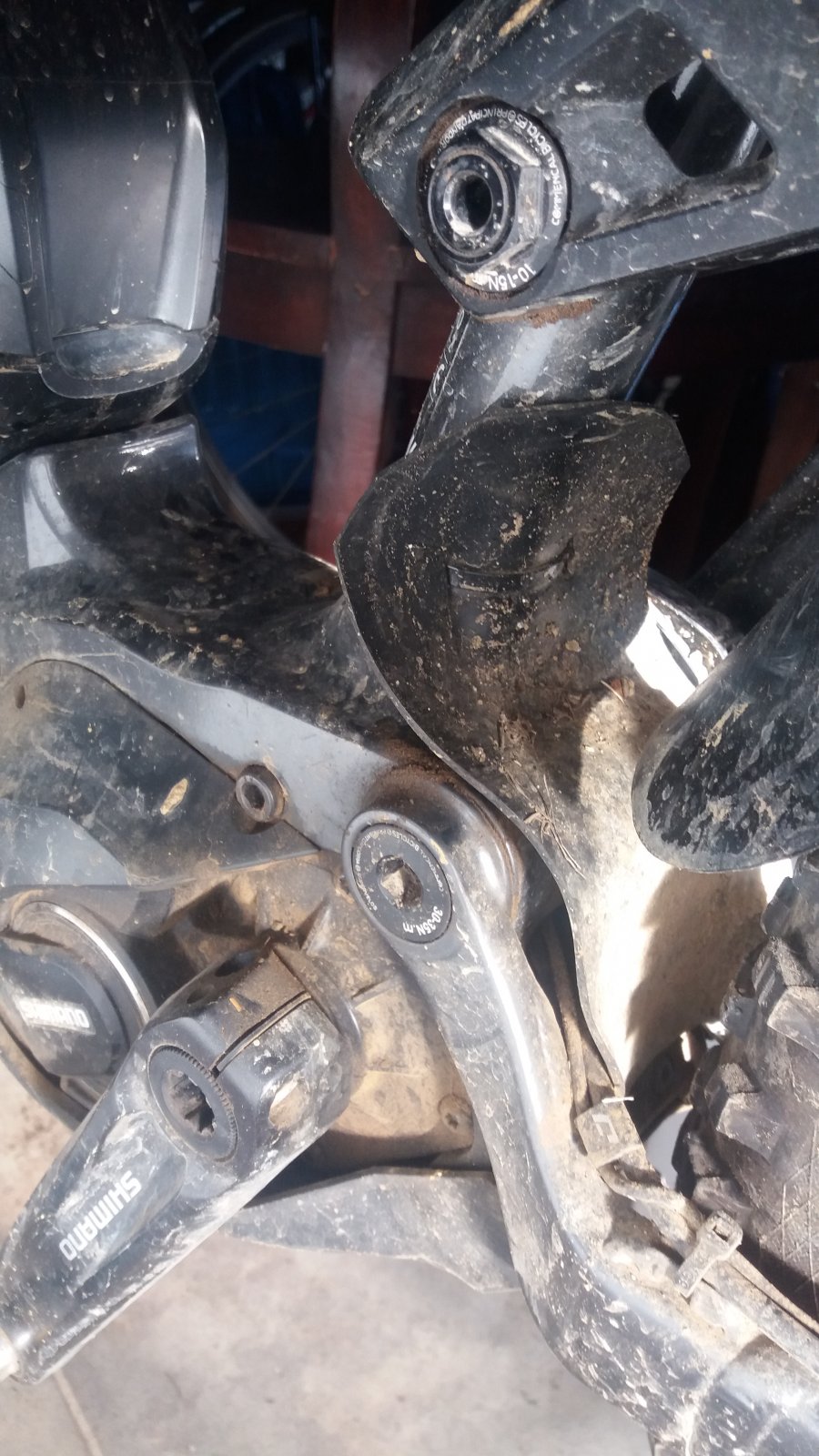

This is what I've done on my wife's Meta Power.
The rubber flap is stuck in place at the bottom using VHB double side tape and zip tied it the top (so you can still pull the bike to bits for servicing). To stop any mud from sneaking over the top of the rubber flap, there is a plastic mud guard mounted in the curve of the upper stay bridge. This keeps the bulk of the mud and water out of the suspension pivots as well.
Ugly yet effective, a bit like myself ha ha!!

Yep. I've given up trying to have bikes that look good and instead have bits of rubber and plastic stuck all over the show to protect bearings and drivetrain.
