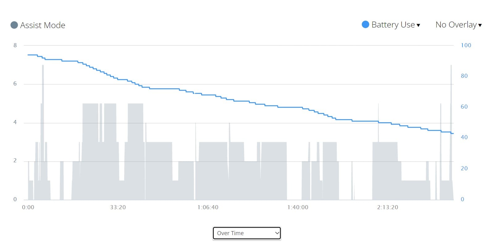

E+2 (625wh battery):
I'm about 74 kg, with all my gear on. Also there is a cushcore in the rear which adds rotating mass.
Maxterra compounds, DHF front, High Roller DD rear.
Yesterdays ride, at 11 degr Celcius, on dry trails:
51% battery consumption during a 29 kilometer ride, with 852 total meters of ascend.
Attaching the graph of battery consumption and power levels, over time.
Most of the time on power level 3, a few stretches of using full power level 5* and level 4. Powering down to zero whenever coasting down on smooth connecting roads.
*which on Garmin, bike's power level 5 is shown as 7, and bike's power level 4 is shown as 5.

Really useful comparison - thanks!
