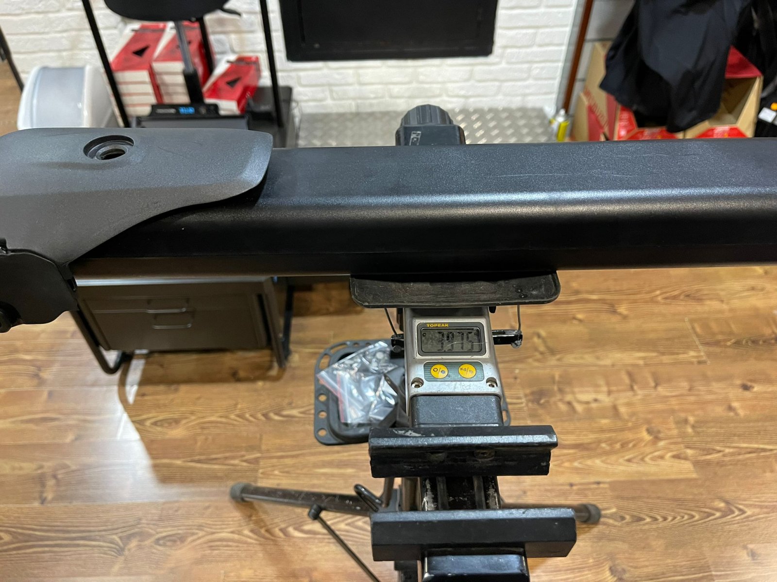

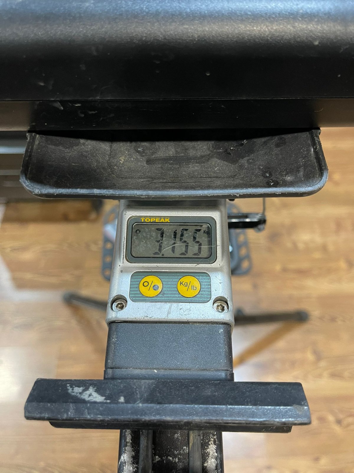

Did you feel the difference? better handling ?
especially that those 700g less are in the most important place (close to a head tube).
