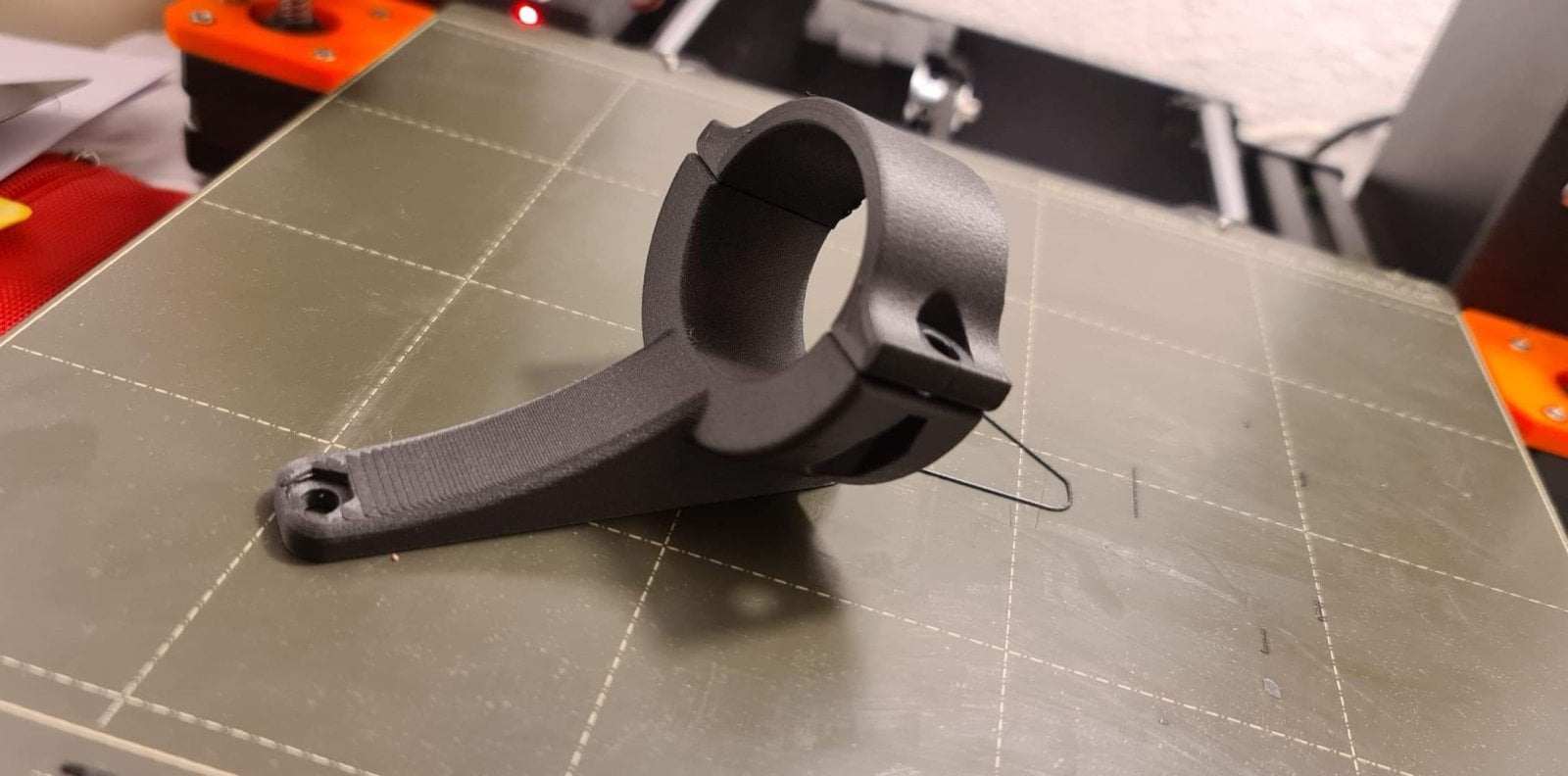

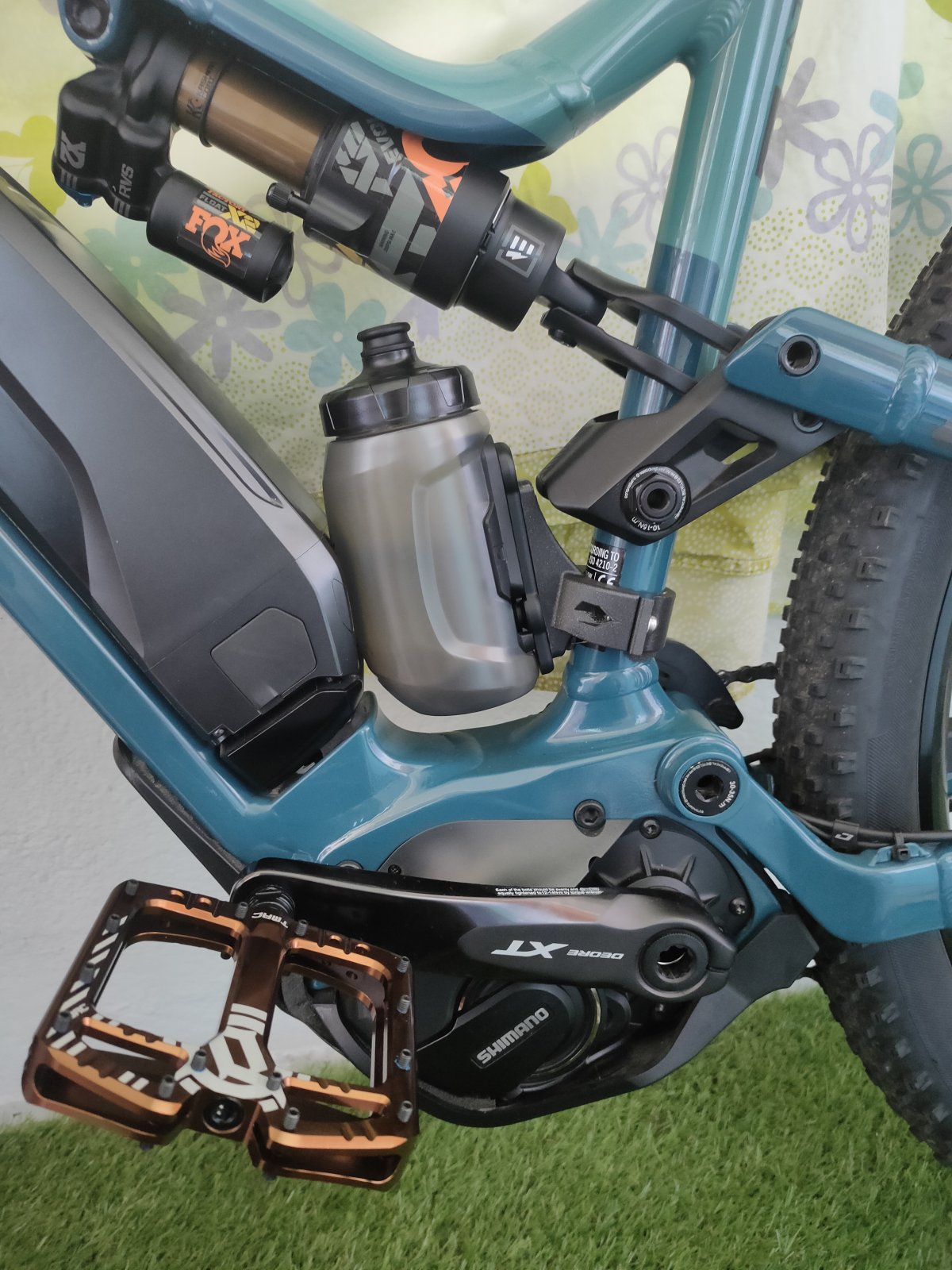

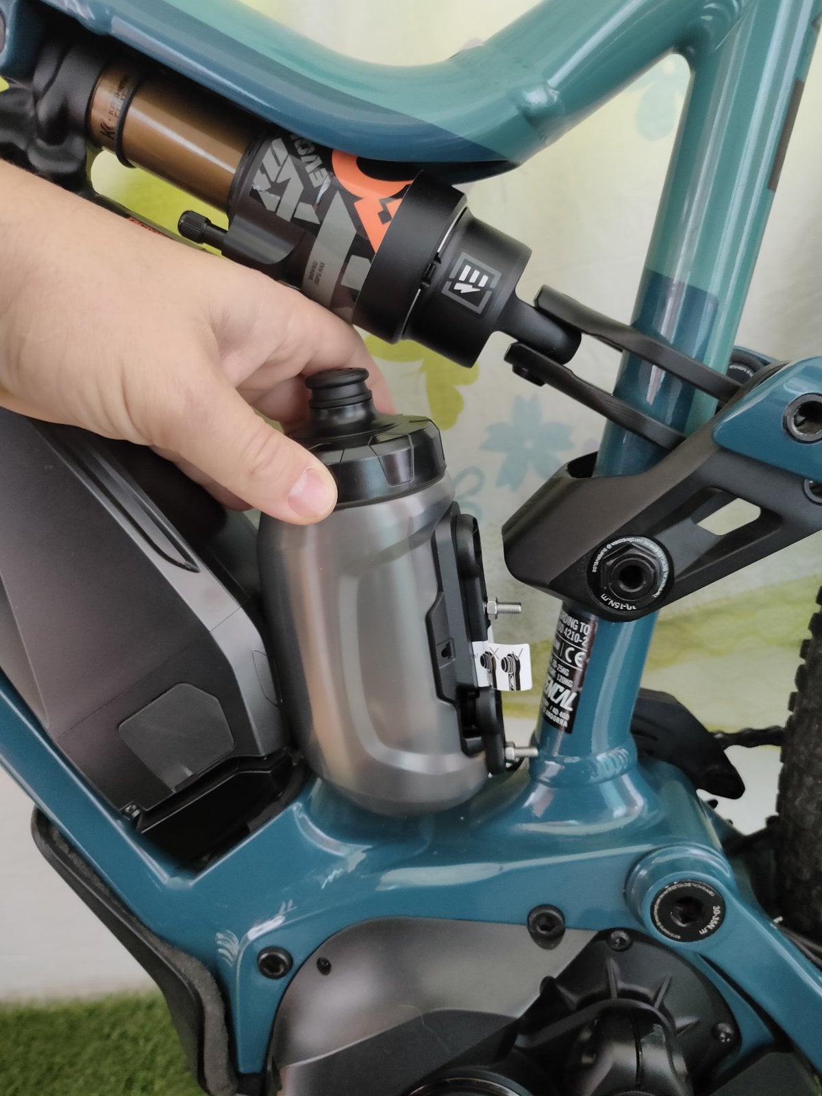

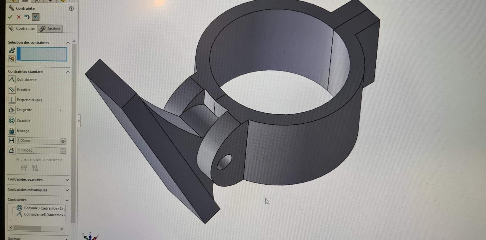

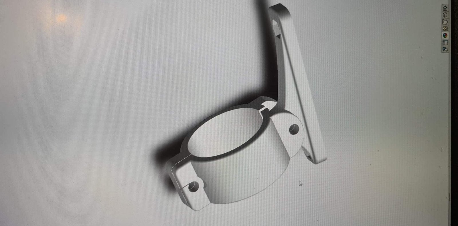

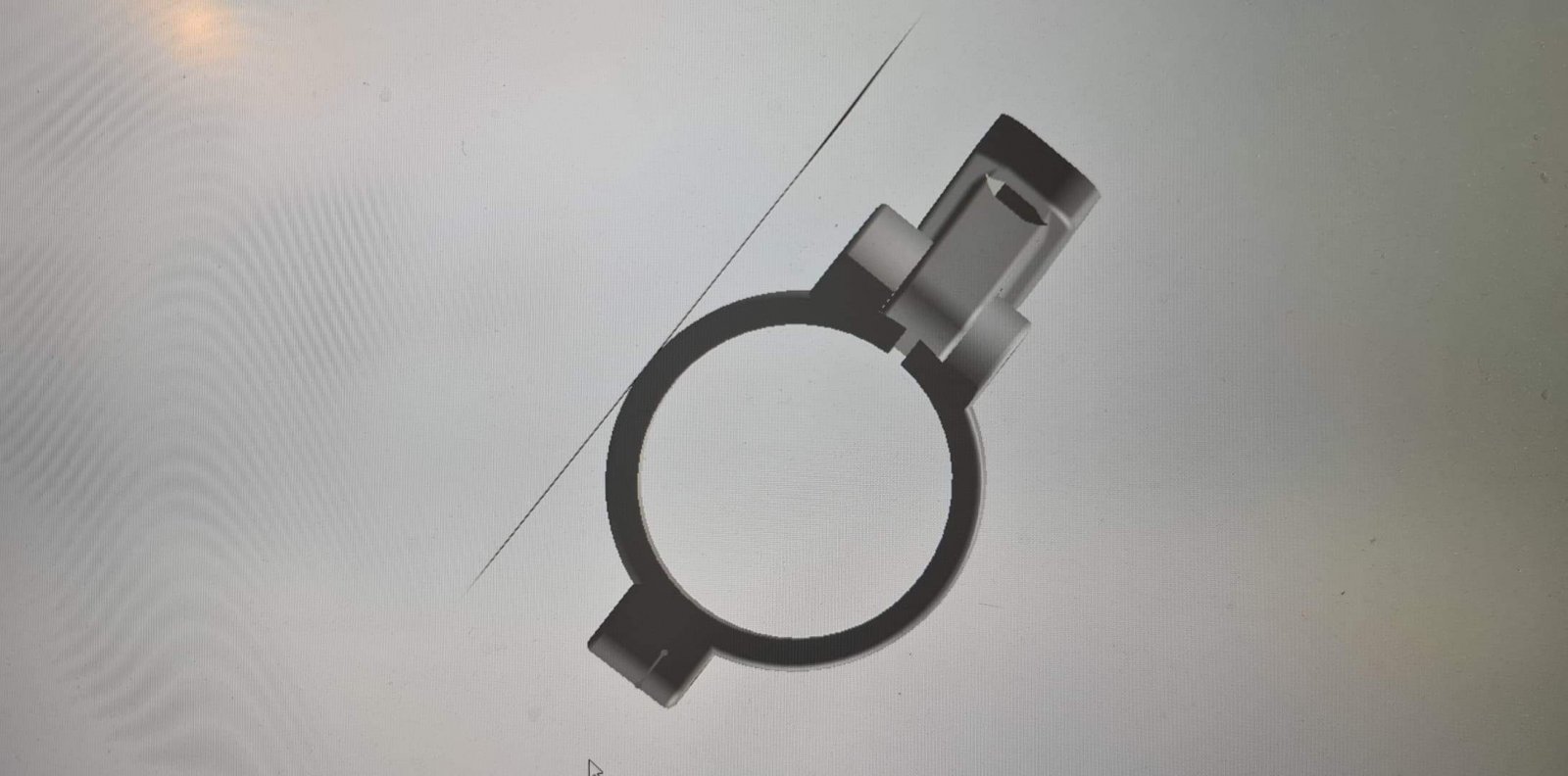

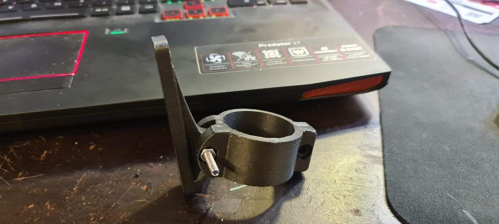

here some pics of my 3D printed bottle mount, took some time to get final result

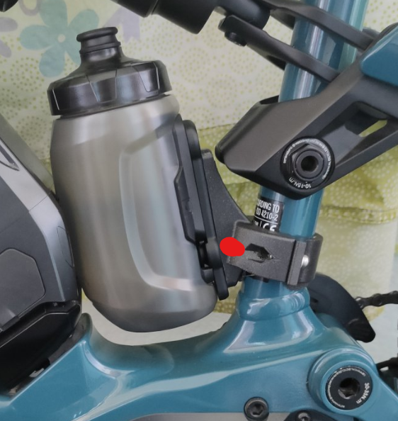

That's awesome!

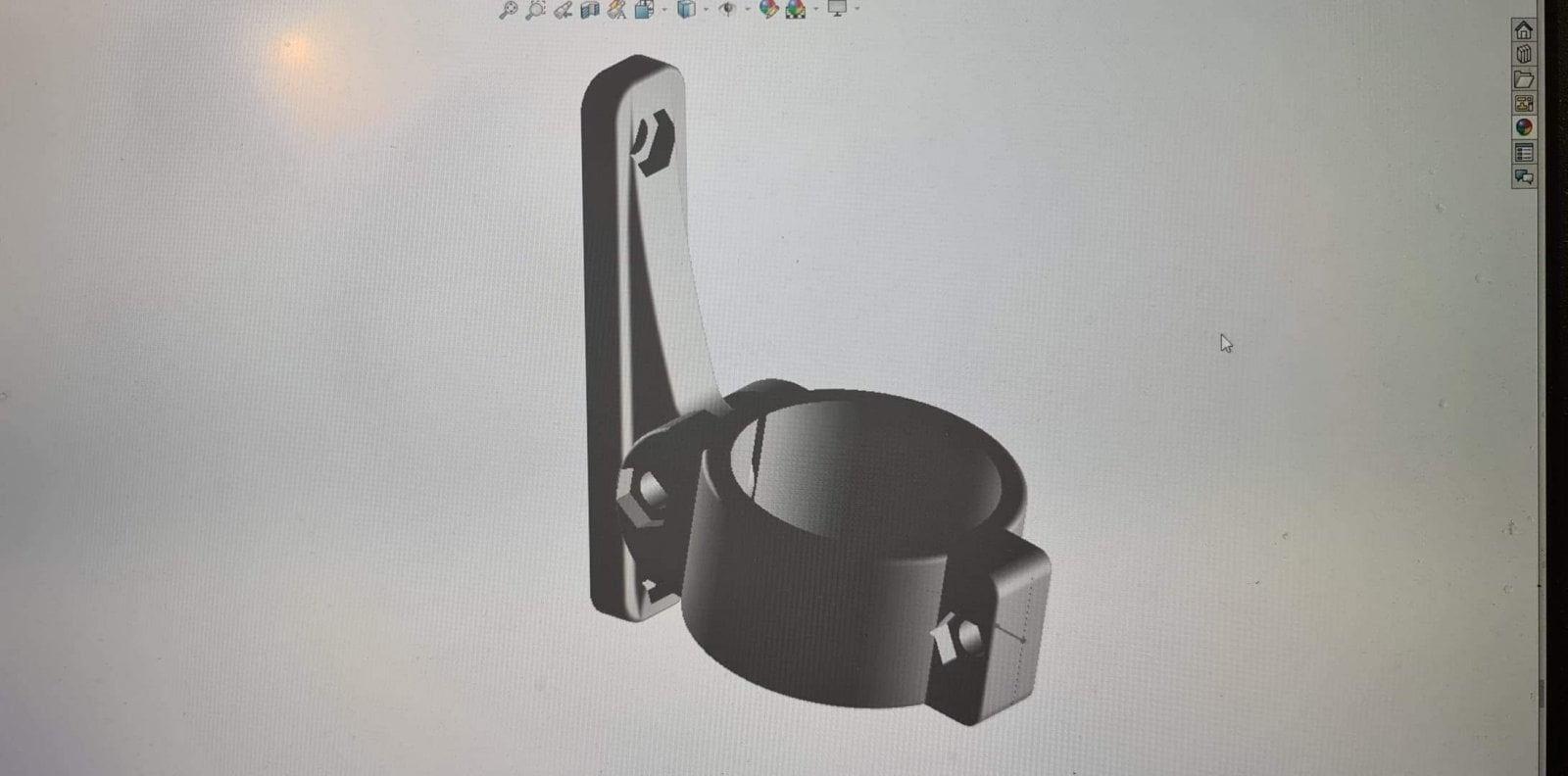

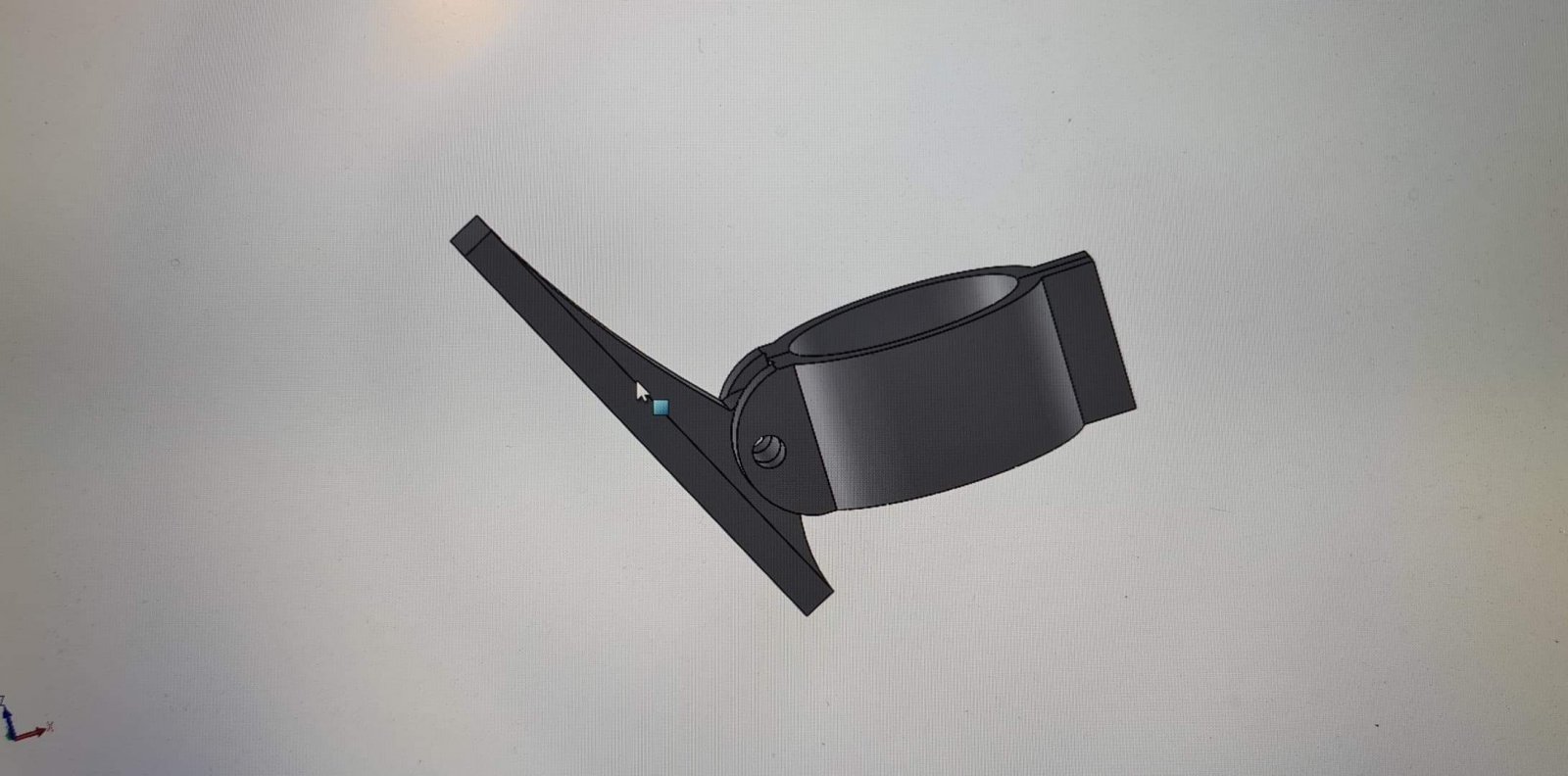

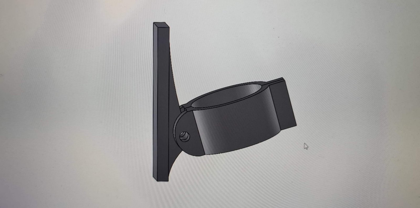

If you had a bolt to articulate the mount where the red dot is, I'm sure it would fit lots of bikes.
routrax
Jun 15, 2019
382
529
Uxbridge
it's an idea , but why ?
If you need a mount like that you would generally problems mounting a bottle on the frame, as frames are all very different your design wouldn't fit them all. With some adjustment in the mount it's be a winner.
I've just upgraded my rear shock to one with an external oil reservoir and my stumpy bottle does not fit on the normal mount anymore. I don't think this would help me, but if the bottle was tilted 10-15 degrees it'd probably fit and I'd buy one.
what is your bike ?

I do, but my small bottle no longer fits with my new shock. Space was tight before the shock upgrade, now the bottle hits the shock.

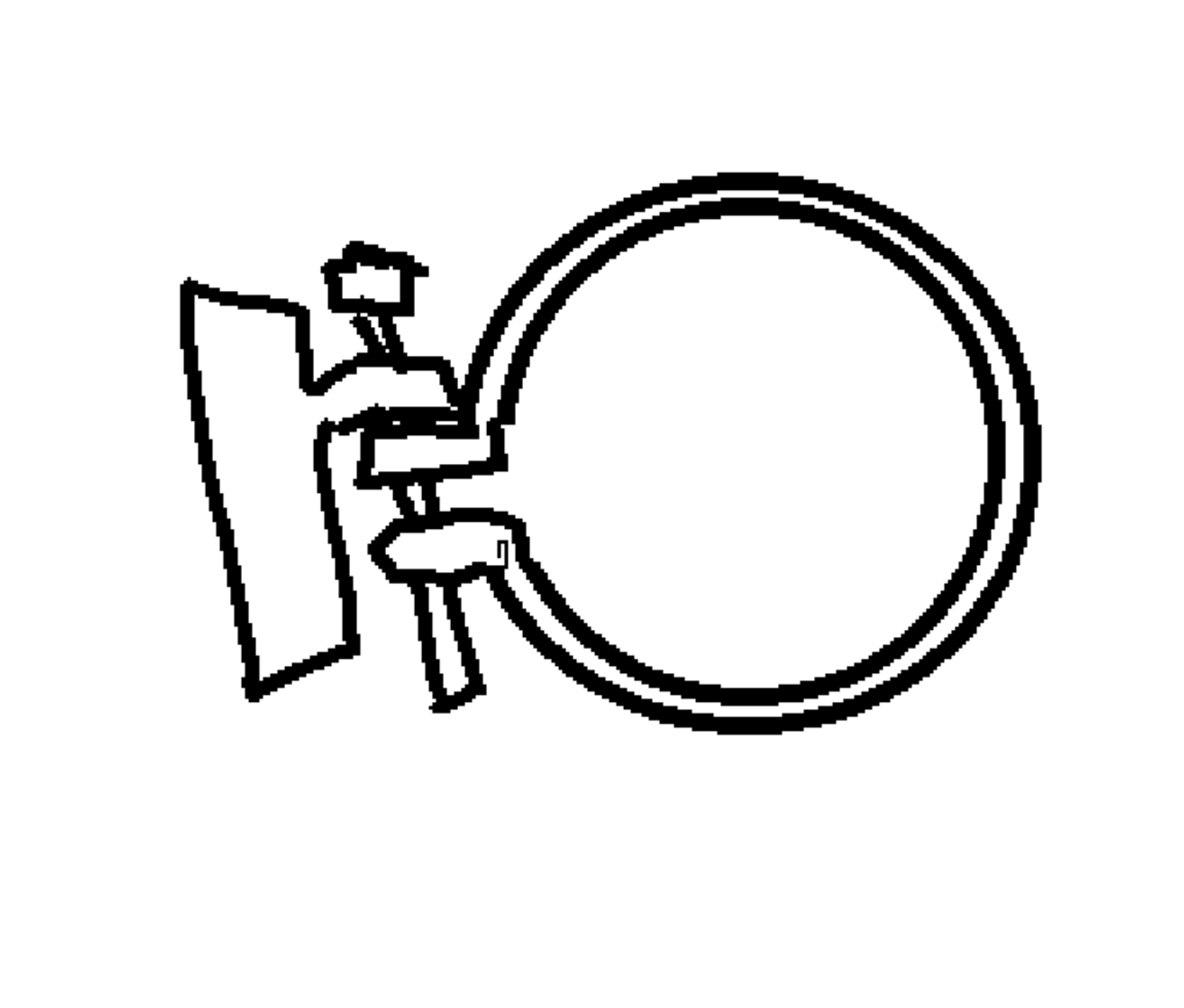

Yes, that's exactly what I meant.
I think you could do away with the clamp opposite the bottle mount and have the articulation bolt clamp both parts perhaps?
