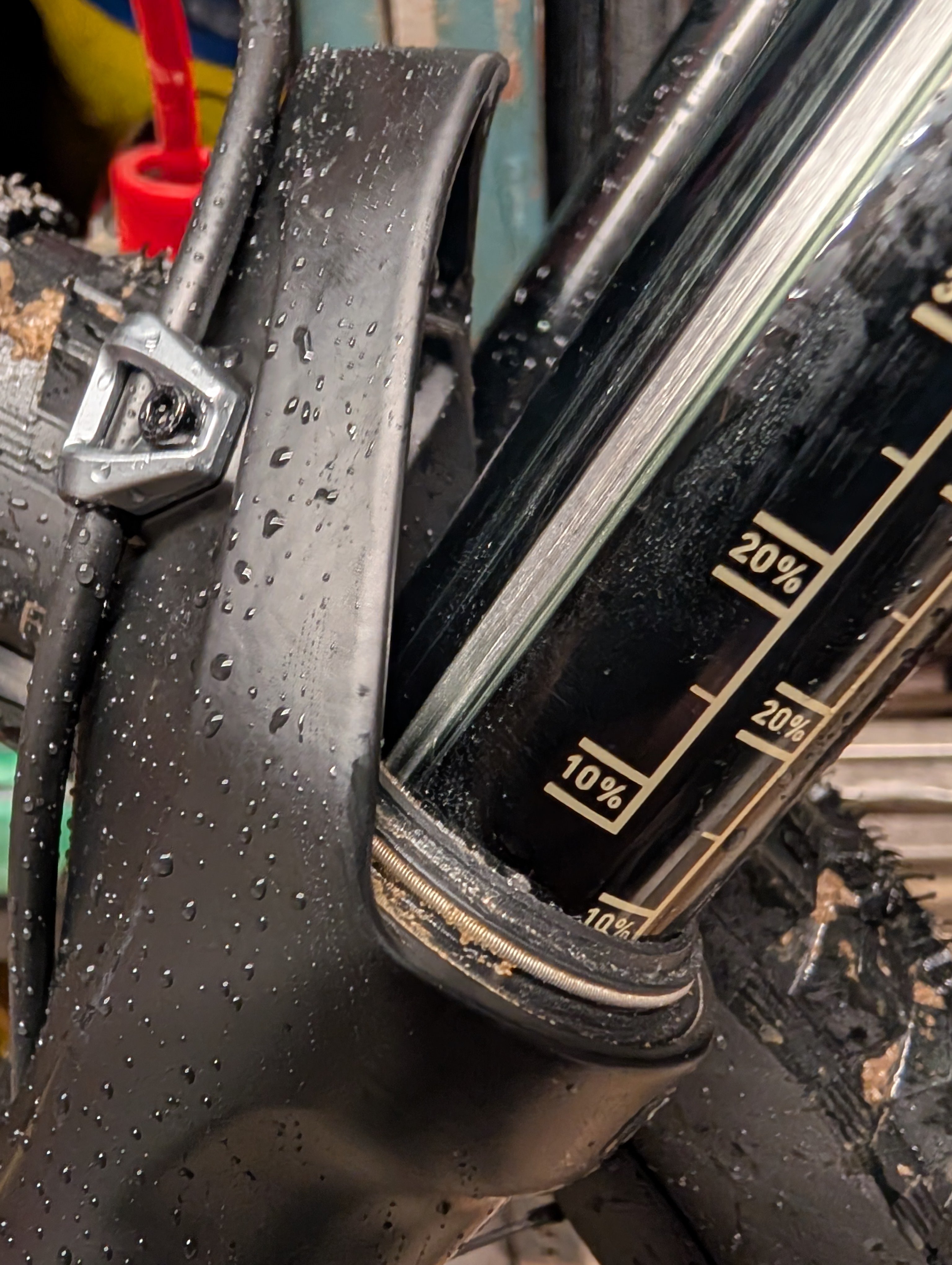

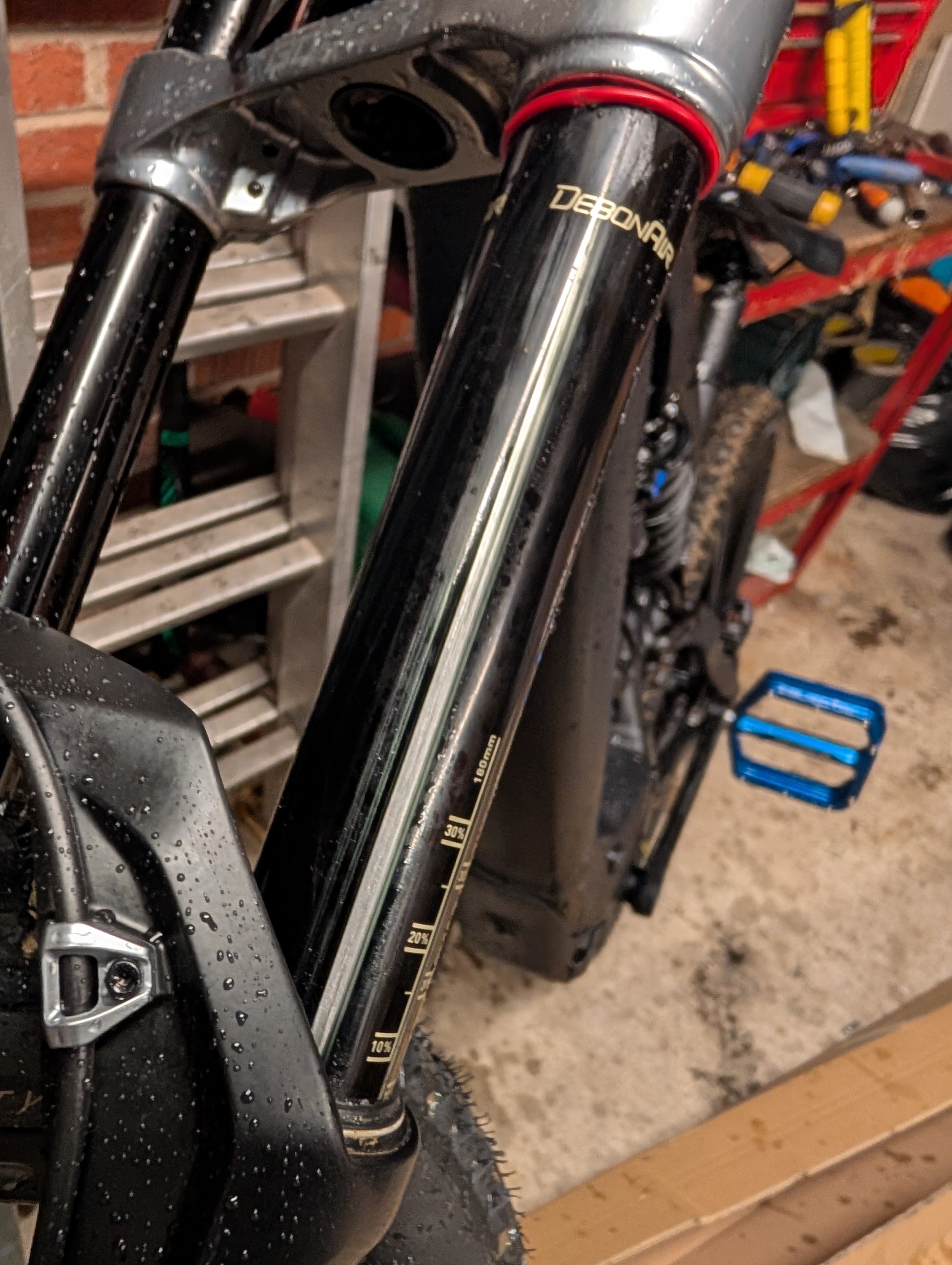

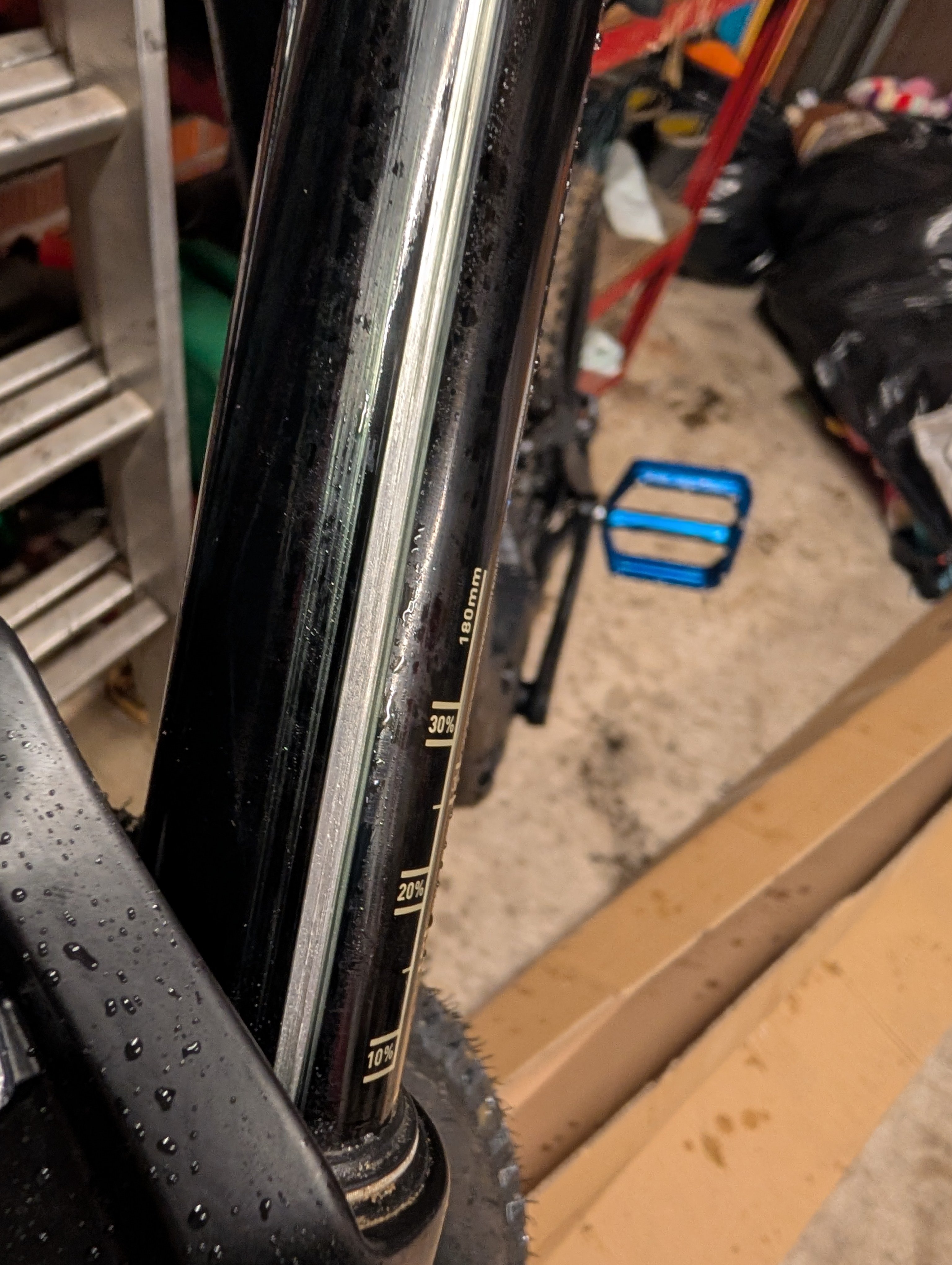

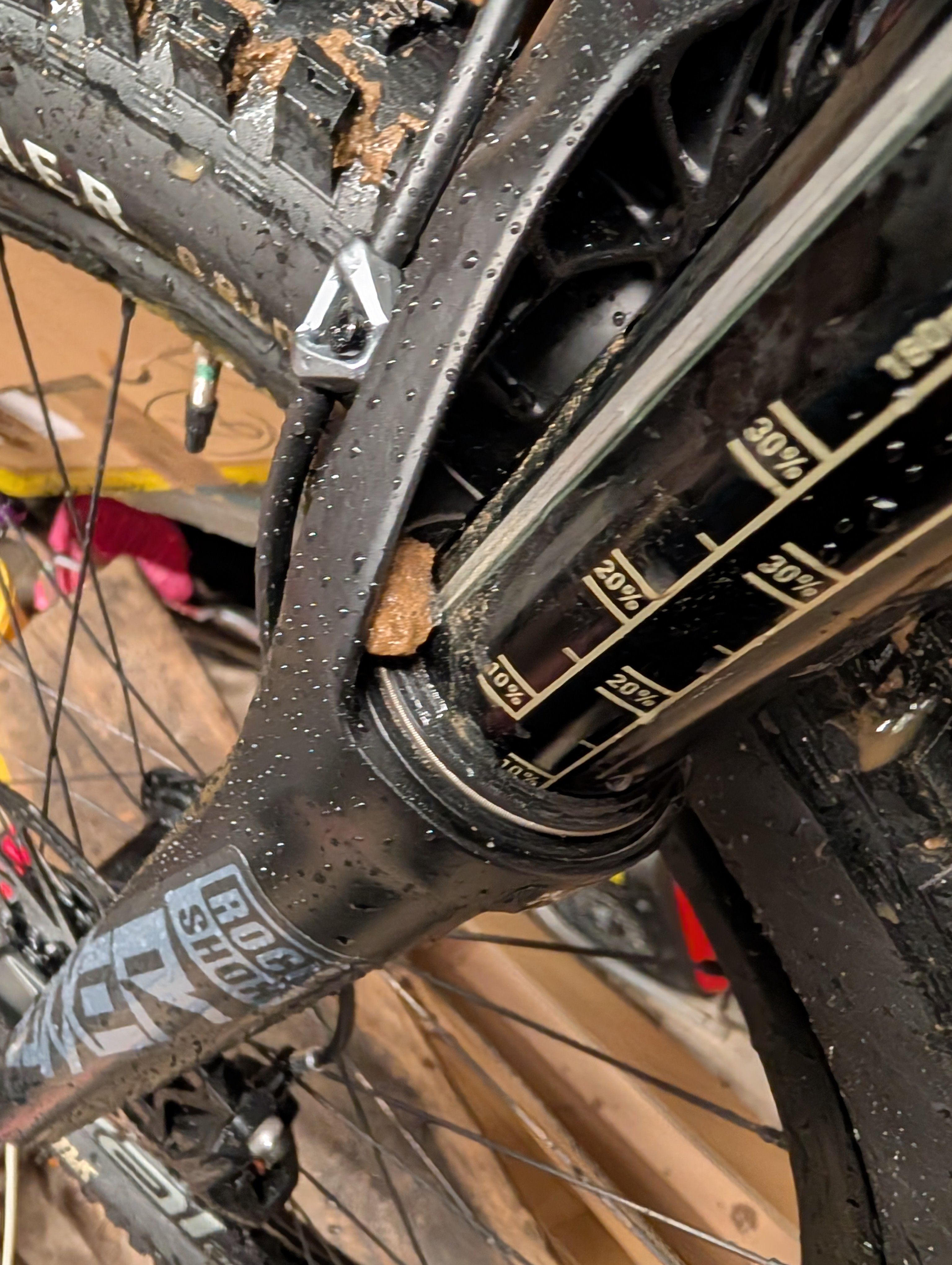

So just got back from the afternoon at farmer John's bikepark on my new Turbo Kenevo.
Very glad I bought it 😍😍😍
But in cleaning it, I found a stone jammed in the tiny space between the fork stanchion and chassis.
One in a million chance 🤦‍♀️
My next job was to put bottomless tokens in because it was bottoming out hard even after I increased the pressure well beyond what's recommended for my weight.
So that means the scratch/gouge is the entire length of the stanchion.
I'd describe the damage as a 4mm-wide flat, progressively tapering off towards the top. See pic and vid. There are a couple of slight ridges within it.
It's on the air spring side (left), not the damper side.
Are these repair kits I've seen worth a try?
Being that the boxer is a double crown fork, the stanchions do come out thankfully. But from what I can see online, they aren't yet selling the 38mm one separately?
Should I just ride it until these seals give out, and hope this stanchions are on the market by then?
Could that flat spot damage anything else more costly?
TIA
Danny

I know absolutely nothing if this sort of damage is repairable or not, but the first thing I'd do would be to send the pics to Rockshox and ask their advice. That really is very bad luck 😞

that sucks, especially on its first rideo_O
realistically the damage runs in the wiper seal and the bushes that support the stantion tube in the lowers - the seal is to stop crap and water getting into the lowers to mix with the lube & also stop the lube escaping.
realistically the bushing will be already damaged so probably wont get any worse, if you remove the stantion from the crowns then the damaged area could be turned & positioned on an undamaged bit of bushing?
ideally you'd have a new stantion tube (the bushing will have plenty of support as a %age of damaged area and IF you cant afford the extra to replace?)
but I'd just ride it 🤭

Cheers
That's pretty much the conclusion I'd reached after digging into this and understanding more about how they work.
I didn't realise the air piston is inside the stanchion so the important is well out of the way.
At first I thought being on the air side would was worse, but now I think it's probably less bad than if it was the damper side than if it was the damper side.

Just to note that based on your images you have a C1 Boxxer which have 35 mm stanchions, not the newest one with 38 mm (D1). The left airspring side stanchion manufacturer number for C1 Boxxer is 11.4018.093.001.
Well spotted, cheers! That's what I've figured out today in looking around.
When looking into the bike I asked the shop if they're 38s and they said yes. Silly old me said "oh they look thinner but it must just be because they extend so much further up, making them look relatively thin".
So overall good news 👍👍
Also, definitely going to look into putting something on the back of the fork bridge to shroud that gap slightly 🤬

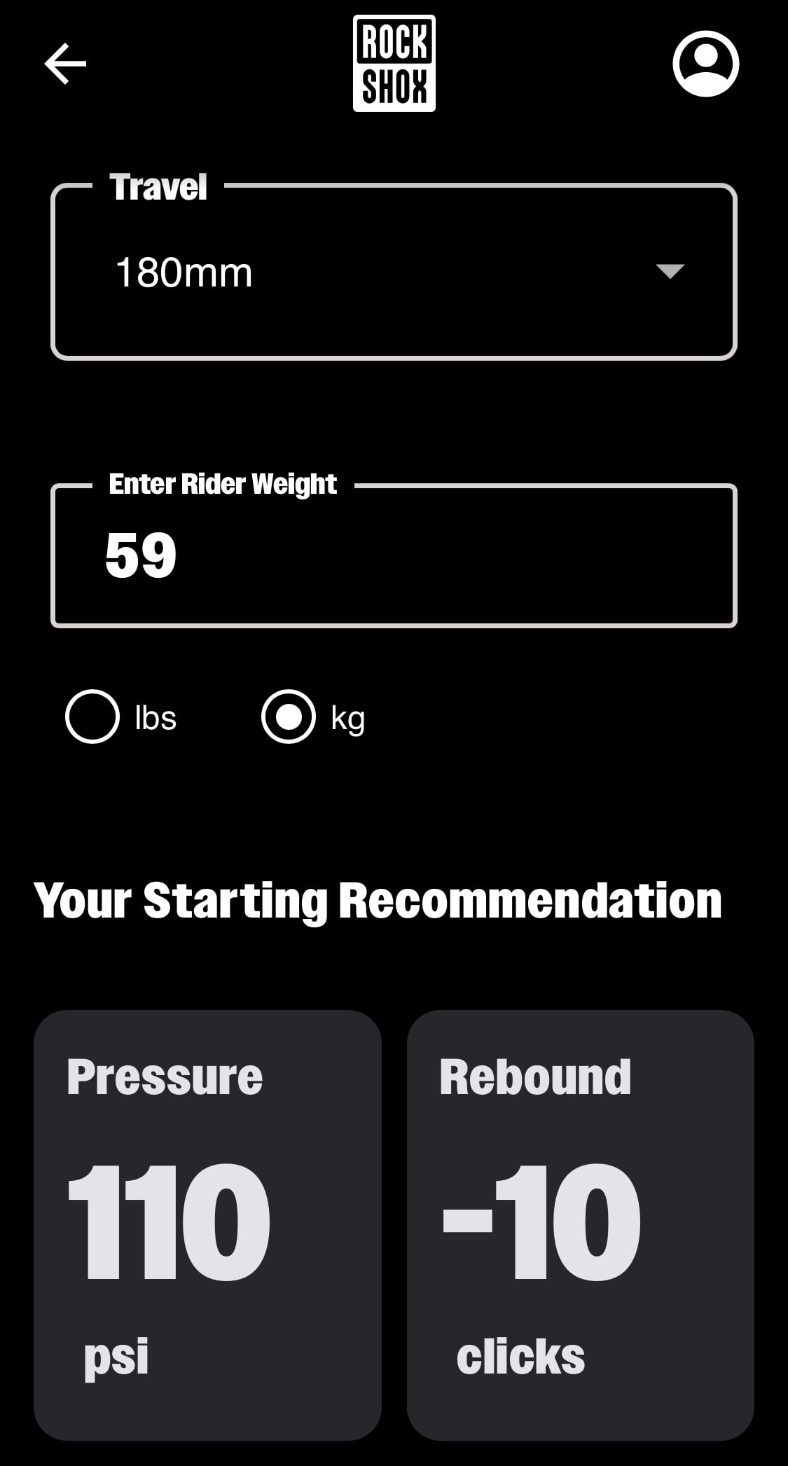

on the boxxer good or bad discussion, Ohlins made a 'drop-in' damper to fit the older Boxxer & it was used on many competitions - allegedly🤭
Ohlins also made that damper fit the fox 40:p
also, to identify the Boxxer (age, general spec & suggested setup as a starting point) go on Rockshox Trailhead (app or website) & enter the serial number

Doing that right now!
