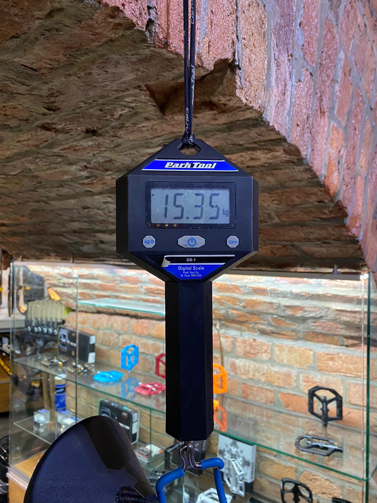

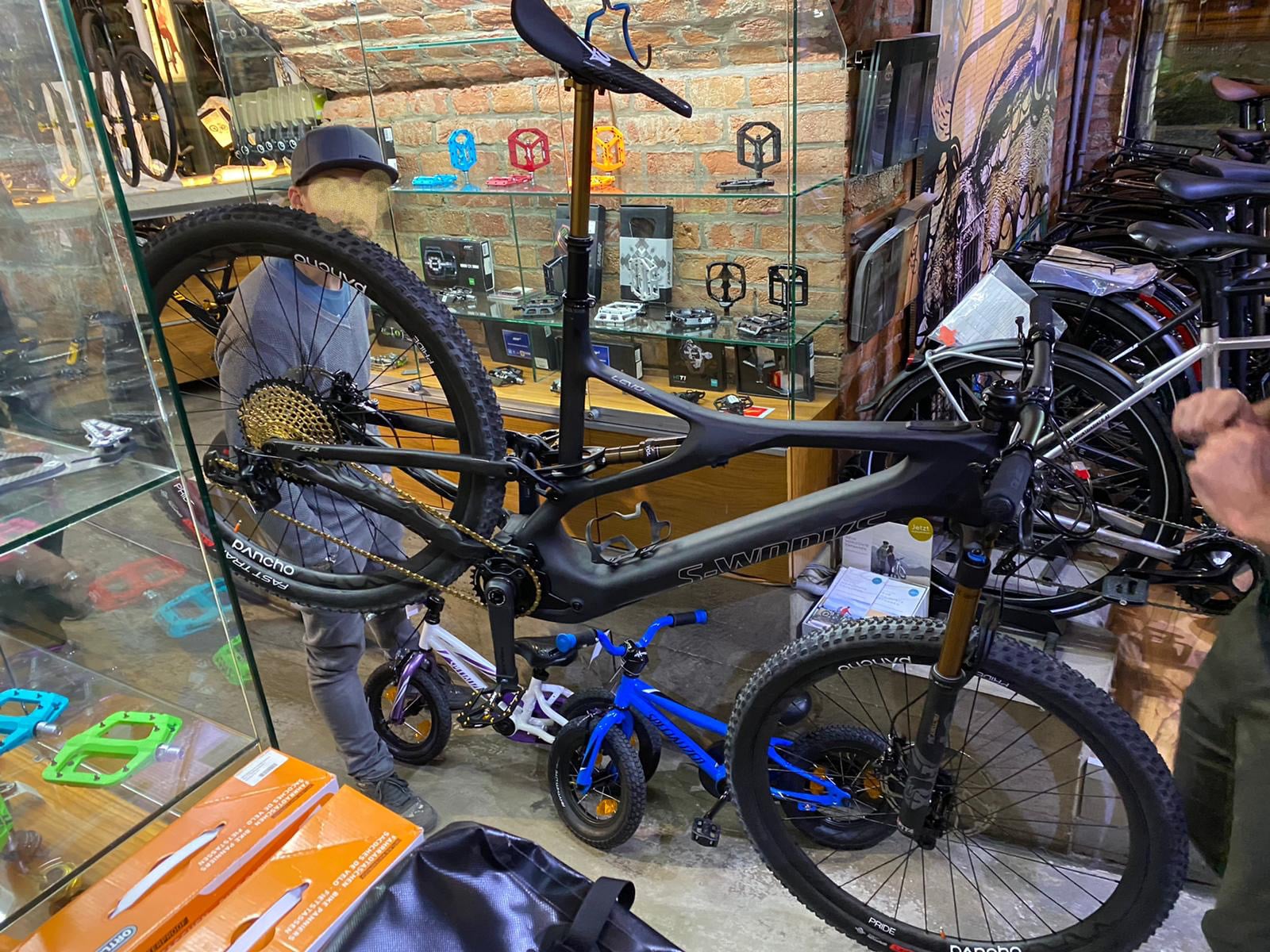

Some of the things he has done to get it under 32lbs are not really practical, but some are not too expensive (lighter tubeless tyres) and make sense
9,190
I sure hope he isn't riding that round without bar endplugs and a top cap! Its interesting to see what people can get them down too, but again IMO this is a build that has sacrificed usability for weight saving, e.g getting rid of the dropper remote.

Yes there's an xc build someone's done that I think is sub 14kg, and maybe even less than that.
Edit: Found it
Damn thats low! My plan is to build a burly trail ready bike, no way I can get to that level of weight! I'm interested to see how it rides with the range extender only. I got 60Km on the internal 320Wh battery, so if I can get 20-30KM on the half-sized 160Wh I'll be fine for shorter blast around the hills with it.

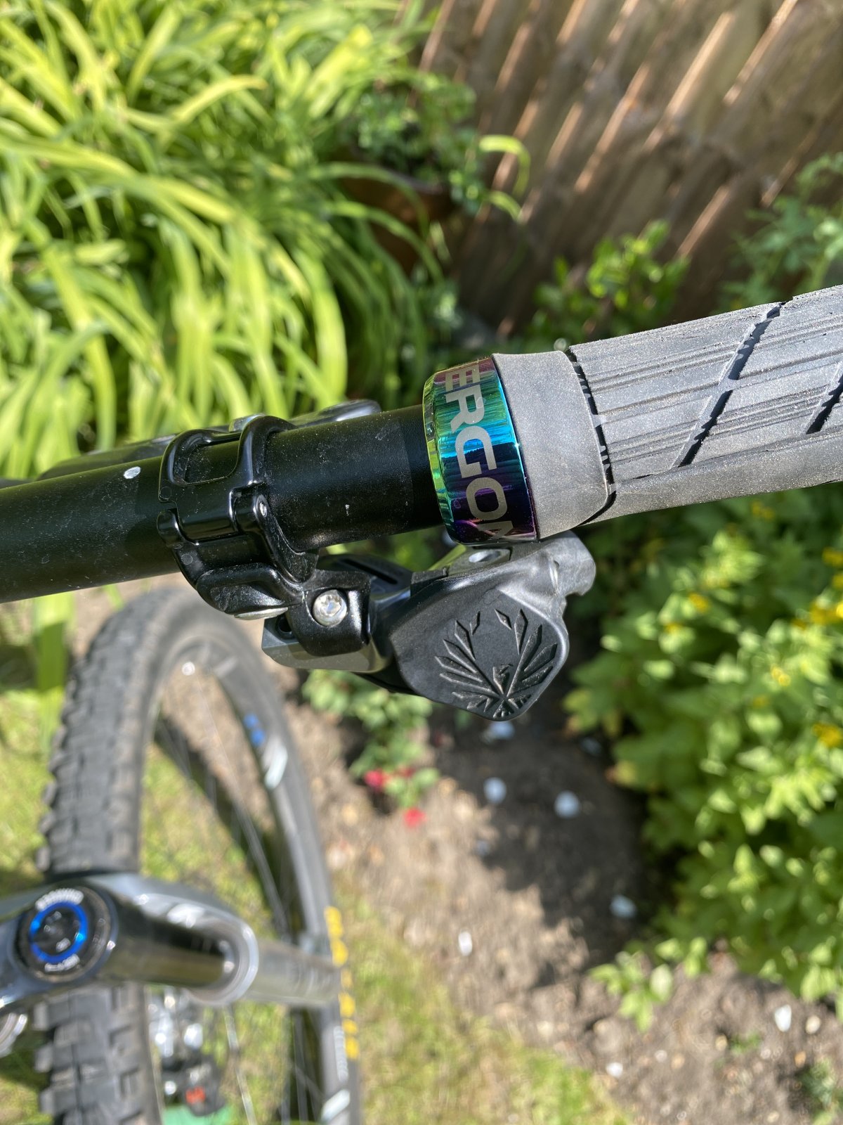

I don’t think I’ll ever get mine under 17kg whilst it remains ‘usable’ in my eyes.
I’m just on 17.5kg at the moment, and have the Praxis carbon cranks on order - which will probably shave a little bit off.
I ‘could’ swap the Roval carbon wheels for something a bit lighter and save another 150g... but it doesn’t really seem worth it for ~£2000!
I want to change the rear shock, but that’s going to ADD weight when I fit something more adjustable.
My Michelin Wild tyres are heavier thanstock, and I’m sure there are much lighter out there... but I really like them.
I’m not willing to sacrifice quality / usability to make it lighter... so I think I’m pretty much as good as I’ll get (after fitting the cranks).

Oh yeah - I could always lose 133g by taking out the multi tool and holder from the headset... but I kind of like it!
Yeah it’s great.
You gotta build the bike for you and for what you ride. No point building a 15KG bike that won’t handle the conditions.
