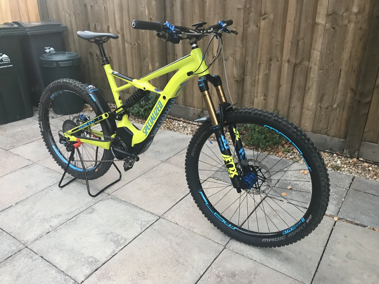

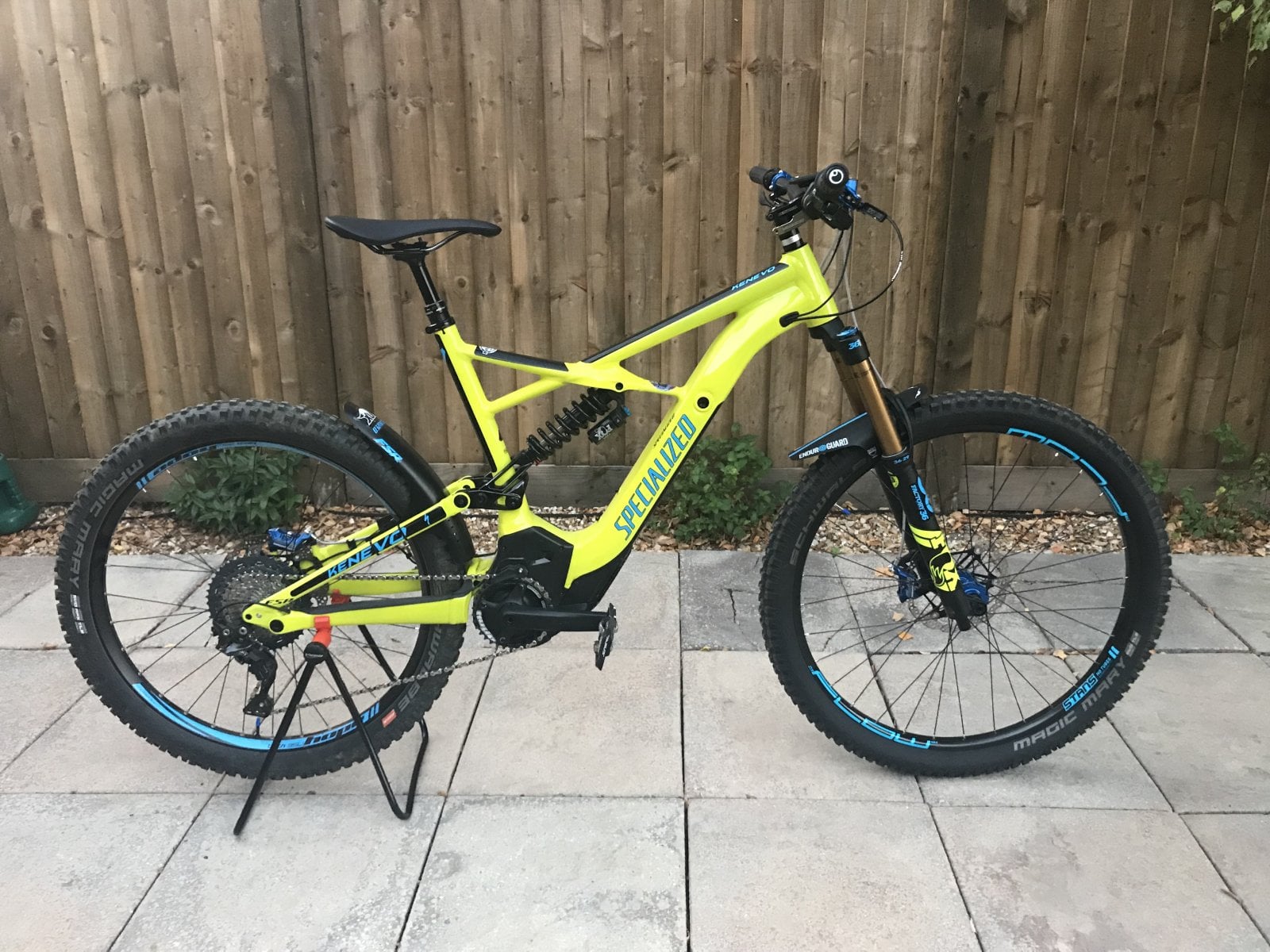

Will let you know the difference on Sunday as I’m trying the 29er front wheel in my kenevo then. I’m running a 2.6 magic Mary on the rear (27.5) and a 29er 2.35 magic Mary on the front.
It has noticeably lifted the front end and I like the new position, it should lift the bb a bit and reduce pedal strikes and rollover at the front should improve too.
The proof will be in the riding and Cannock with the well worn surface will be a good test - I’ll let you know but it looks ok so far

Whats the rear guard on that?
9,190
Nice - i am running an RRP Proguard on the rear of my hardtail which works well and has great coverage, but looking for something more svelte for the FS

That bike is so sexy!
