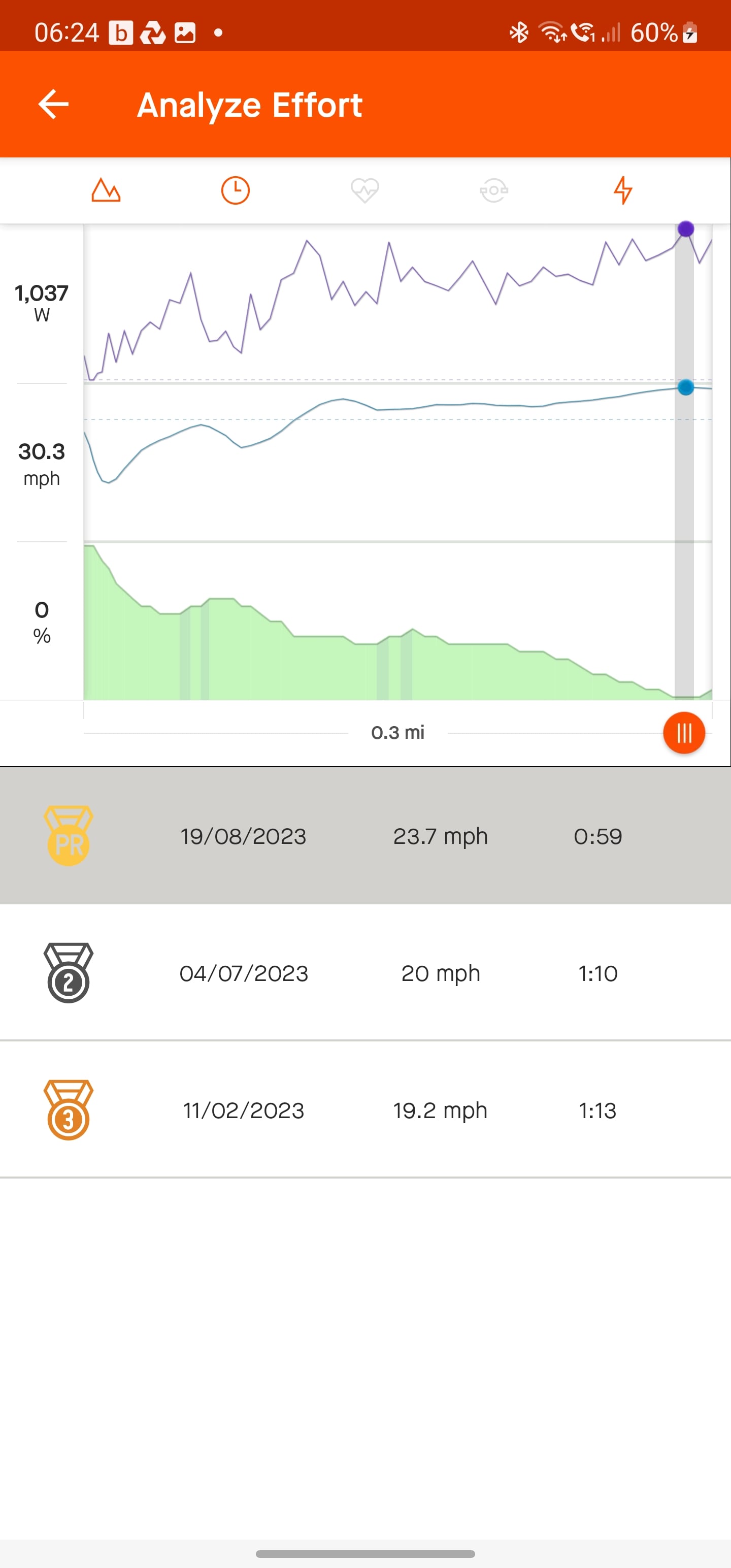

Not sure how you're spinning out at 26mph with 42x10 gearing. My limiter is set at 32mph and I can hit it with a 36x11.
Ignore the downslope on this screenshot, it's less than 0.2%. Couldn't find an example where I've hit 32mph (but have definitely felt the cut-off), but got a 30mph here. This is on a standard Brose

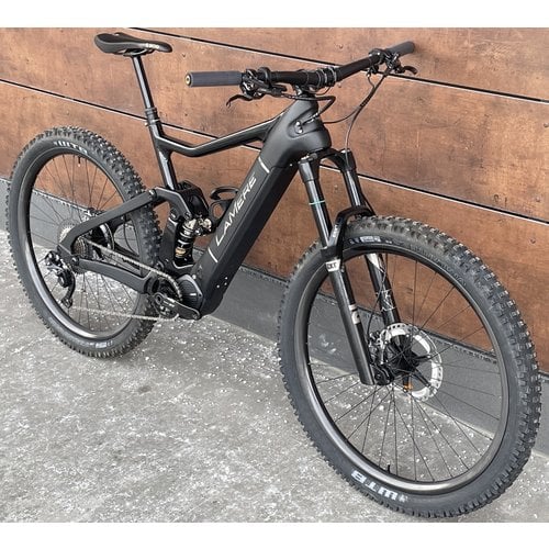

How are they getting 28 mph out of the EP801
For Shimano certified OEMs like us here at LaMere Cycles, where we build high end carbon eMTB bikes, we can set the EP801 motors to any speed limit up to 28mph. We ship bikes all over the world and there are different regulations in every country, and different regulations all around the USA even, so we talk to the customer and make sure they know what the rules are on the local trails they will be riding and as long as they are in compliance we sell them what they order.
