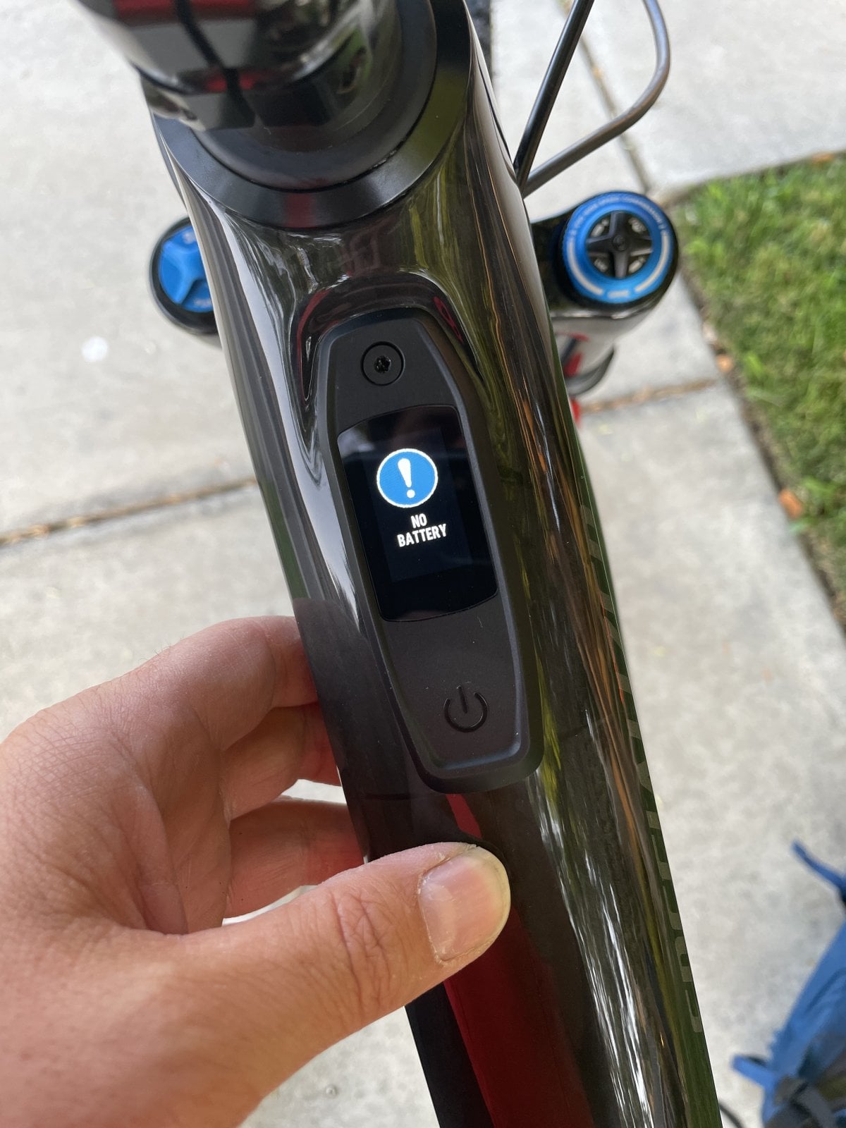

Hi guys,
I’m new to e-bikes, but not specialized. My previous bike was a Specialized Enduro Comp.. which I sold for this bike … #regrets so far. So my bike since day 1 has been randomly shutting off and throwing errors. I have only had it for a week. I contacted the shop I bought it from which is 3 hours from me and they said just cycle the power and if it works … then smile on… well, for a $12k bike I can’t seem to smile about it!! The errors I’m getting is motor and no battery …

After charging you have to make sure that the plug is tight.
Yeah, that’s what the specialized support said. I am sure that I’m plugging that thing in firm. It’s a weird one… I’m pretty tech and mechanically inclined, but this seems like a malfunction more than im doing it wrong situation. How can the bike work for 10 miles then randomly shut off or throw an error at mile 11. I rode a Scott Eride in mammoth for 2 days with no issues at all!! In mammoth, bombing chain smoke, and all!!! Haha .. I would have gone with the cheaper Scott if I would have known spending 12k and being told to plug in harder haha … I will try again …. And will update this thread on what happens with the bike, support, etc

Still having issues. Cleaned port with micro fiber, pushed cable in firmly, checked to make sure door was Properly closing …. Yikes …. I’m wishing I had a bike to ride that works haha ?… will keep you guys updated…. I’m taking to my LBS Monday to hopefully get some info.

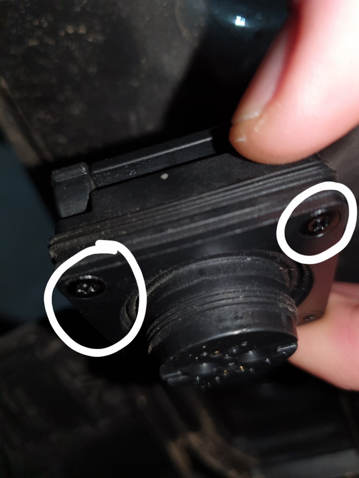

Hi
Had the same issue, have a Turbo levo 2022 expert
The plug is not making a great connection
The housing that the plug fits into has what seems to be some kind of seal
Shaved some of this seal off and works fine now

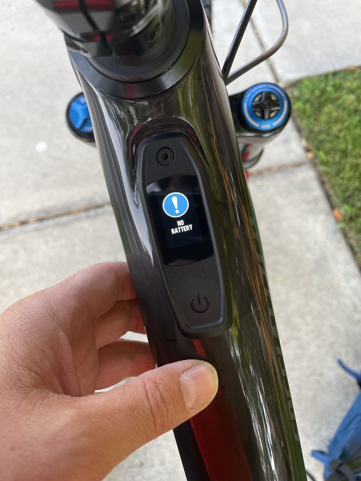

This is what I posted in June:
I bought a 2022 Turbo Levo Pro a couple weeks ago. Sweet ride. Plugged in charger, which showed charging. Shortly afterward I tried to turn on at TCU, but display would quickly show "No Battery" and then turn off. Bike would not power up.
Took main battery out and put back in several times with no success. Took to LBS. They swapped out for another TCU and same indication. They communicated with Specialized headquarters for awhile. Finally cleaned battery charging port and problem went away.
So suspicion is that a metallic particle got on the port area and was shorting out some part of it. That port appears to be magnetized, so I could see where it would 'attract' particles.
So moral of the story, keep charging port clean and even clean the charger plug before inserting. Also disappointed that TCU would not power up using its own coin cell battery(?) and could show some diagnosis, including possibly with "Mission Control" app

I was having the same problem as a few of you. MiTurboComp(carbon) wouldn't charge (no lights) then would but TCU2 wouldn't stay on and the message came on to check Mission Control app. Ha.
Followed the advice on cleaning all charging connections with a brush and micro towel and voila'. Problem solved.
