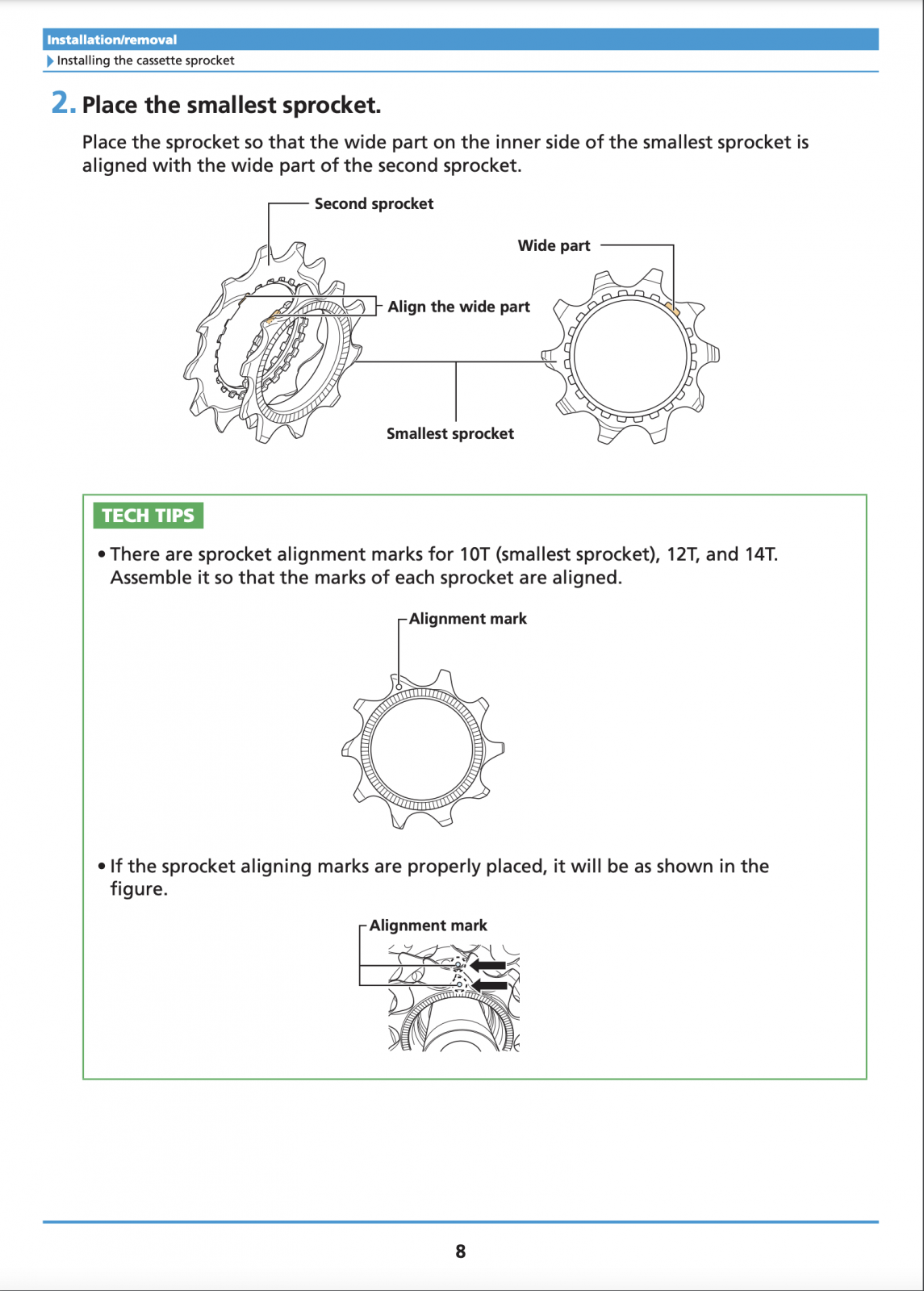

That said, you did mention cassette and wheel changes, so I'd also check if the clocking of the loose 12T and 10T cogs are correct. It is entirely possible to get that wrong with the smaller "teeth" of the Microspline, and have the cogs slightly tilted relative to the rest of the cassette. Just taking the wheel off the bike and spinning the cassette on the freewheel while inspecting it edge-on will tell you.

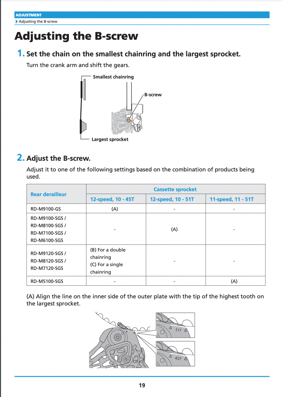

Of course, this is all assuming the hanger is aligned, and the B-tension and H-L are all properly adjusted.

Yes, I am very aware of the microspline alignment possibilities on the 12t and 10t. It is easily misaligned, but I'm 100% sure it is correct. I did the visual spin test as you described to confirm.
Hanger is aligned and B-screw is properly set, as well and H-L.
